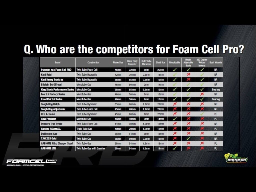

Maybe of some use regarding shockers
I don't think that the IM shocker they are listing here is the one we are talking about. That sounds like the new one I saw this weekend. Completely different unit. Typically we are debating the standard white bodied foam cell ones. These listed here are the newer gunmetal grey units that are rebuild able. Those dimensions simply don't match the set I have here on the shelf. The EFS units dwarf them in every respect. The new grey ones though are very similar. Didn't get a price on them at the time. Didn't get chance to chat on the stand really, but you know the ones I mean Tommy. Let's compare like with like.

Re: Ironman kit, I will check which shocks I have been quoted on (Foam Cell or Foam Cell Pro), but if it's the latter then they would appear very good value based on the table above!
