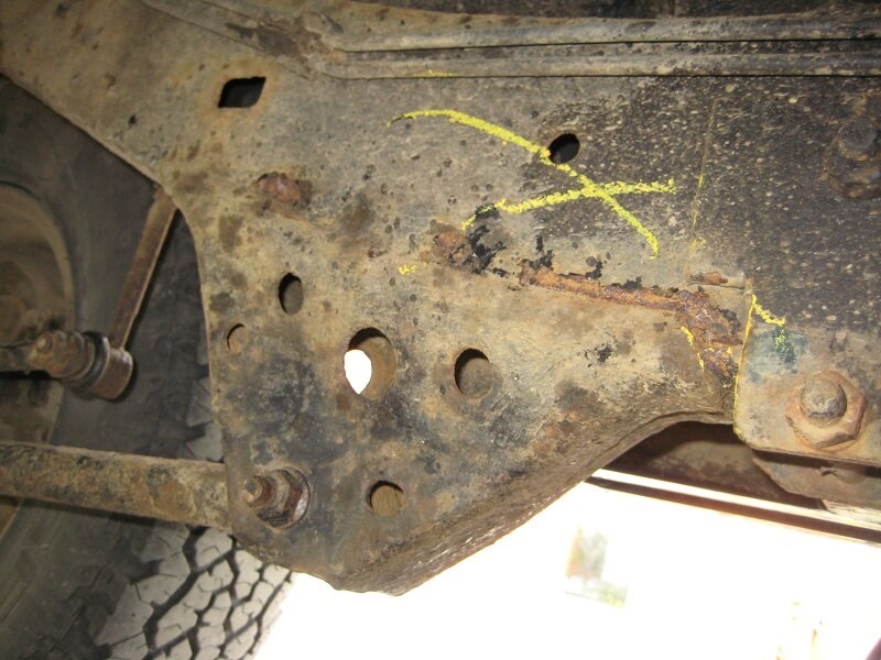

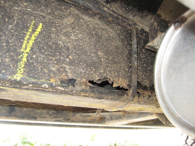

MOT fail today on bad rust on chassis rails. can't believe i didnt spot this when changing exhaust the other week
suspect the hole is corrosion from inside to out on the offside..
garage is going to weld a plate on and retest in a weeks time
nearside
[attachment=1:hjorogyt]IMG_3701.JPG[/attachment:hjorogyt]
offside
[attachment=0:hjorogyt]IMG_3702.JPG[/attachment:hjorogyt]
very embarassing... i cleaned up these rails, wirebrushed and painted them in summer...

Holy Crapolorado Batman. I have NEVER seen a cruiser looking like that. Not been launching boats have you? Wonder if that has rusted from the inside out.
winter roads in scotland, and being a skiier heading out a lot on wet salty roads hasn't helped....
i have never launched boats with it, but the colorado was 9yrs old when i got it, so who knows in past... it only got a towbar fitted when 6yrs old though
as i have receipts for that
going to be spraying stuff in the chassis rails now to try and stop it happening again and elsewhere
even Bob's (edinburgh) colorado didnt have bad chassis rust like this, although it did elsewhere on back axle etc
Jeekers, thats some tinworm!
It must be salt, because the roads here in Ireland aren't salted (potholed instead) and my 1997 chassis looks like a new one compared to that.
:shock: Ouch - bad cancer, that, Andy - sorry to see it. :cry: But it's given me impetus to do some work on the 120s chassis now ... ;)
Hope you get it sorted ok soon ... :thumbup:
been out and took the sliders off so the garage can get in their for repairs next week
definitely looks like rust from inside. there is a low point in chassis rail here, one side (nearside) seems to have a threaded hole and possibly captive nut inside chassis rail, which would not help with water getting out - silly design
why would there be a nut on inside of bottom of chassis rail there!
the other side had a hole blocked by a small stone... not sure if that has a captive nut too
no sign of any weakness/holes when i fitted sliders about a year ago...
so make sure those drainage holes arent blocked....
driving through fords hasnt helped...
