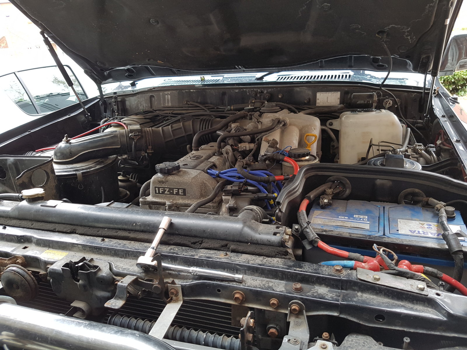

Not updated much recently but not much new. Kaymar needs bolting on when weather improves, going to source a right side battery tray etc and wire in a split charge/leisure battery. Have some extra goodies to wire in too while in there.

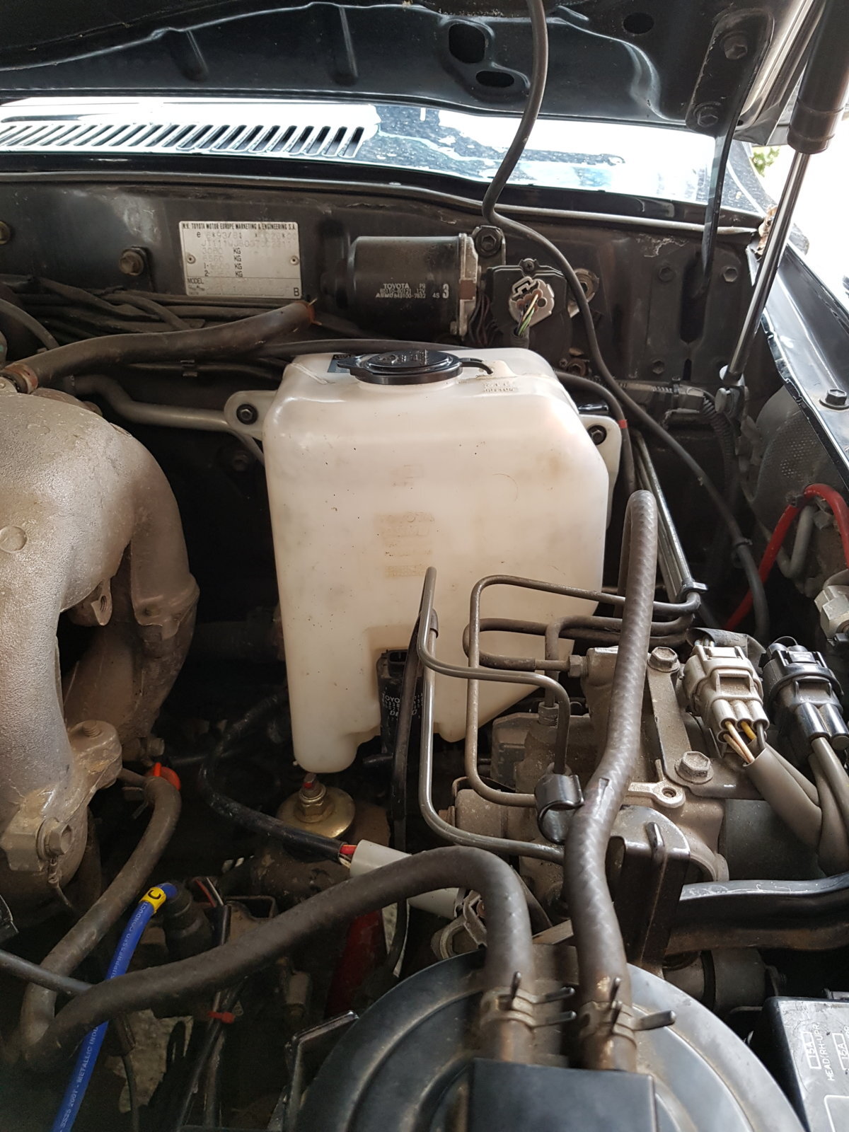

Got the washer bottle re housed today, moved from behind the right headlamp to make way for a 2nd battery.
Made a couple of brackets, extended the wiring and washer pipe for headlamp washers.
There's a new fuse box in the boot now and a nice big power cable running front to back. Will get some pics of it all when everything is put back in
