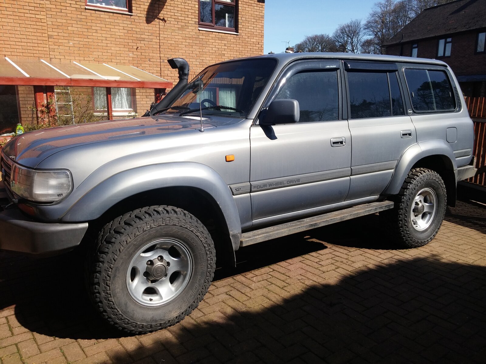

Been doing a little bit of baselining up till now, replacing dash bulbs and fitting an OEM cup holder in that irritating slot above the radio that I'd kept from my last 80 :)
Anyway - this lot arrived today. Pup was looking for a roo but she was disappointed :)
I think the steering damper alone is bigger than the OEM shocks !!
More to follow as I go to fetch another parcel shortly!!

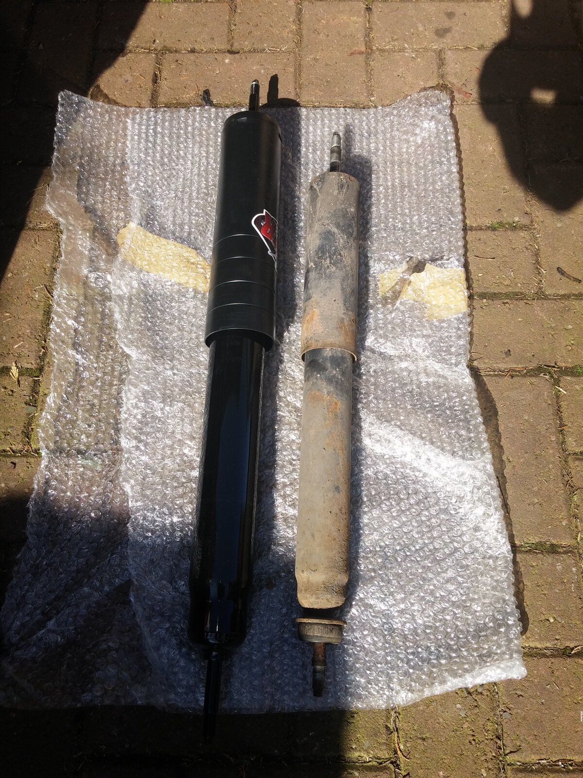

Anyway started at the back. The existing rear driver side shock was totally knackered and doesn't even self extend. Glad I'm doing this.
Old vs New shocks

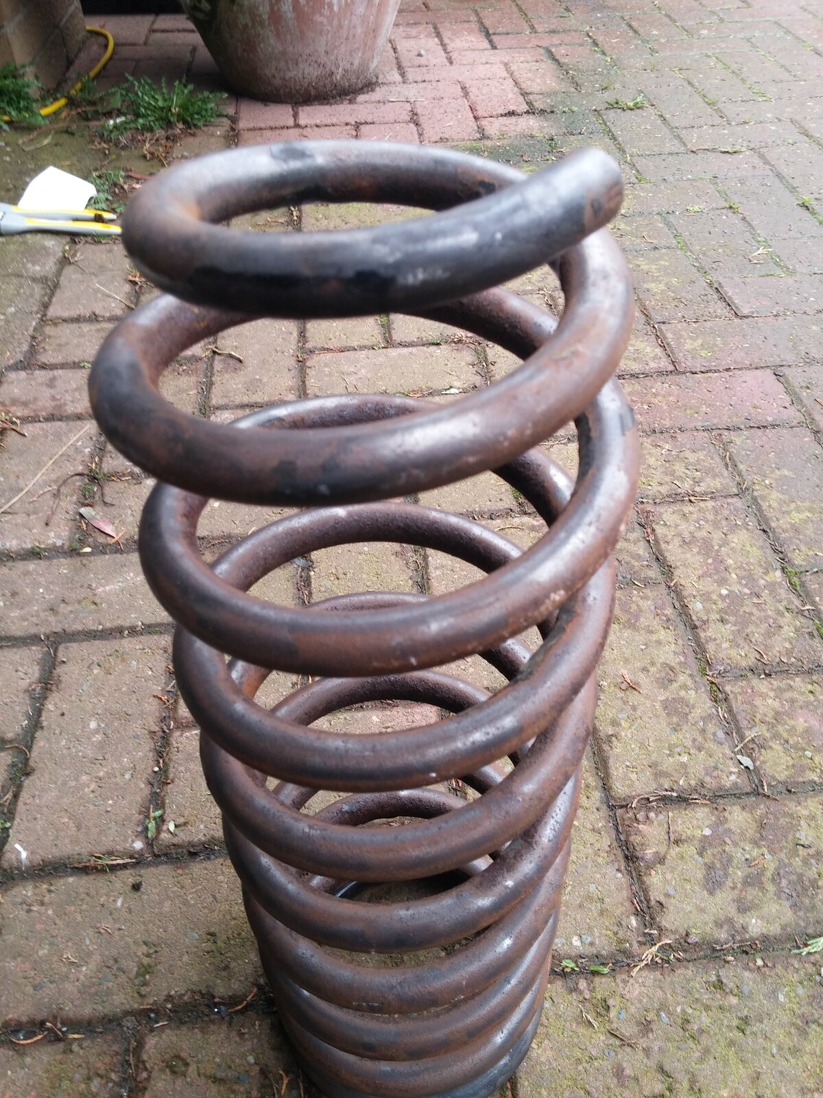

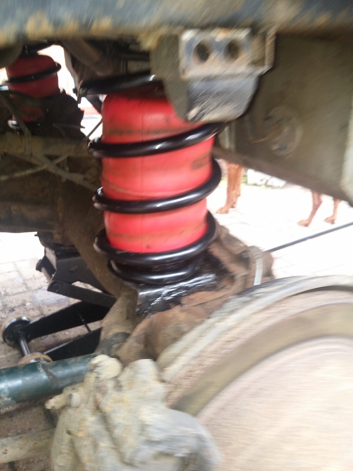

Key question. My 80 came with air helper springs (thanks Jon!!) but how do you get the buggers out the old springs??? I've struggled for bloody ages but they won't collapse enough to slip back out the spring. Help!!

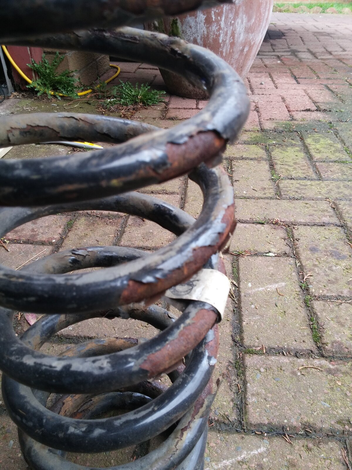

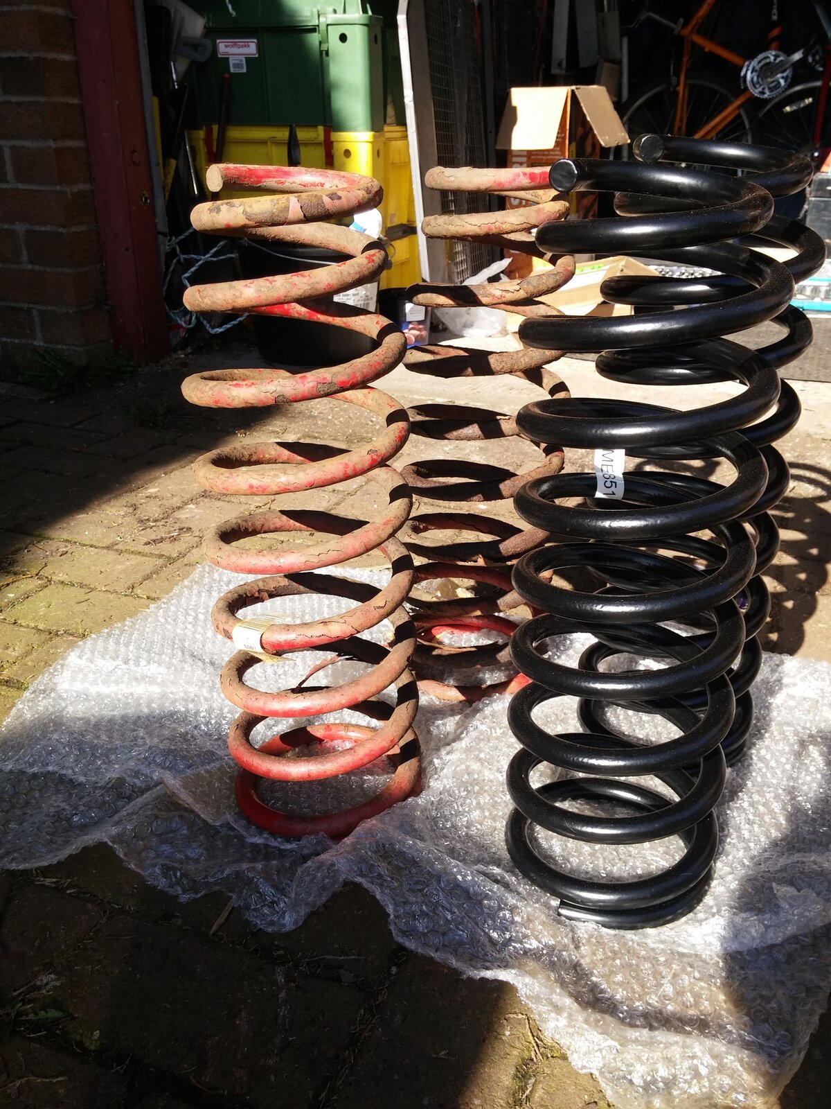

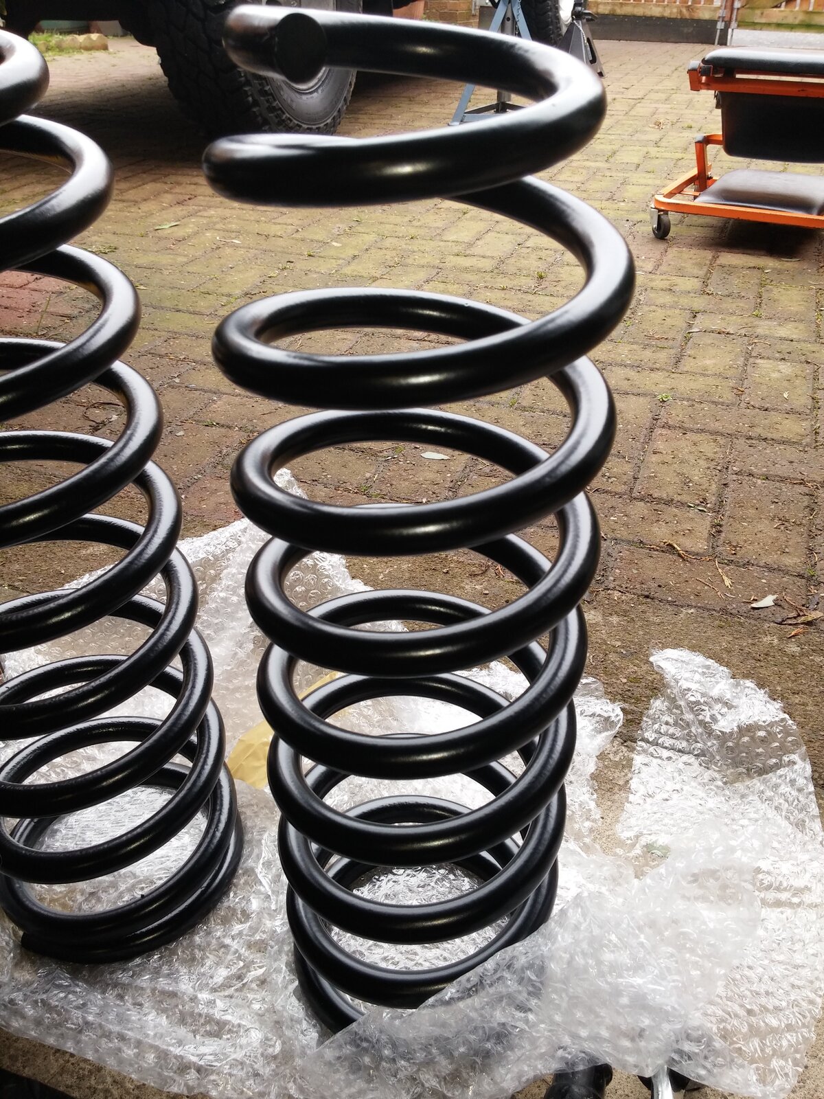

Refurbished the front OME851 springs that Jon gave me:
Before:
During:
Done:
The new OME863s appear to be the same height as the old ones but not as thick steel. Hope they're not too light duty. Time will tell ;)

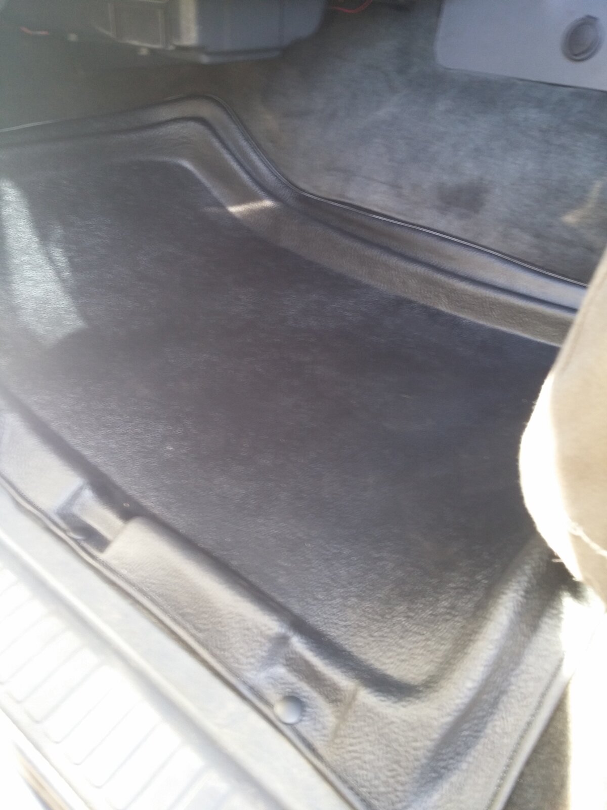

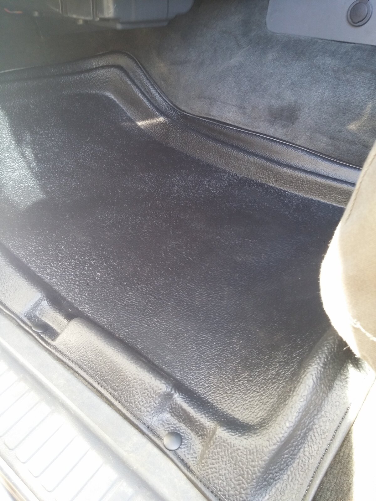

So in disgust I decided to fit the SandGrabba mats. Quality stuff, fit like a glove and look damn good. Photos to follow.

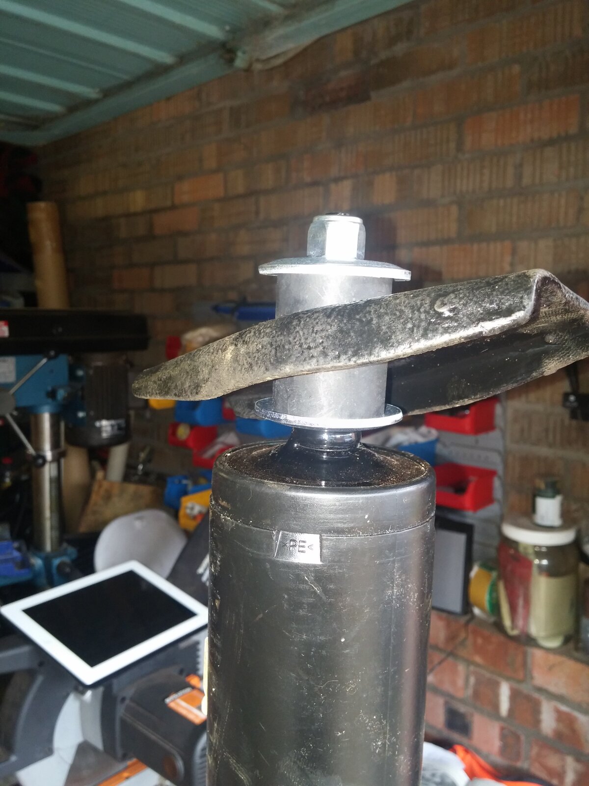

Oh and another question - how do you bolt the top plate to the rear shock top pin properly without damaging anything??
I just assembled mine and the flats on the shock pin stop it turning against the plate. Think I might have held the plate in a Workmate with some bolts through the holes.
Held the bottom eye on the vice all carefully wrapped and managed to get the 60-something torques needed :)

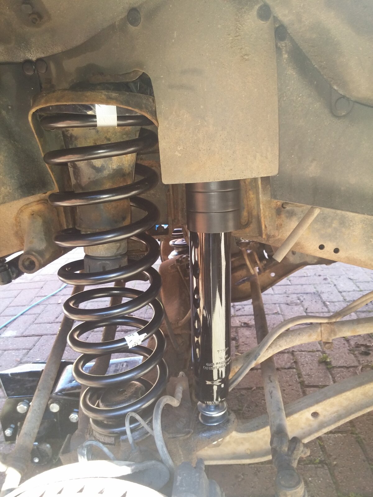

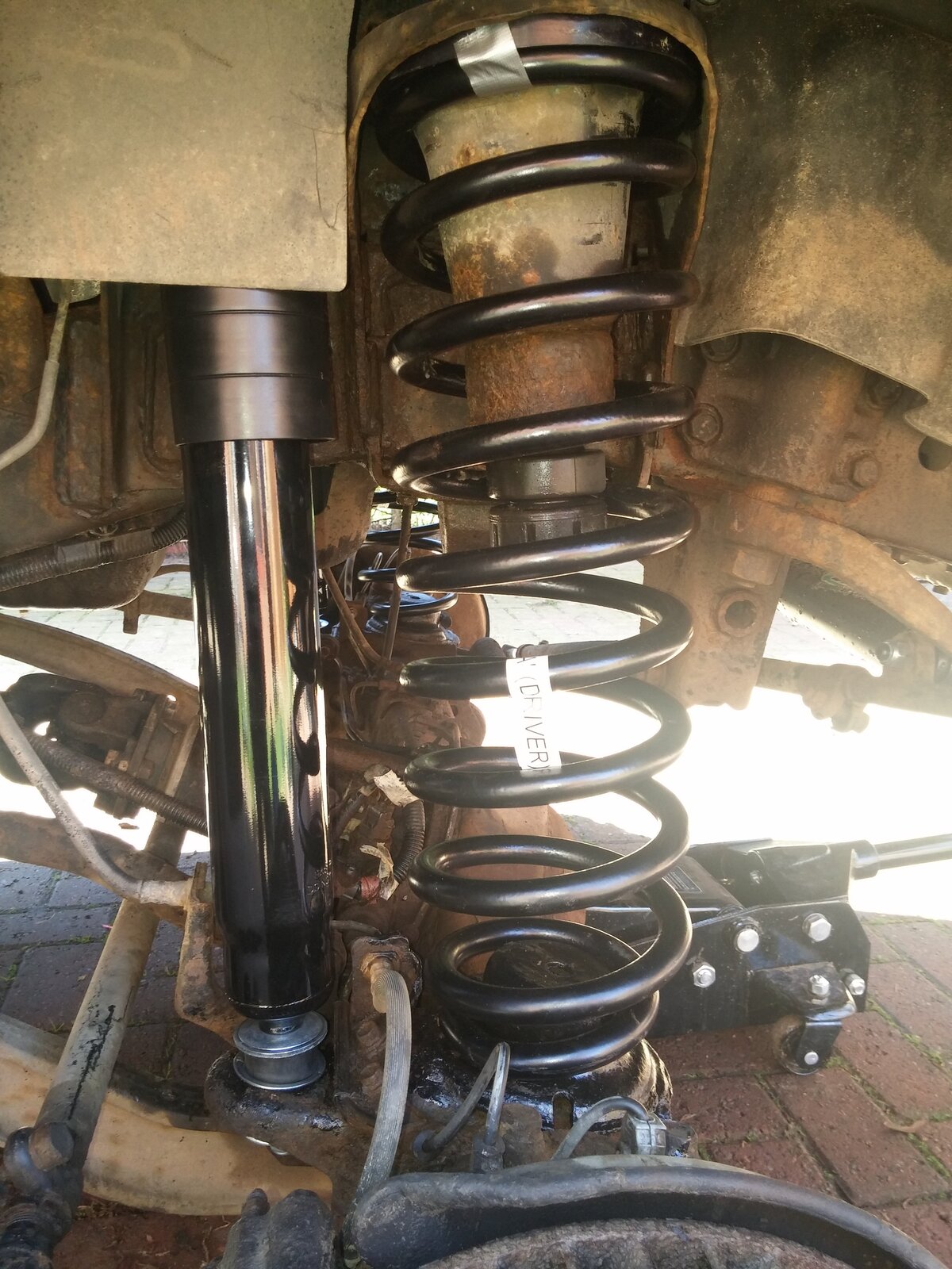

Back suspension now complete:
Picked up a 40mm lift both sides so that's ok.

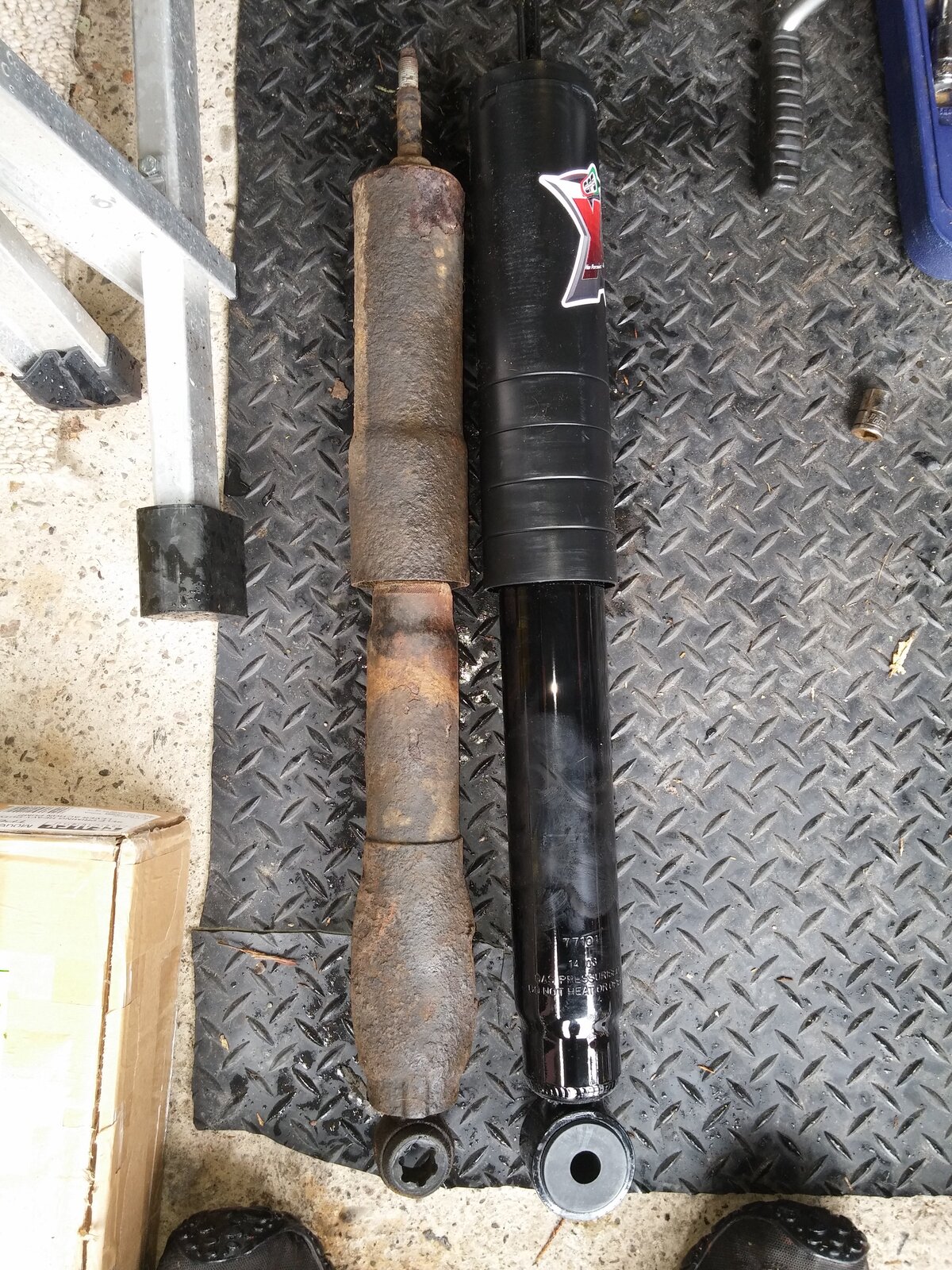

Front shocks also out - the right one also totally screwed and not extending. Wonder what happened there.
Complete. 45mm lift achieved in the front so I'm happy with that.
Pedders754 (?) came out and OME851 go in.
Old shocks (one not working and one barely working) next to new - both fully extended
Shocks and springs in place after a city of tidy up with the wire wheel
Wheels all rotated and back on. Looks a lot more balanced now
A previous picture for comparison
SandGrabba mats

How does it drive now?
Drives beaut now. And although not gone far there isn't any noticeable steering wander either but I've yet to get to a motorway. Took it down my little back of beyond track and it's a lot better than it was - which was still better than stock as Jon had already upped the springs a bit. Having working shocks all round has also cured the vague steering as has a new steering damper.

I thought the sand grabber matts we're going to be like maxtrax ;)
Looks great.
Like the mats, look to fit really well.
