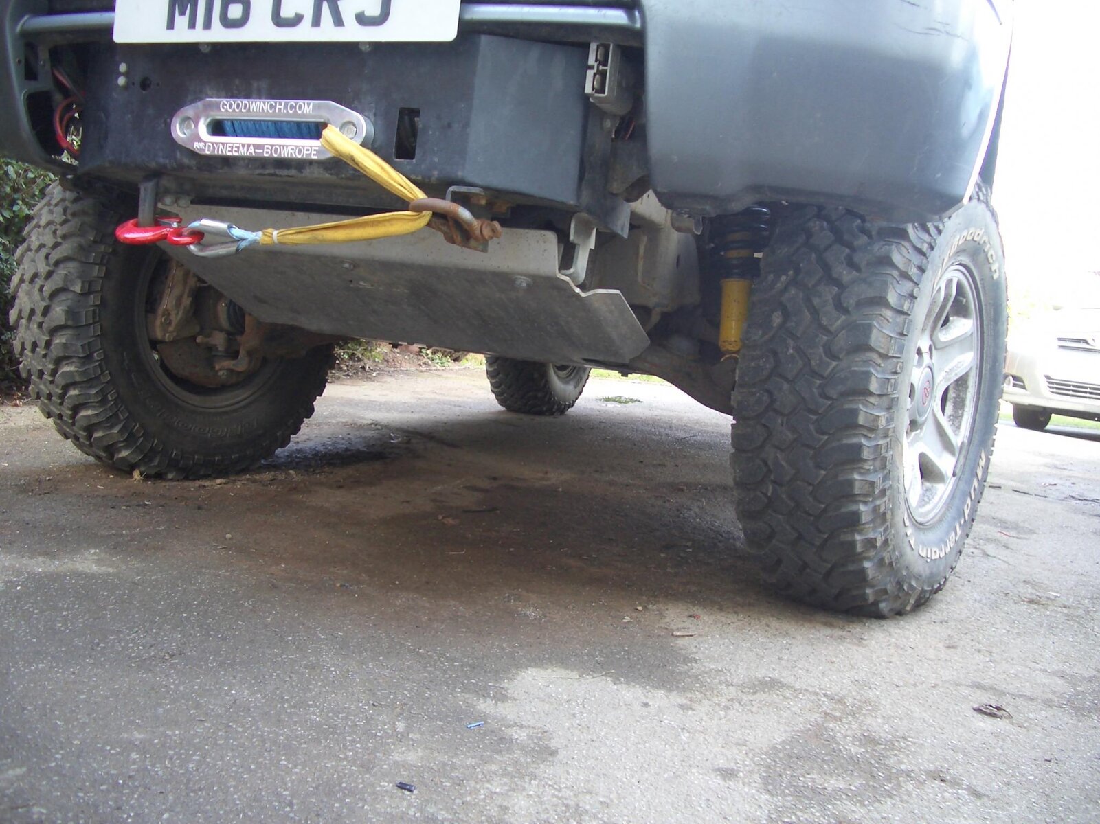

I didn't have a chance to have a route under the truck before going out this morning, but looking at the HQ version of the photo you picked out Roger I couldn't see any crack in the spring seat or the welds. It then occurred to me that it may be an April fool joke, but clearly not :lol: Would have been a good one though :icon-biggrin: :icon-wink:
She is pretty tatty underneath, but it's all surface with nowt structural or to be concerned about, shes only just had an MOT that lasts 13months. I used to be worried about the condition of the back axle when I first bought her as it is very scabby, but again its as thick as Rhino skin underneath. She doesn't live by the sea, but she's had a hard life over the last couple of years having fun with me and the kids and is 16 years old with 170000miles under her belt! I'd like to see how much body work and welding a LR of similar age and mileage would have had by now :lol:

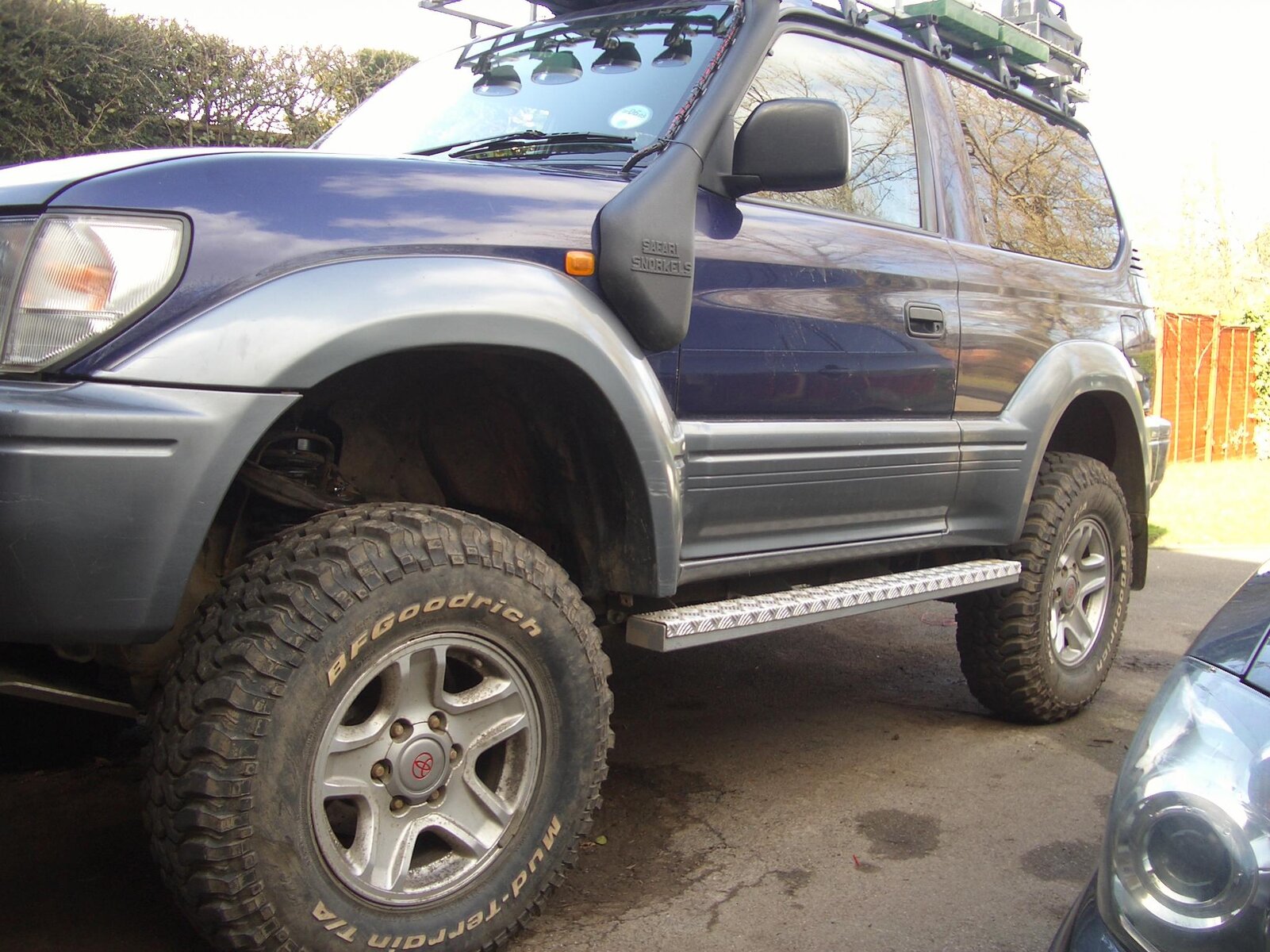

My truck has the IM suspension lift (B I think) and also has 30mm bodylift spacers. With no load:
Front 360mm
Rear 370mm
