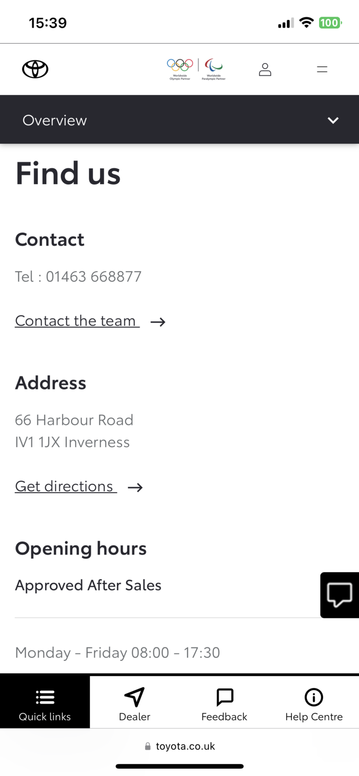

How about Parks Toyota Inverness?
Im waiting for parks toyota reply!!
