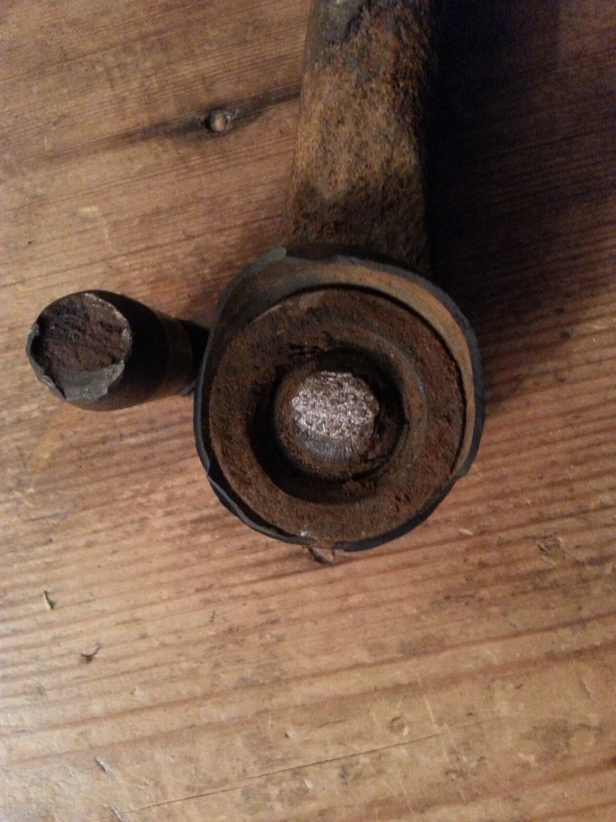

Jumped in the motor to get some beer, started turning round at the bottom of the street. Then the horrible prang sound of steel snapping..
Pitman arm ball joint had snapped. Could of been really nasty at 60..
I replaced the ball joint about three years ago, because of time, against my better judgement i fitted a roughtrax number...
These wear out and need replacing, but shouldnt snap, this could of been nasty.
So stick with toyota, and beer is good for your health..

Exactly the same thing happened to me Mike, it sheared of on the taper, flush with the pitman arm.
I concluded that the ball joint must have progressively seized, and thus over stressed the taper pin.
You could see from the fracture that it had happened over time.
Mine failed reversing in the garden, what disaster may have occurred at speed is better not to think about TBH.
Glad you're all safe anyway, the repair is easy.

See pictures below frank..
Its funny isnt clive how lady luck sometimes smiles upon us.
The joint is completely dry, although not completly seized i could move it one way with a lot of pressure from my thumb.
As i mentioned, i replaced this about three years ago. The oem joint that had developed play was original, about 220000 miles on it and still full of grease..
Not just a roughtrax issue.Previously replaced all the ball joints with 'made in japan' items from Milner.Noticeable unwelcome play in 3 out of the four within a year. Straight to the bin with them, OE jobies been in the last 3 years, no more worries.Dave.
Thanks for the pics CG. Surprised it passed last MOT as it appears to have been dry for some time. It looks like it's been cracked for some time.

Of course, the tendency on maintenance checks is to test for play with a breaker bar. However, this test goes nowhere when a ball joint is seized almost solid. Imagine the stress on that pin with the full power of power steering on one side and the weight of cruiser wheels with a payload of some 3 tonnes at speed, on the other.
Yes, Lady Luck has been good to us, the thought of traveling at 100kph with a detached steering wheel in hand, is scary to say the least. IME, these trucks need to be steered all the time, especially under heavy breaking.
If you look at the angle of the first crack it looks like it's an impact crack i.e. at right angles to the steering arm. I would think the impact stresses on the joint are much greater off road than on. Twisting stresses too.
If you do a lot of off road the stress with a free joint bends it back and forth in line with the tube and it will break sooner or later. Sooner with a cheap joint.

P.S. The joint on the other end of the tube must take an identical force assuming neither are seized.
Mine has just clocked 242,000 miles/21 years, (note Mike's 220,000 mile comment on an OE part) nothing in the history about replacements, it may be there somewhere though? As my policy is to now replace with OE or better I have decided on the complete drag link in Chromoly, heavy duty ends which are greasable. I have been told I am wasting my money on a tough link as it moves potential damage elsewhere which is true but I hope not to hit anything hard enough to find out. I also get trade and the CM/HD drag link should work out about the same as retail on a stock unit,

A few months after the failure, I had the main steering box shaft to the pitman arm shear off! I still think there might have been a connection, the extra stress trying to move a seized ball joint for who knows how long. Surprisingly, I never noticed any untoward stiffness in the steering, until the new joints were fitted that is.
