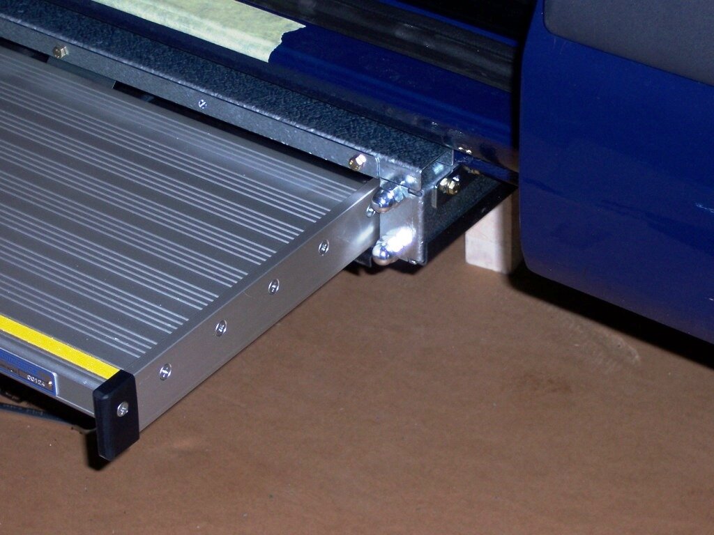

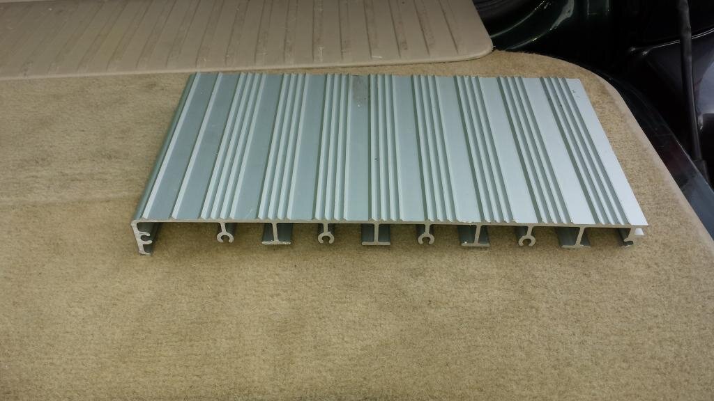

they get an alloy runner screwed to the side - so need to be precise so that no gap shows. eg

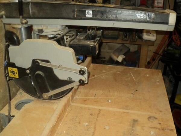

We tried a table saw but you can't get it pushed through the blade without catching - hence we are now trying to keep the ally held in position and pass the blade through it with the radial saw. We have a proper aluminium fine toothed blade but it still needs loads of cleaning up after cutting - although we can get it square now.

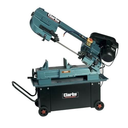

Pretty sure my relatively cheap and cheerful Clark band saw with fine blade and arm weight backed right off would cut that and give clean results. You just need to get the cut light enough or fine enough blade not to snag. I've cut a fair bit with it but nothing quite as prone to snagging as that profile.

yes it's a pain. This is what we're using now

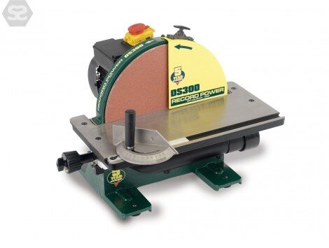

I'll try getting something like this to square it up - mebbe not as grand as that might be

I'm talking about one of these (gone up a bit since I got mine): http://www.machinemart.co.uk/shop/product/details/cbs45md-41-2in-x-6in-metal-cutting-ban get some 24 tpi blades and screw the weight adjustment all the way in. If it does snag the blade will stick and it will stop cutting till you relieve it but it doesn't damage what you are cutting just gets annoying. I also have a Dewalt DW872 which I'd expect to cut it ok but not as tidy as the band saw.

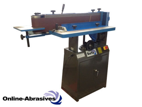

That's the thing for truing it up - but Wadkin - that's serious money. Plus we haven't got 3 phase and the installation costs are large - plus the landlord won't pay so we'd have to move units. ah well - thanks for the suggestioins - the bandsaw looks like an option if the dewalt doesn't work out.
Anyone got any experience with these - bearing in mind we have tread at 250mm and 300mm so the wider tread would be right up to the stated capacity limit of the saw
  • Cutting capacities at 90° - 180mm dia. tube & 180x300mm box
