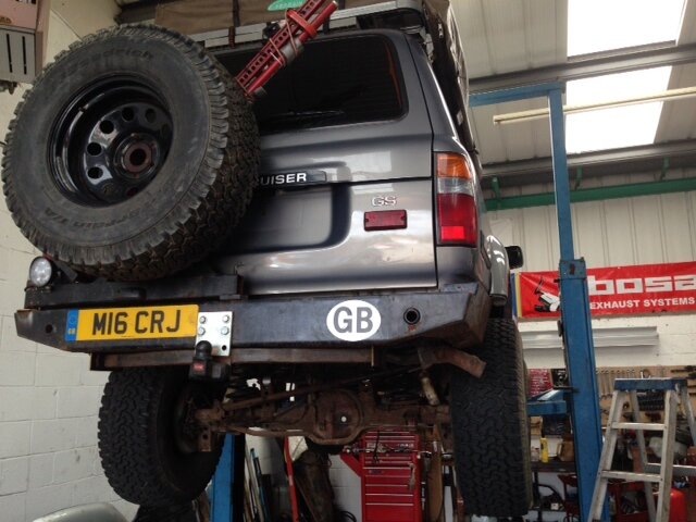

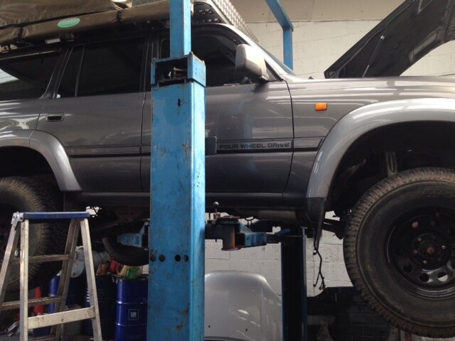

Well that didn't go quite according to plan. Dropped in this morning just as they were finishing off. I went to get some cash and they rang me to say come test drive it. I jumped in and the clutch just went straight to the floor. I looked at them and said that's not right. They said we were worried you might say that. But as we hadn't driven it before we didn't know what it was like before the new one went in. It was dreadful, Stiff until halfway then it went to the floor, then the pedal didn't come back up again. Foot down in third and the clutch just slipped. It made a terrible creaking and clicking noise too. The old clutch was totally pooped by the way and was running on the rivets. Pilot bearing and release bearing were awful so it's good that they came out.
In an hour, they had it back out. I couldn't believe it. Compared to the genuine clutch the pressure plate spring (fingers) were thin and weak and also flat where the genuine ones were contoured. It said Valeo on the cover and plate but Valeo Korea, not France. I have an Exceedy one coming tomorrow that they will slot in double quick hopefully, but it's going to cost me in labour I know it. Thing is that if I had done this myself on the drive, I would have used this clutch and would now be looking at pulling it out again myself. So I guess it's the best of a bad job. So despite some people having no problems with them in the past, I would say a big no to Milner 80 series clutches. I should still make France. But I really hadn't expected this.
