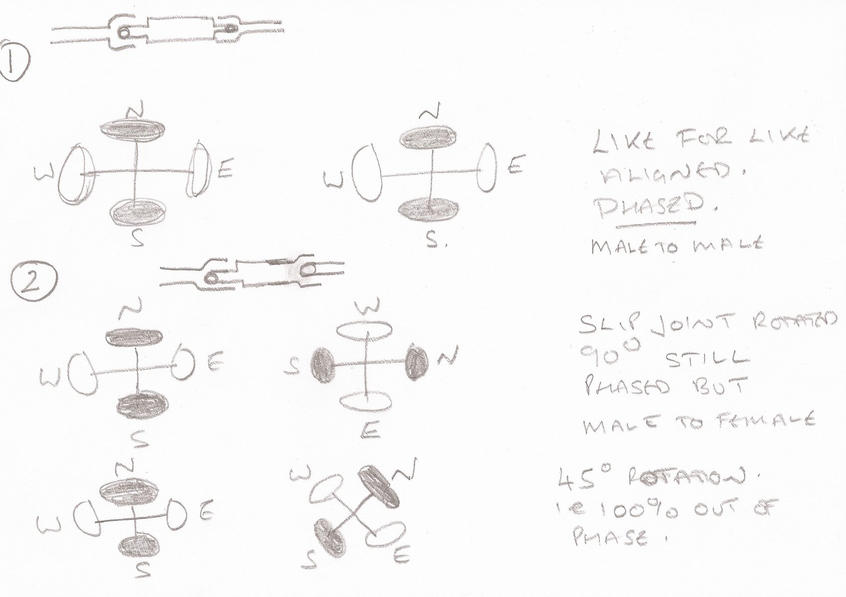

Finally, got the prop back into phase. After days of twatting around, I pulled the front prop from the green one and measured the angles of off set on the splines and put the manual prop back together. Each of the splines = 18 degrees by the way folks so you can only set the yoke on the splines at those intervals. This morning I started with the props phased at what I'd call zero. In other words the two inner yokes (the ones on the inner ends of the shaft) lined up. The outer diff ends of course are then lined up too but 90 degrees rotated. It didn't like that at all. I tried it then by turning the whole splined section by 90 degrees so that the UJs were still lined up, but instead of the two inner bearing caps being aligned, I had on inner and one outer lined up. Oddly this felt better. I can only assume that this is something to do with prop angle rather than UJ phasing. Anyway. It was then that I copied the green prop by taking it off. I had tried to do it under the vehicle in the past but clearly I wasn't on the money. As soon as I set off, I could feel the difference. Smoother, more power, less noise. Now would I say it was perfect? No, but I have had it up to motorway speed and it's fine. I guess I am just battling so many variables. I could have just put some boxes in the boot, a duvet and a stove and accomplished the same sort of trips with no fuss or expense. Yeah, I COULD have. Nah.
