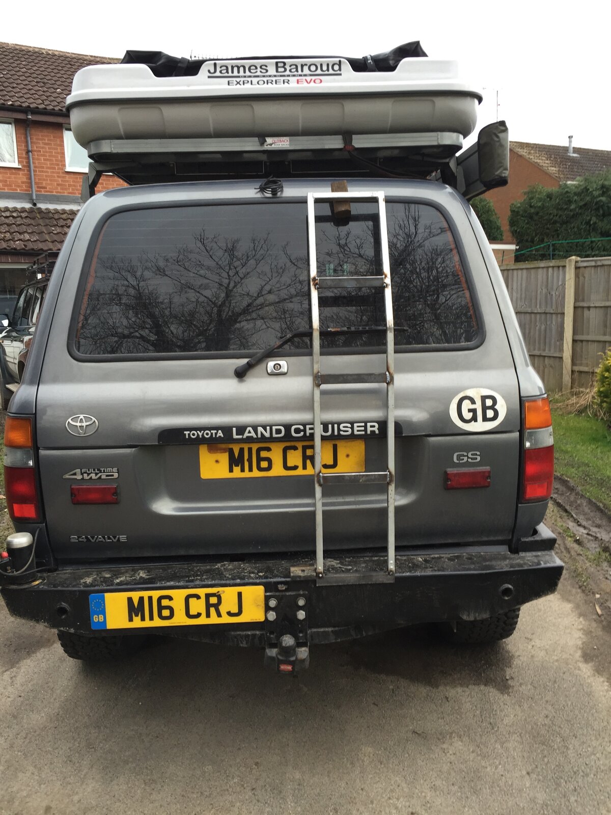

Well had a prop free day today. Lovely. Been messing with roof tent, ladders and such and started making a rear ladder.

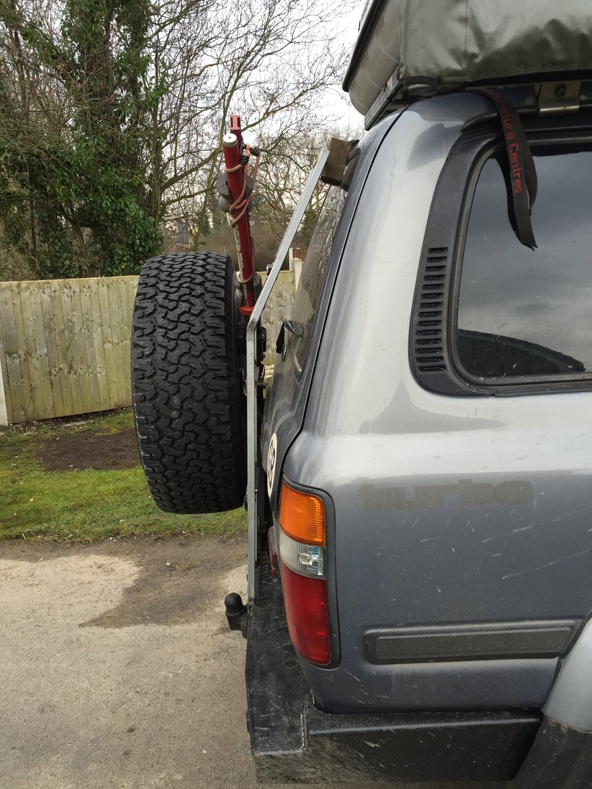

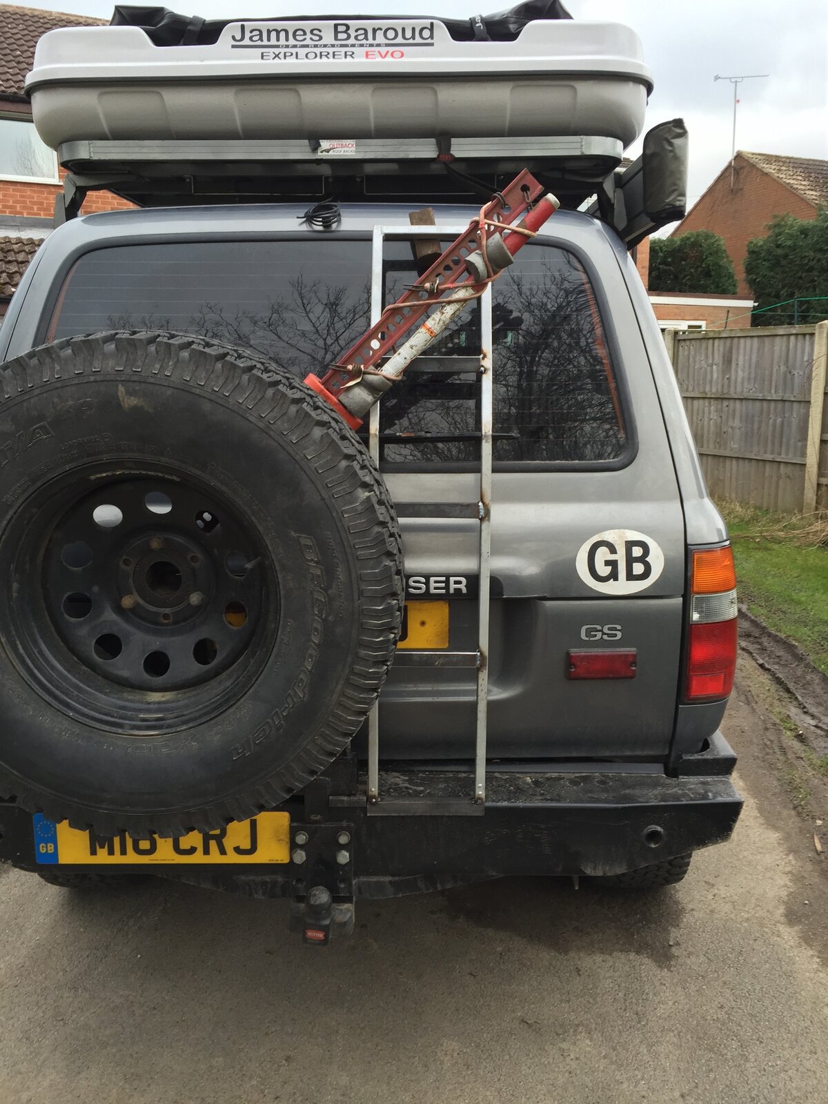

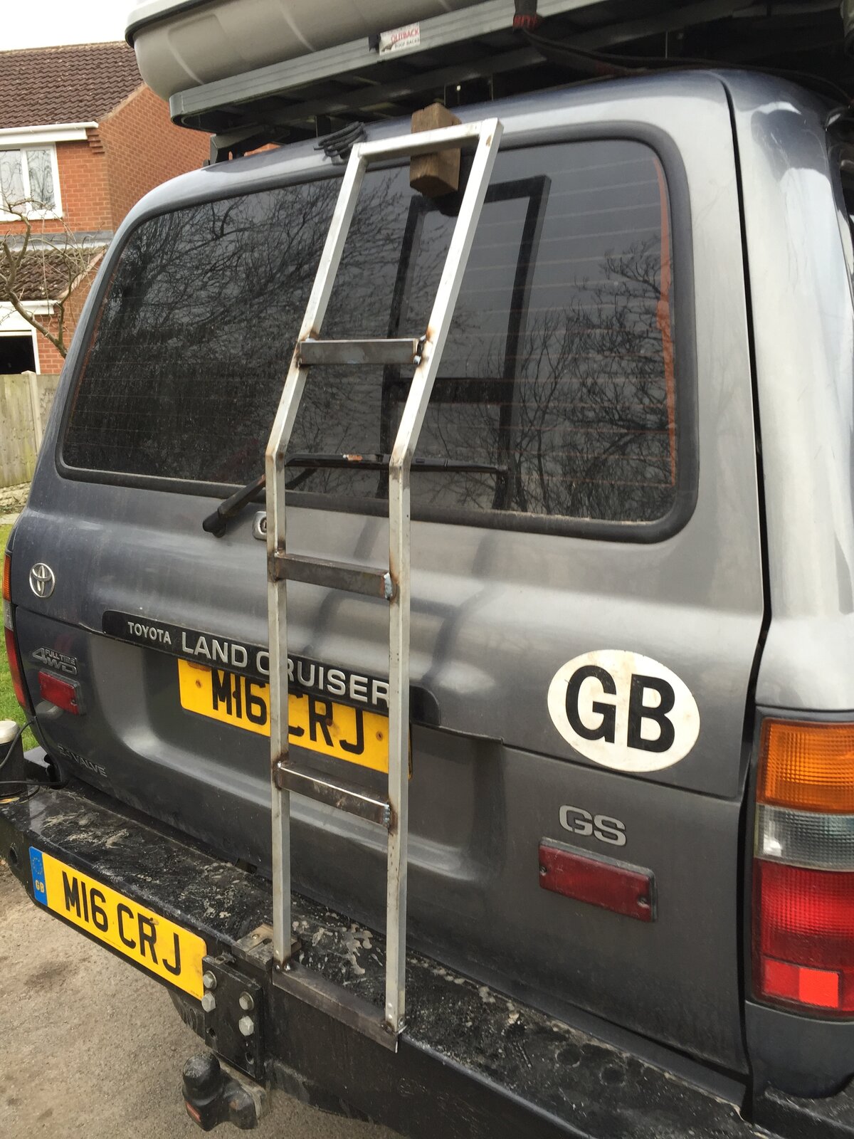

I'd love it to have been round tube and all wiggly and made from ally but you can't have everything. It looks horrid but I brushed it down later and sprayed it and it looks much better. I shall have it blasted and powder coated naturally once finished. I need to attach it to the top of the tailgate and the lower edge too. But the idea at the moment is to have maybe a sliding section at the bottom that locks so that I can drop the foot onto the bumper to take the weight when I climb it. If it touches all the time it will rub when the body and chassis flex.
The JB tent has a nice big rear door so getting in and out that way as well as getting things off the roof storage location will be much easier. Sorry folks the pictures came out mahoosive!
You're right Chris, it does look horrid :lol: I would have thought a man of your ingenuity and ability would have made a slide out, under-rack, self supporting, self cranking, auto-lock device, thingy, but no.... it's a ladder, plain and simple and I'm sure very effective :icon-biggrin:
What will you mount it to, the rack or the tailgate?

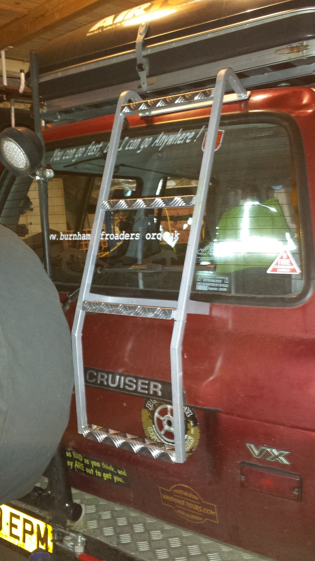

Your ladder is not too dissimilar from mine Chris, mine is only fixed to the upper tailgate and takes my weight very well. I think you are right to support it on the bumper though, I mean after all you are slightly, cough, larger than me. :eusa-whistle:
One thing worth considering, which I'm fairly sure you have, is weight of the ladder, mine is fairly well lifted by the tailgate struts, a little heavier might be a problem.

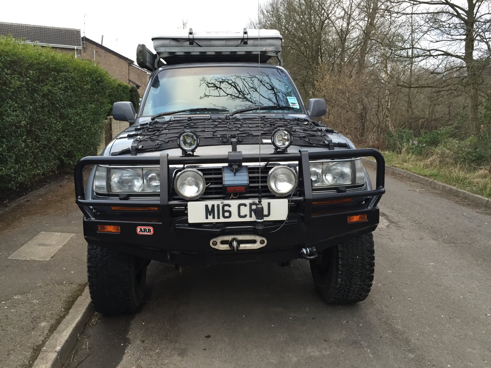

Yes, driven well all day. Even given it a wash and a clean out inside. Both tanks full and water too. Not dropped at all.
Looking quite nice
Just need a new CB mount to go on the tube. Can't really obscure the index plate like that

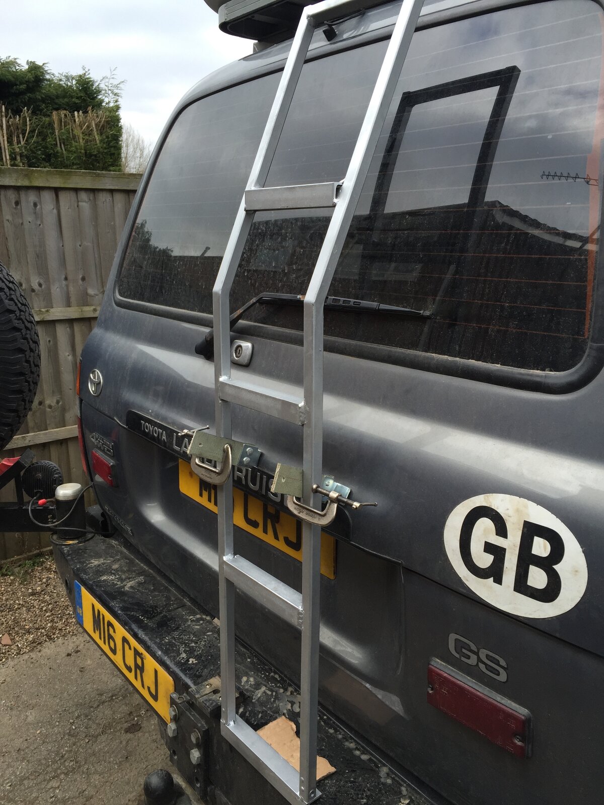

Put new bonnet struts on too. Followed you lot and got them from ebay for £20. Man they're good. I think I might do the rear ones as well. I have been messing with the new rear ladder but the door won't stay up.
But I'd like the ladder on there. I have come up with some flexible mounts so that it doesn't drag on the rear bumper when closed but drops slightly when I climb on it.
