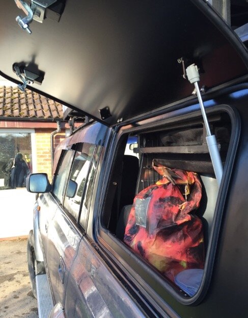

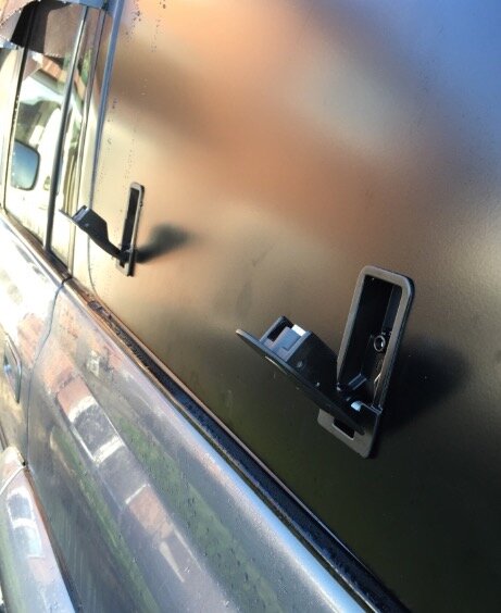

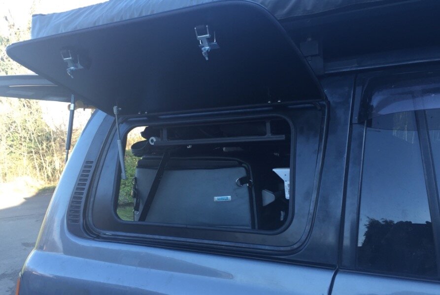

Thought for the sake of completeness, I'd better post a pic of my Cruiser Flaps on here. Don't want people missing out.
Screen Shot 2016-03-31 at 15.14.50.jpgScreen Shot 2016-03-31 at 15.14.04.jpgScreen Shot 2016-03-31 at 15.13.55.jpg
Looking very smart there Chris:clap:

Gullwings look ace Cris, beautifully made and a perfect fit. :thumbup:
