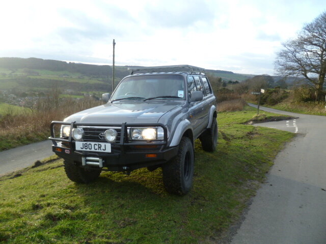

Sorry Chap. Not guilty. Been grey all over since i got it. Now actually I would like to change them - pure vanity. I like a bit of contrast. I never liked my white one that much, but Rob's is with with charcoal flares and it looks totally different. What made you think I had changed them?

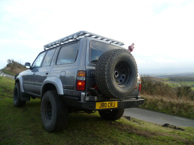

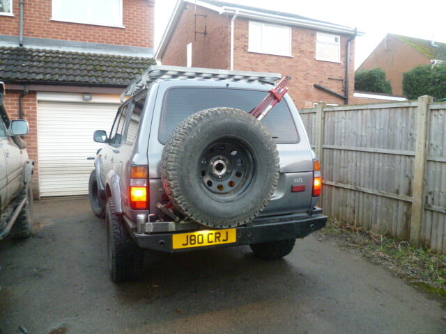

Gary - just a temp lash up. Do you always look on the web with a magnifying glass? Well spotted. I was fitting the bumper and got so hacked of with the rear silencer that, well, I hacked IT off. The pipe was then under the car and fumes were collecting in there so I found some old exhaust, cut a bend from it and rammed it onto the end of the pipe. Ultimately I shall have a system made up. But not til I have planned the slider-steps probably to determine the best route through.

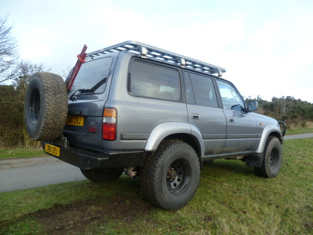

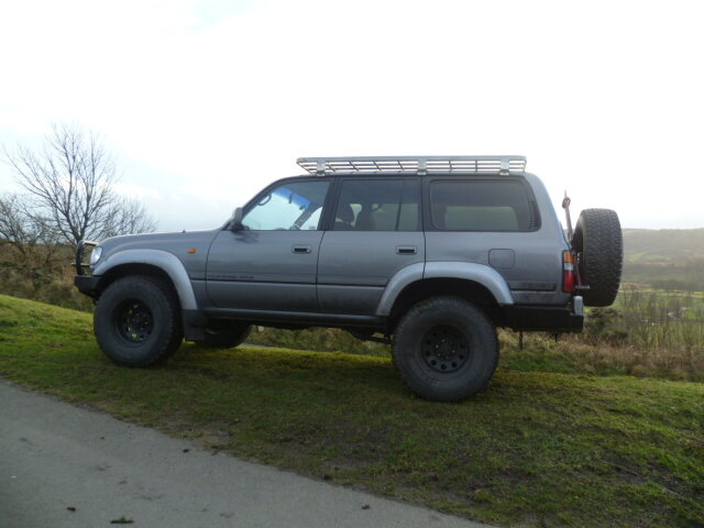

Not sure about these springs. They ride lovely, but as you can see in profile, with a full tank of fuel, drawers and not much else, it's not riding that high. Remember these are 35" ATs. I can put packers in as I have material standing by, but that's a bit of an artificial lift. I was wondering about some Slinky Springs. Or perhaps just good old Old Man Emu. I found those a bit harsh though. I am not buying any more Iron Man stuff. The ride is nice, I am just not sure that they stand up to being heavily loaded over time. Got the roof tent and aux tank to sit on the arse end yet and that's a lot of weight plus the front winch and sliders plus water tank blah blah.
