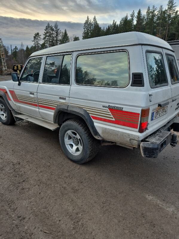

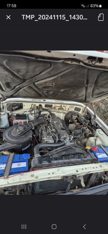

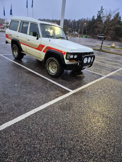

Hi all, British guy working in Sweden and i have just bought a 1990 FJ62 ( I Think ) she has the twin headlights and 5 forward gears,
A few things need sorting like steering wheel alignment, 4wd light is not lighting up and the oil pressure gauge is pinned to the H level, however I believe that these issues are common ?
Can any Swedish members recommend a specialist near the Gavle region ?

Looks like an HJ60 to me, does it have the 2H diesel engine?
I thought the FJ62 was the USA spec gasoline motor variant?
What does it say on the VIN plate on the firewall?

Yeah checked the VIN plate it’s HJ60 variant, watched a few YouTube videos and assumed because it has twin headlamps is a FJ62….
