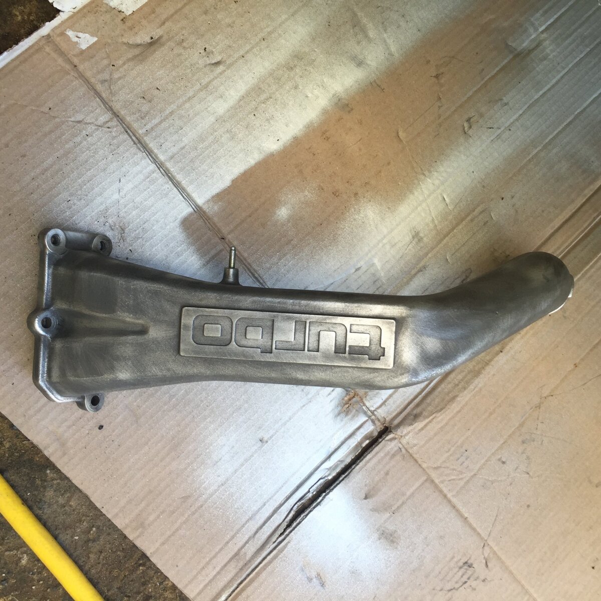

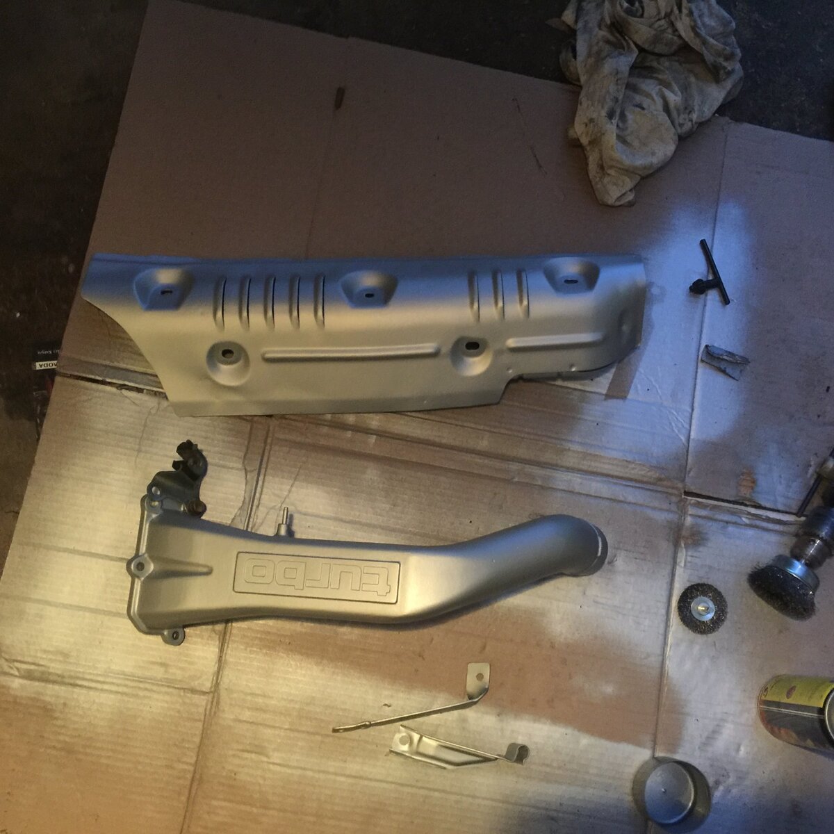

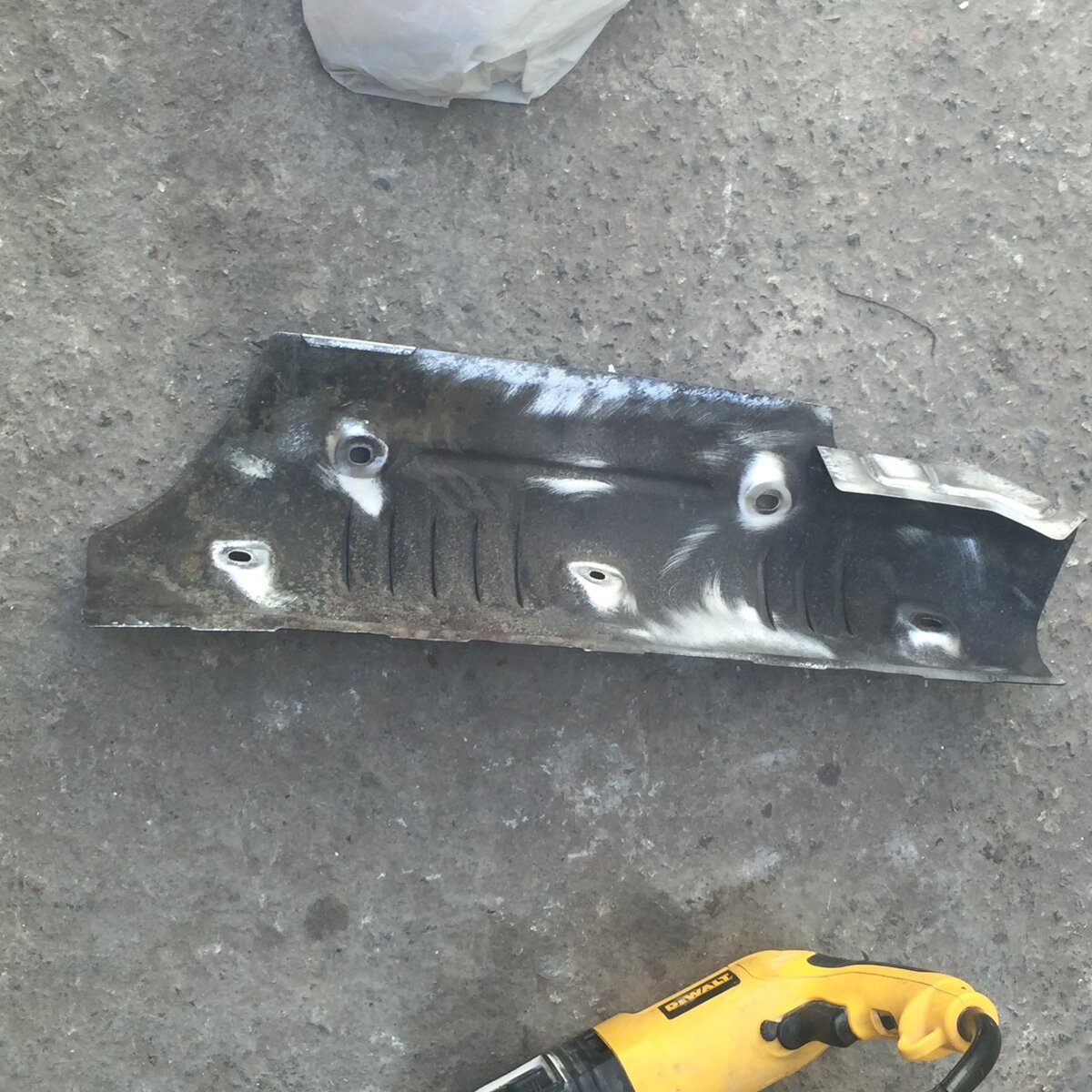

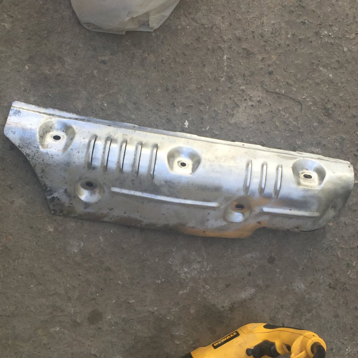

Sunday Workout stripping the manifold heat shield thats been 23 years of wear & tear. Stripped rust corrosion & debris with wire mesh in preparation for heat resistant paint.
Manifold heat shield painted.....left to dry for 30-60 mins before placing in the oven for 60 minutes at 200C to bake.
Decided to paint other bits as new with the old looked off. Happy with the results. Wish I did this before when the engine was being rebuilt.......would of been much easier. :dizzy:

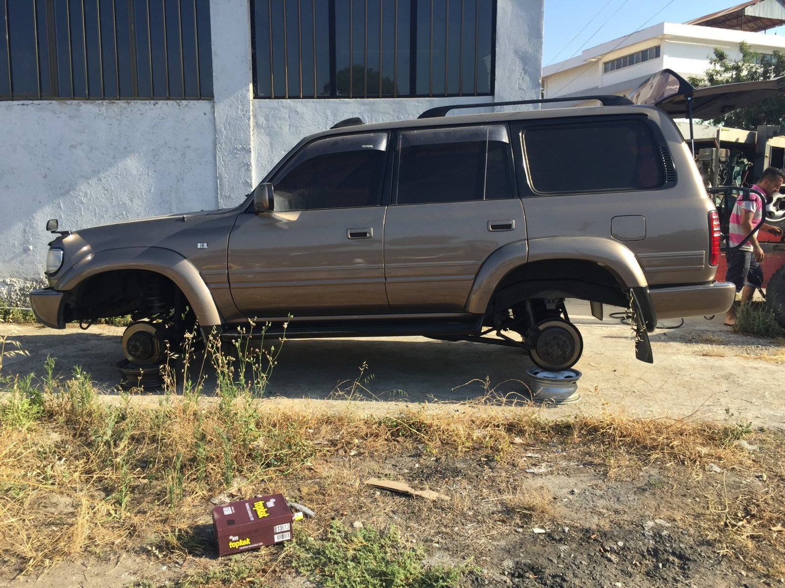

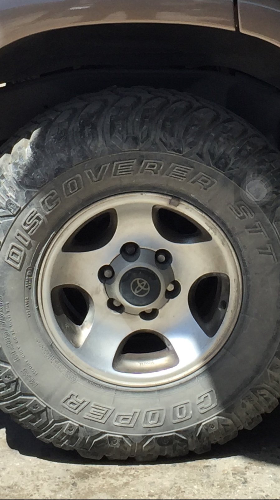

All five wheels off today hopefully tomorrow looking at prep work before repainting in new colours. :mask:

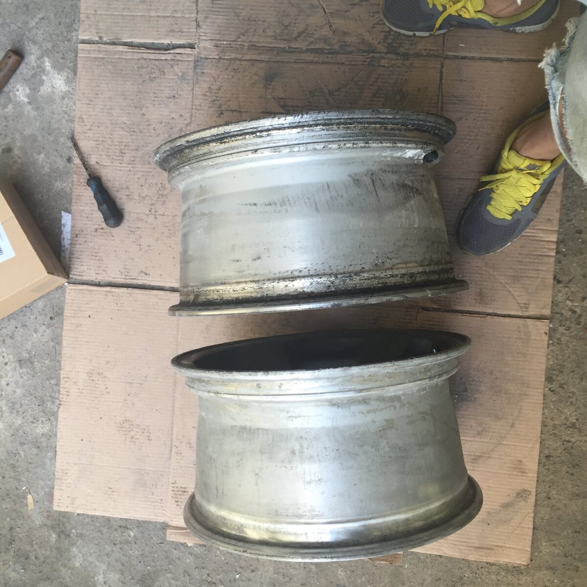

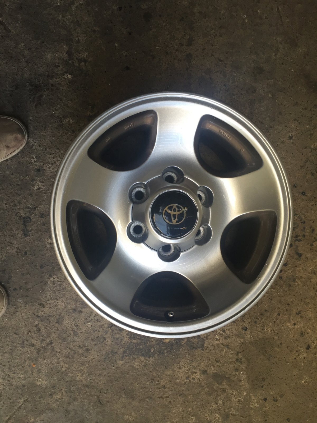

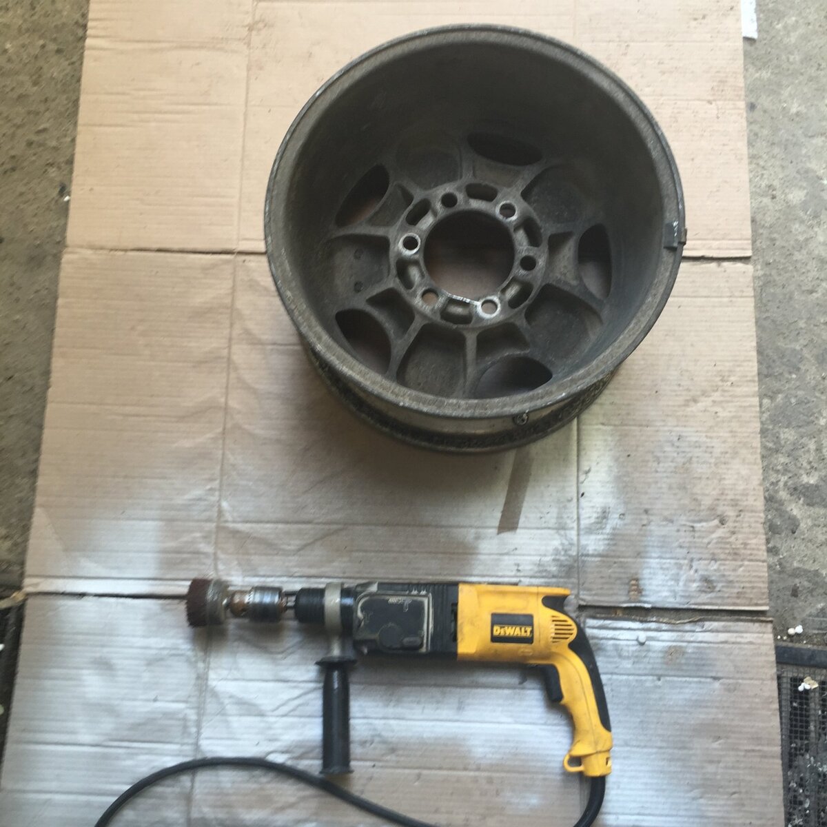

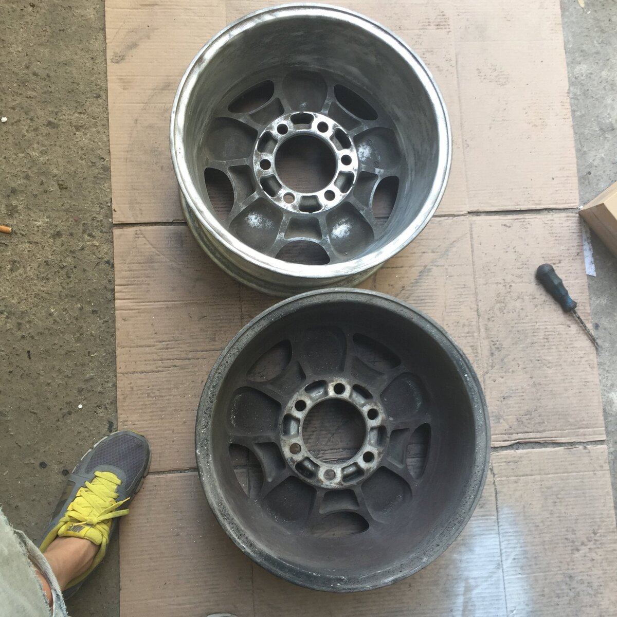

Wheels off decided to clean the wheels a little before handing them into the bodyshop....cant do any harm whilst tyres off.

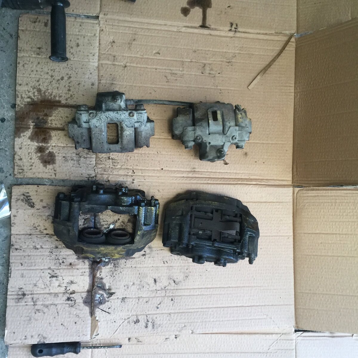

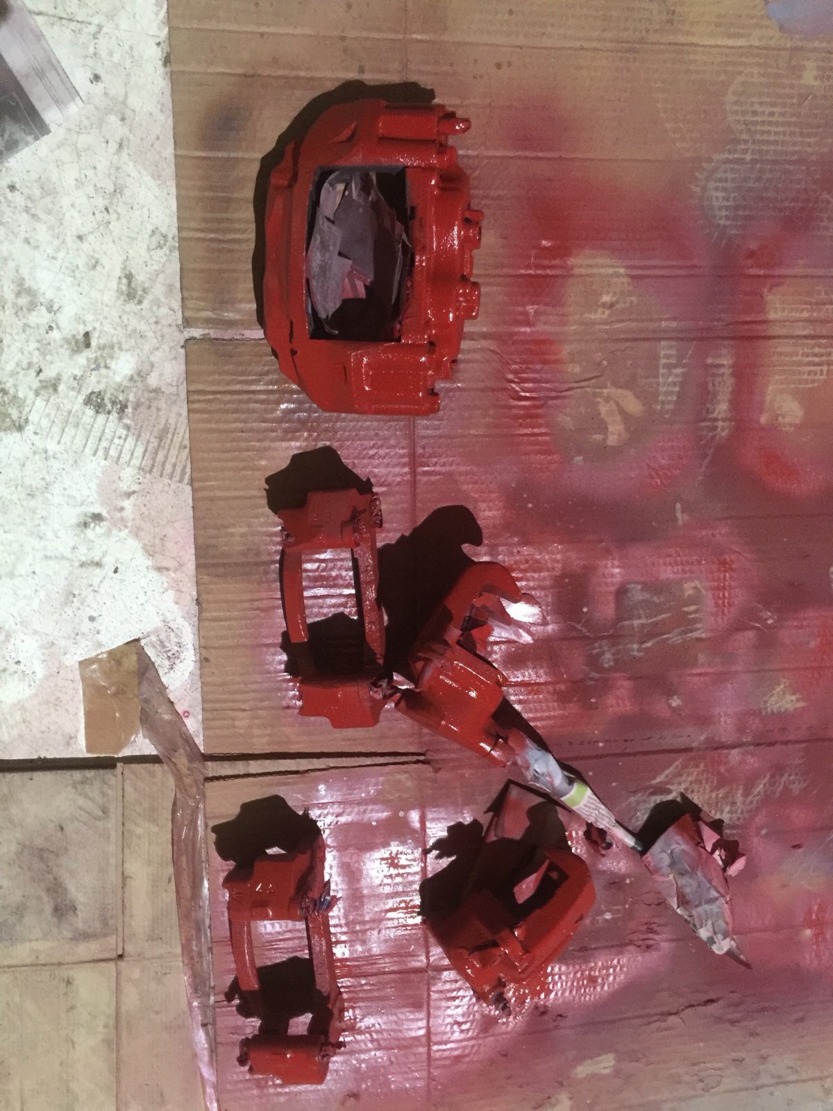

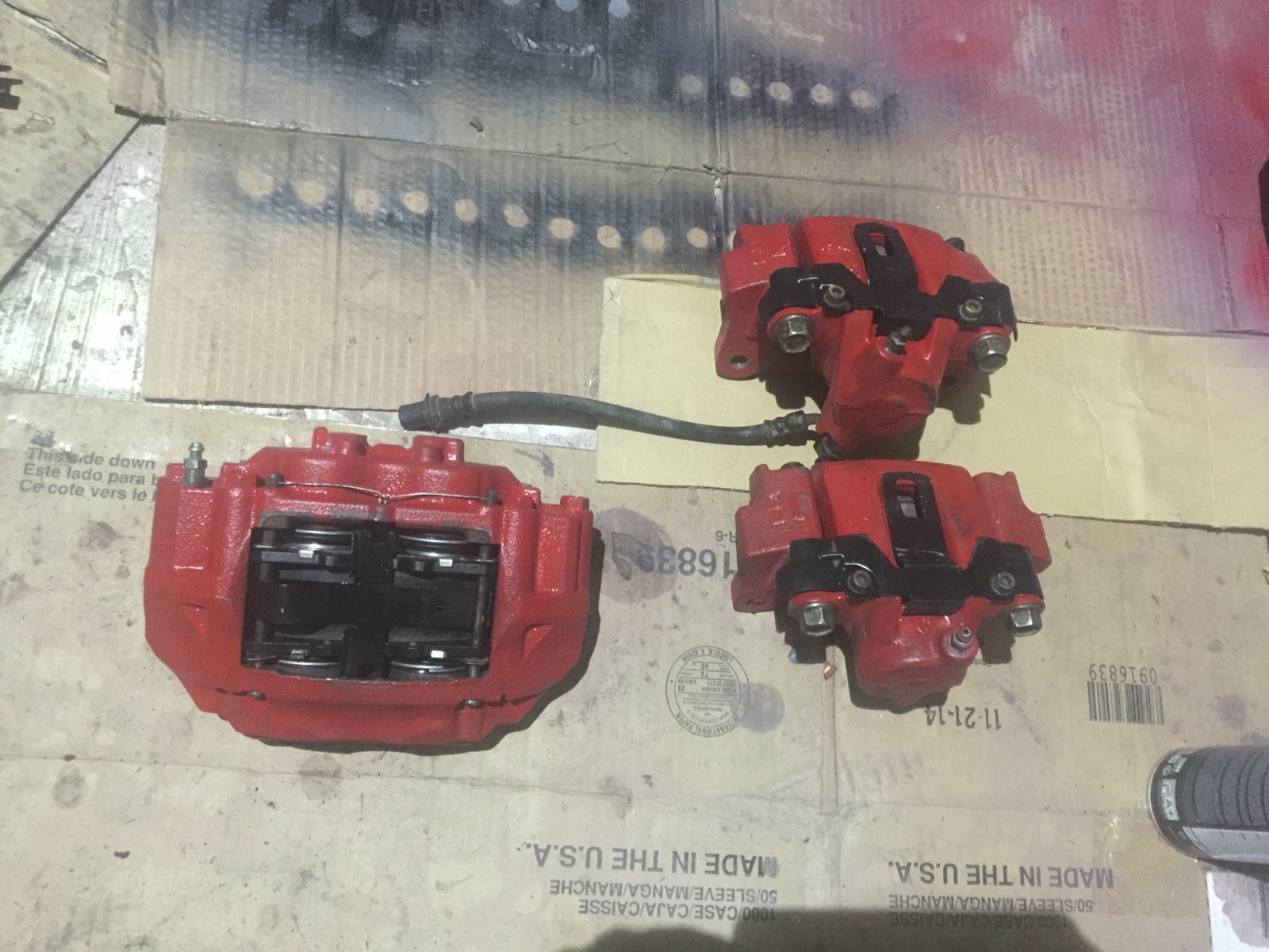

Whilst the wheels are away at the bodyshop thought I clean & paint the callipers. Whilst taking them apart noticed some of the rubber dust sleeves were torn & needed replacing with retainers. Oh boy :weary: job just got bigger.
Upon much deliberation......mornings coffee :think: decided to buy the rebuild kit with pistons front & back from the UK.
There are many years for wear & tear with pads always wearing out more on one end than even. Decided to fully restore them. Will take pistons out soon its becoming quite involving but thankfully youtube lends a hand :tonguewink:

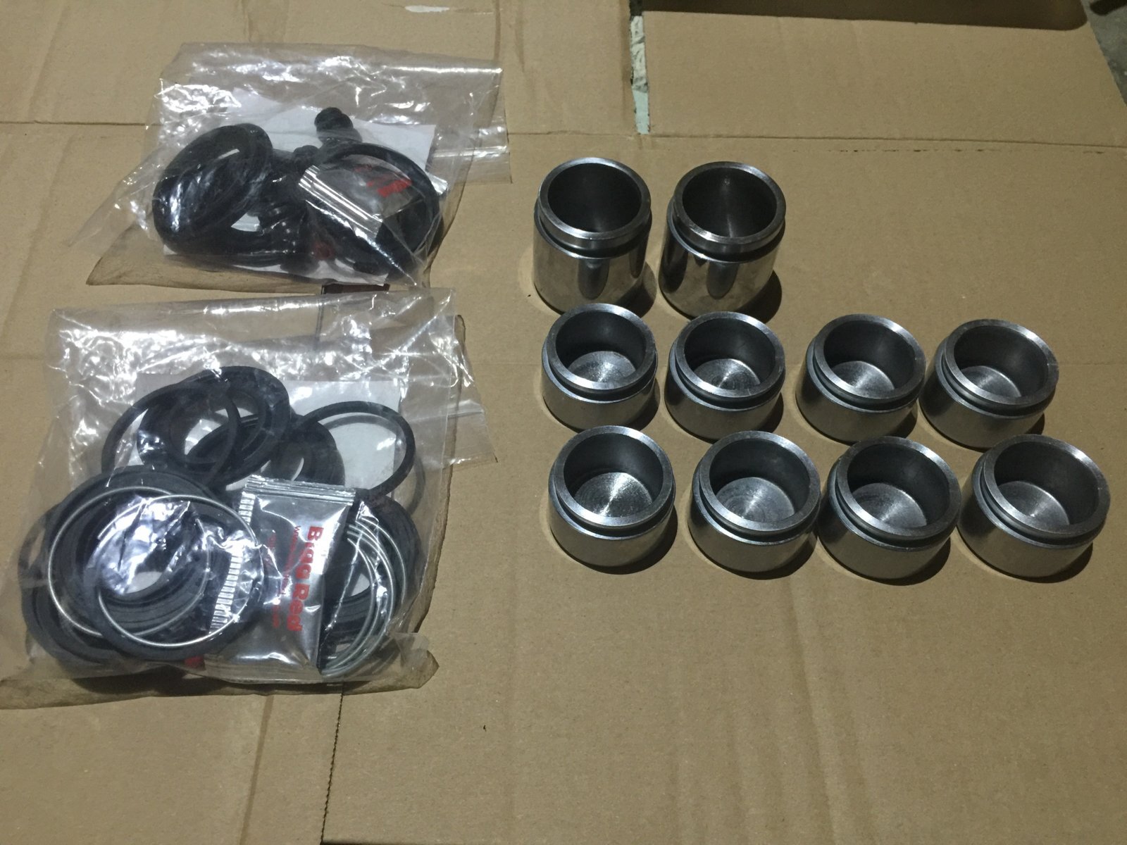

Brakes were put on hold!!......... finally getting them painted & rebuilt from a kit from the UK arrived.

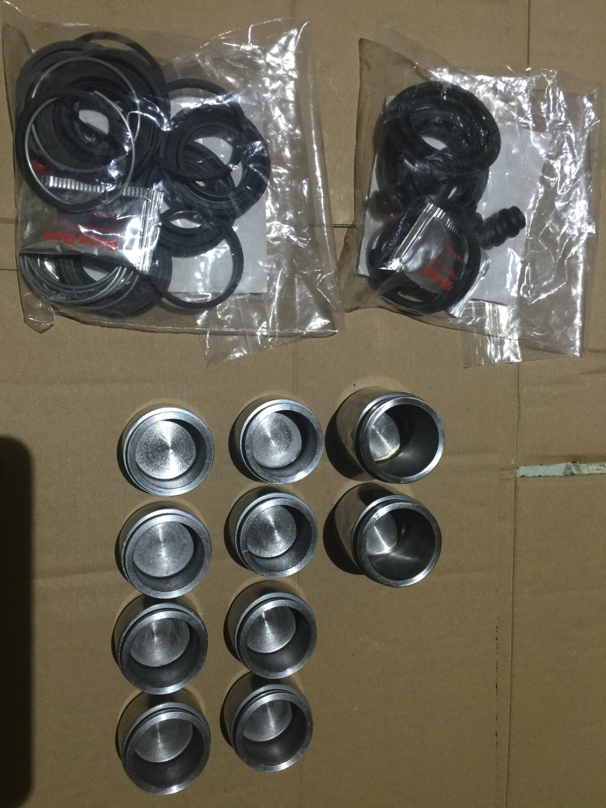

Ordered the whole inclusive piston kit for front & back didn't want to take the chance but it turned out the pistons where in great shape. Still changed them as its not a job you do often. ;)
As I went to the trouble to clean & took the unitive to paint them red........be nice to see how they look on the car even though I know won't really see them from behind the wheels.
Had a one front calliper piston I couldn't budge when compressor air so took it to my mechanic to help up. Thankfully got it back today to clean, dissemble & paint hence why three brakes shown. Always the last bolt, screw seems to give me a run for my patience....lol

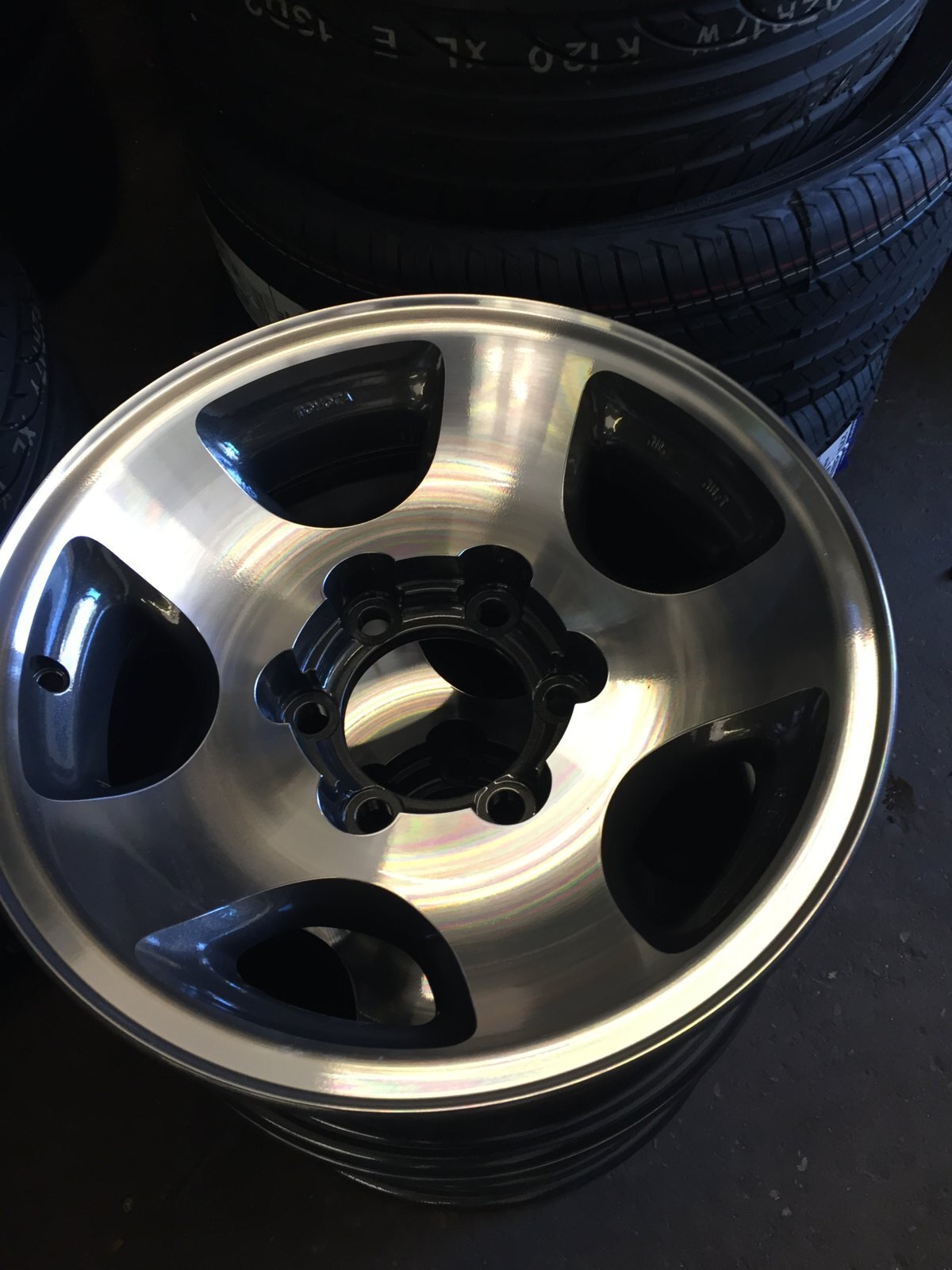

Like the wheels, did they grit blast them first? It gives a good key if they did, less likely to chip with some impact from rocks and stuff. :thumbup:
Hi Clive .... thought about sand blasting them but decided not to go to that much trouble wanting them done quickly. Unfortunately had to wait & change to another bodyshop so could have had them in bare form in the end.
Happy with the new look & think their gonna hold up well as I don't do any rock crawling.....lol
I'll leave that to you & the professionals :thumbup:

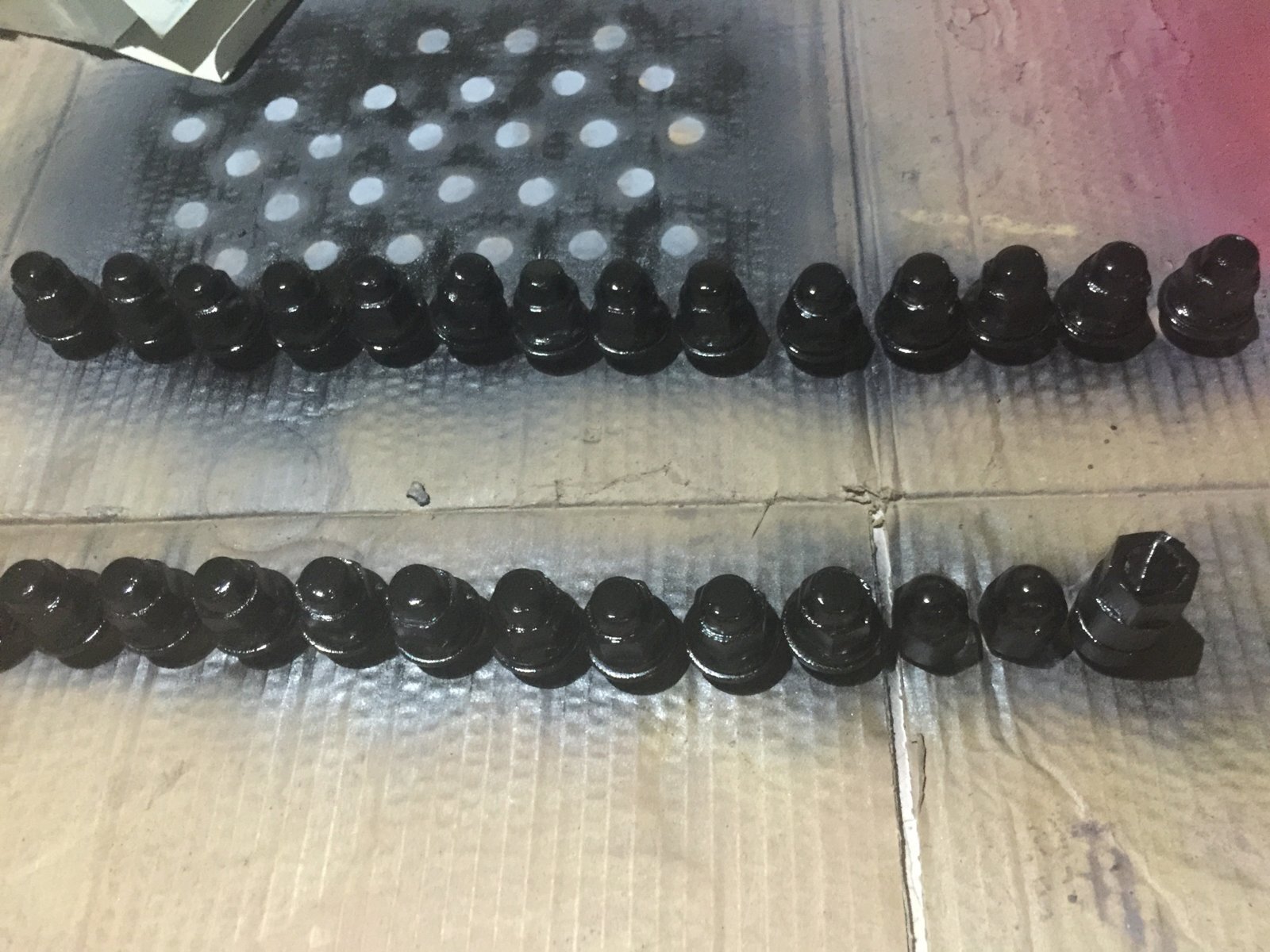

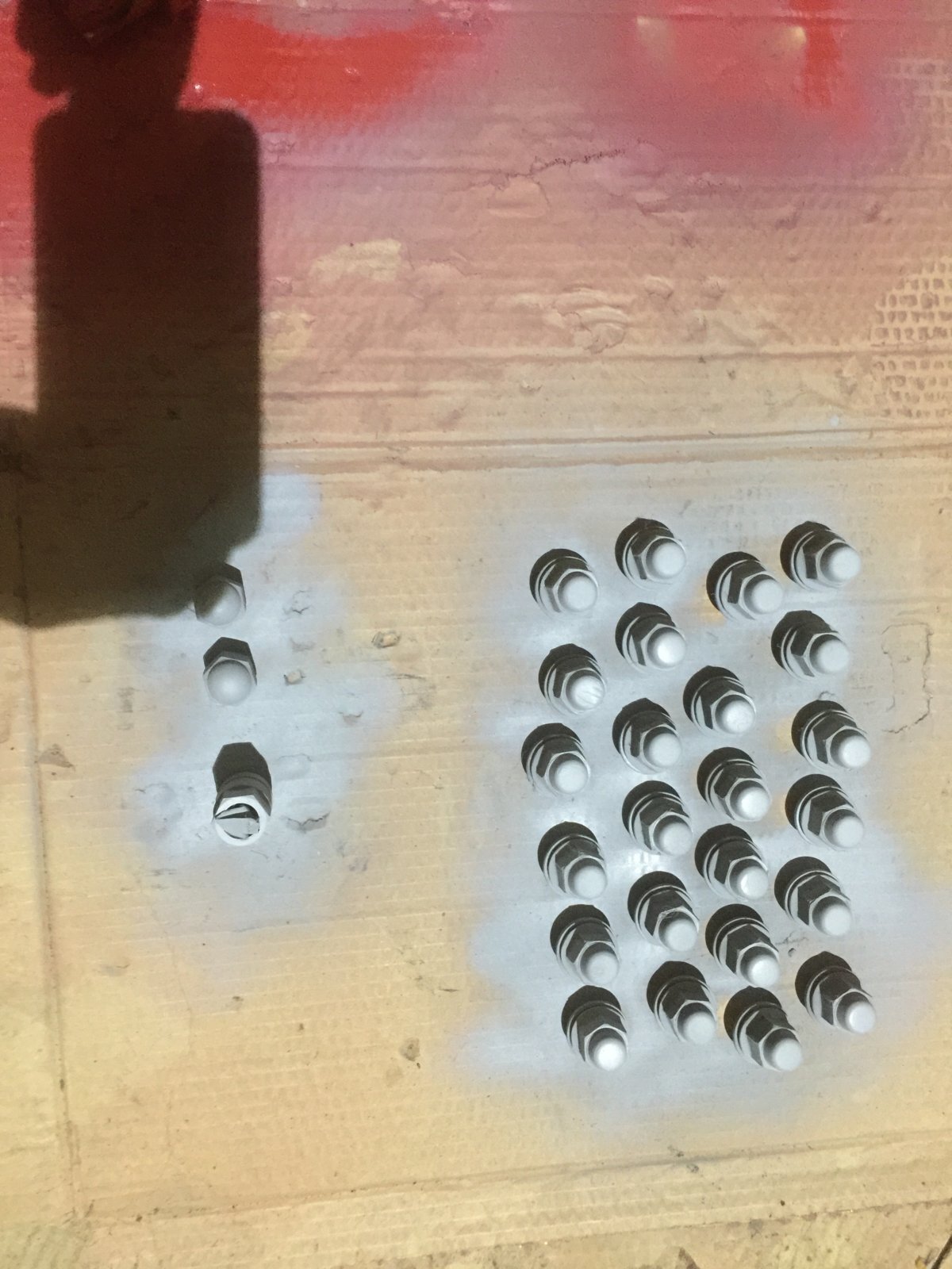

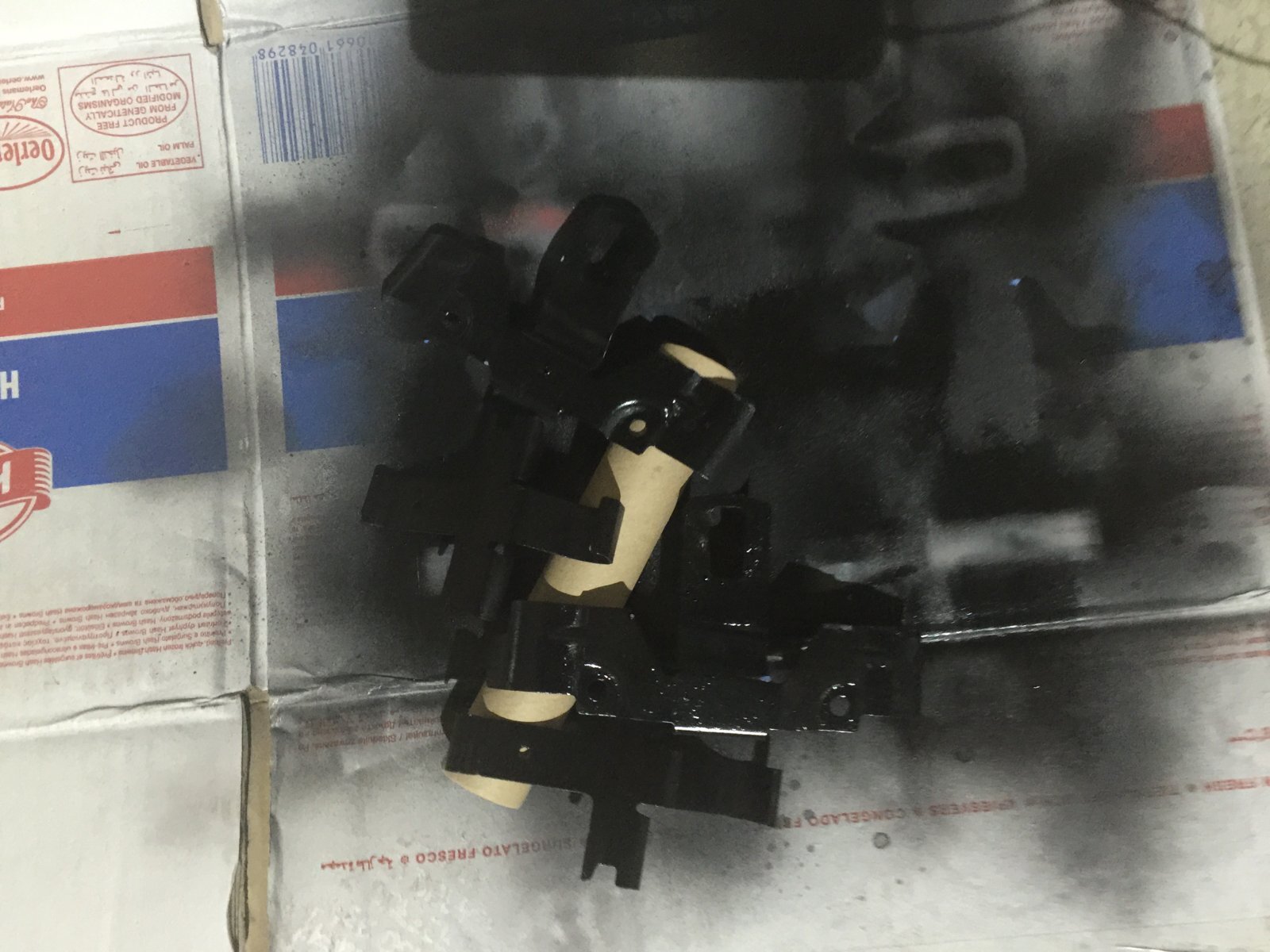

Whilst potting around waiting for paint to dry on the brakes callipers been wanting to use the original wheel nuts for the 80 & not the existing chrome ones. Only thing was they looked dull black so decided to freshen them up with some paint & attention.
Will see how they look & hold up soon :think:

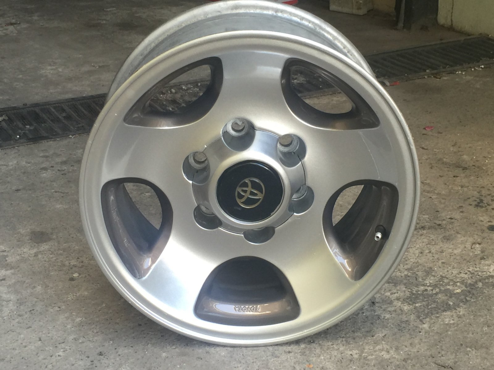

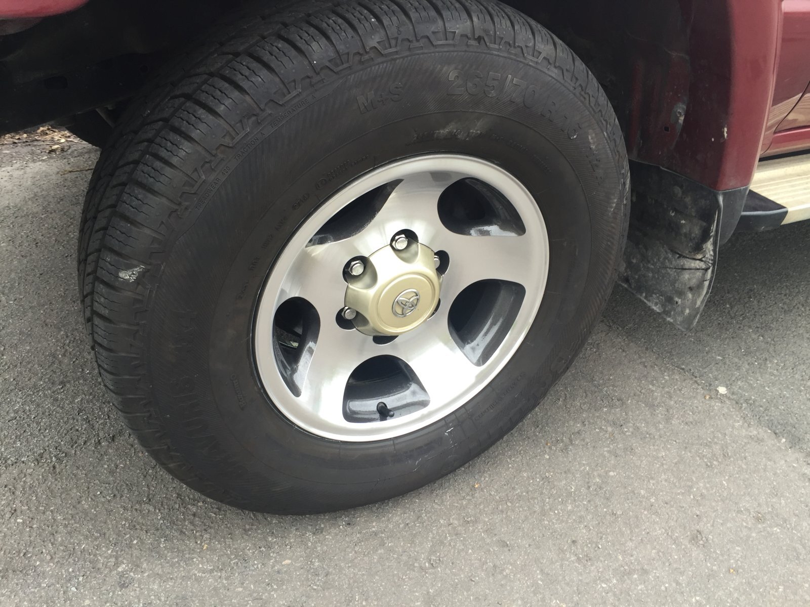

Those wheels look great Dervis. A little bit like mine but I suspect you've gone with the body colour rather than gunmetal grey like mine. Looks great with those centre caps too.
I think you did the right thing with those brake pistons. I didn't change mine and wish I had as they had very slight digs in them from fully retracting them and getting them stuck. I don't suppose you've kept the old good ones as I don't think they come as anything but the kit? I may need to look into getting some and do the job again :icon-cry:
Thanks star cruiser much appreciated. :)
I have a belief to do it once..... do it right. Its not everyday I'm gonna go through stripping the car. Wanted to make the most of it although its kept the car off the road for another 3 weeks. :weary:
The existing pistons were in great condition virtually new really so was surprised. I only decided to use the new ones I bought for the sake that I bought them & wasn't sure if I could return. Either way I thought having the other pistons as spares but if your interested maybe I can send you the pictures & sell them on if it helps you out?
Wouldn't mine seeing your 80 if you have any pictures on hand?...... thanks
Mines not looking so hot at the moment with peeling lacquer. But I'll see if I can find you some photos of the wheels at least. Maybe take a few of the truck's 'best side' :lol:
I'm guessing postage from Cyprus would be a killer on 8 metal cups.
