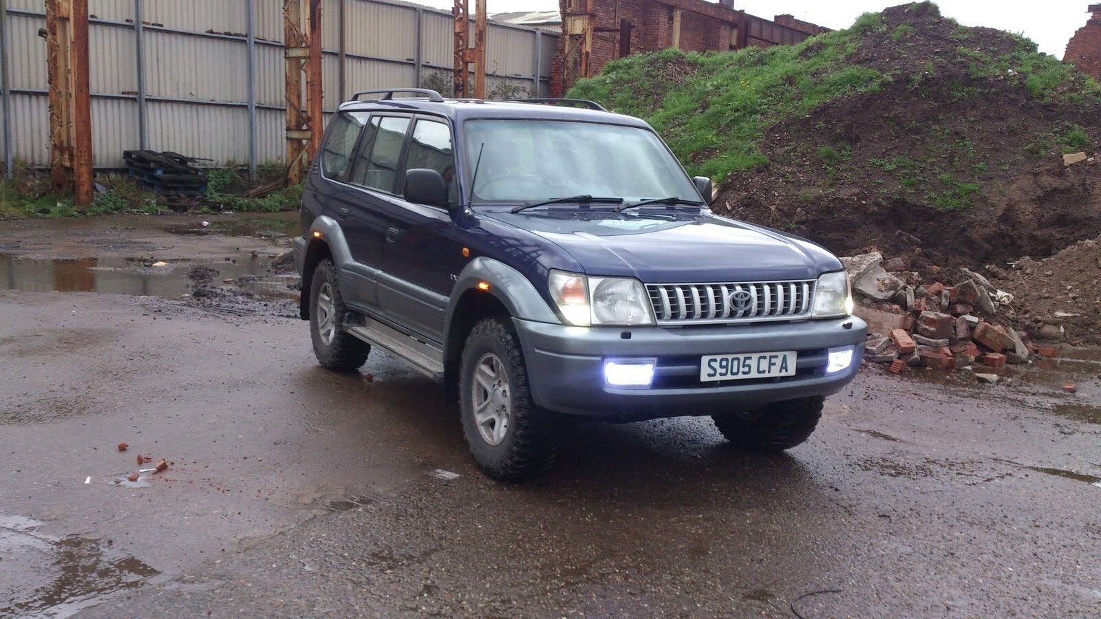

If you buy a landcruiser 90 series you can run on vegetable oil all day and drives perfect.
This was my old one and loved it.
