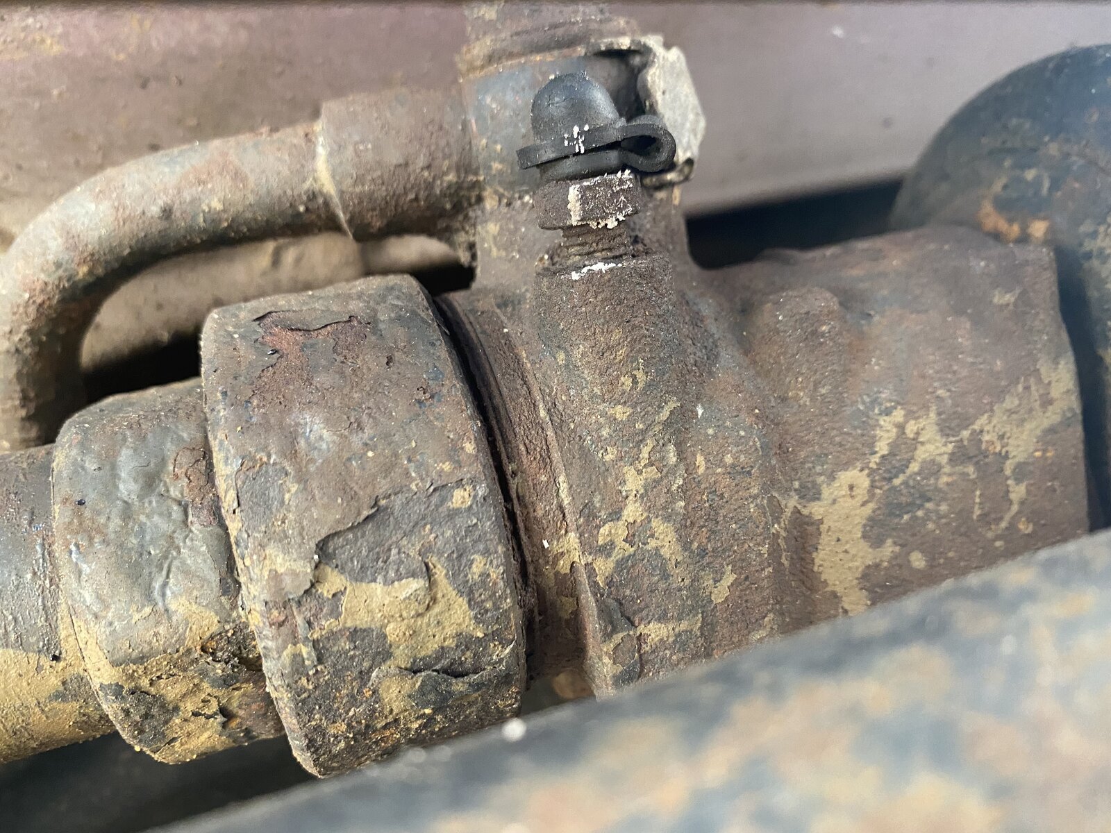

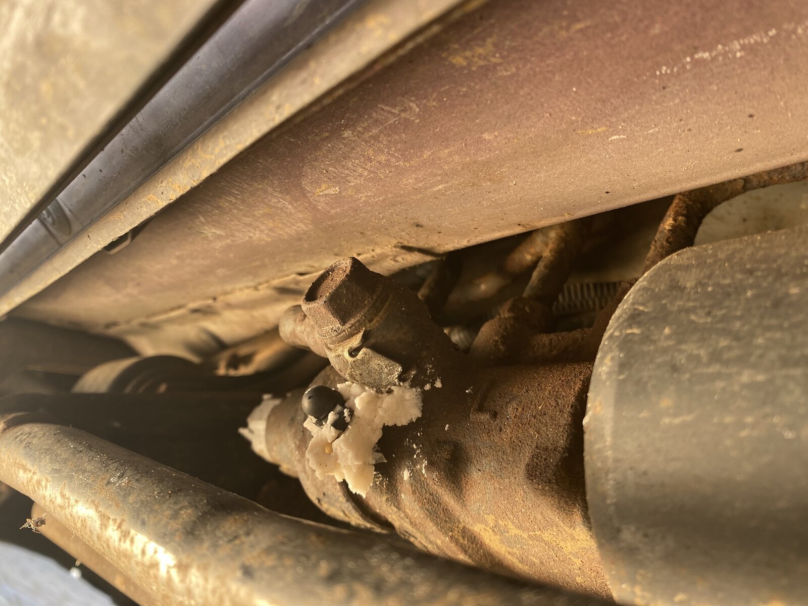

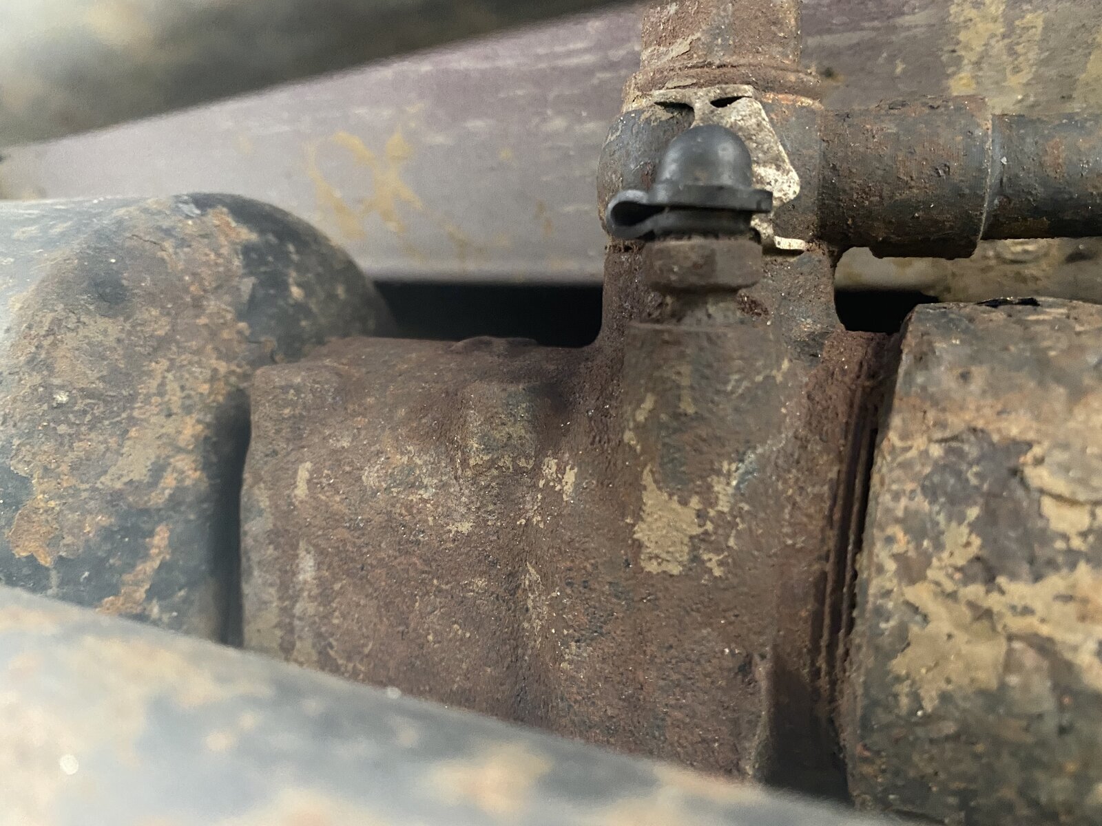

I tried to look for AHC bleeding screws to try DIY but they were submerged in rust so ordered fluid from Roughtrax n sent to a garage to sort it. Thought they ll have some technology to work with such screws. They didn’t do it and instead ordered nee bleed screws and asked me to come back after they get them.
I couldn’t wait so today made ACV-baking soda paste n applied. Will see if it works.

Shayne is it ok to use this one on small or sensitive areas like these bleeding screws on AHC, Breaks etc
Yeah its very similar to brick acid cleaner , a very strong bleach the best i can work out , stings your hands so don't get it in your eye . Developed for marine use as its safe to rinse off boats washing it into the harbour .
You don't have to wait for it to work just wash the rust off then rinse with water , obviously the exposed clean metal will oxidize quickly if you don't get some oil or paint or whatever on the part soon after .
Delicate parts left to soak in a tub of it over night will be gone in the morning !
R.I.P my halfords pro 19mm ratchet spanner , i forgot about it DOH! :cry:

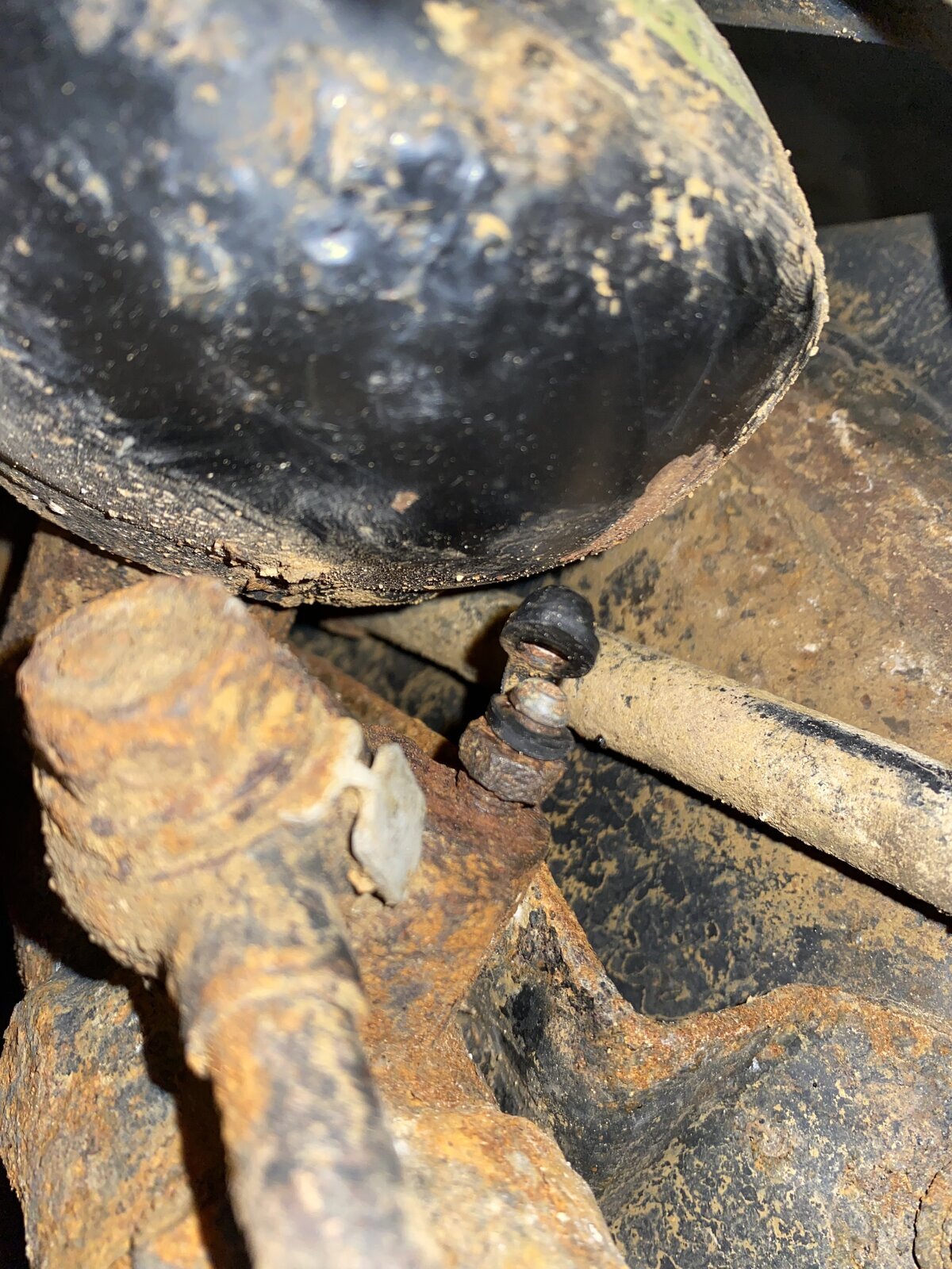

Krown seems to be working as expected. I can now see rust flacking off. Krown is expected to contain rust at existing stage, previous rust softens and falls off
Karl to my eyes it looks rust is gone but don’t know if those screws are operational now :) car is going into garage on 22nd. If these screws break, we have 5 new screws, 5 litres AHC fluid ready.
Removing rust is very hard job.
Looks like rust is still there on my screen Raj. Sorry.
From what Im seeing, if you paint that, it will bubble up again.
Agree, rust removal/protection IS a hard AND filty job, there are plenty of us on here that have done the whole underside at times.
