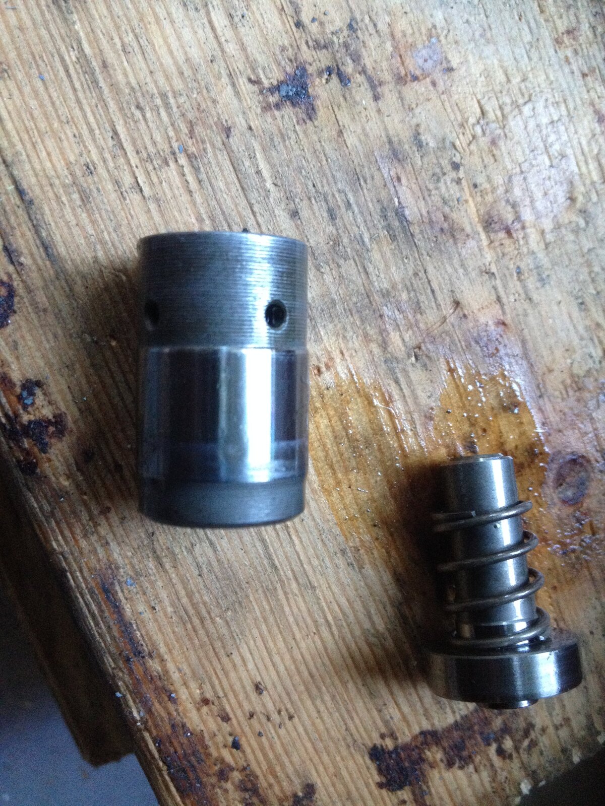

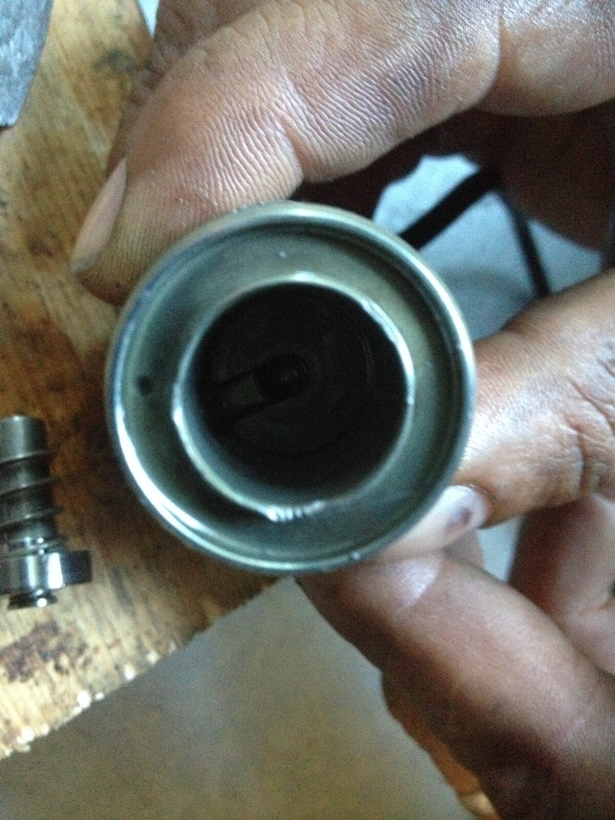

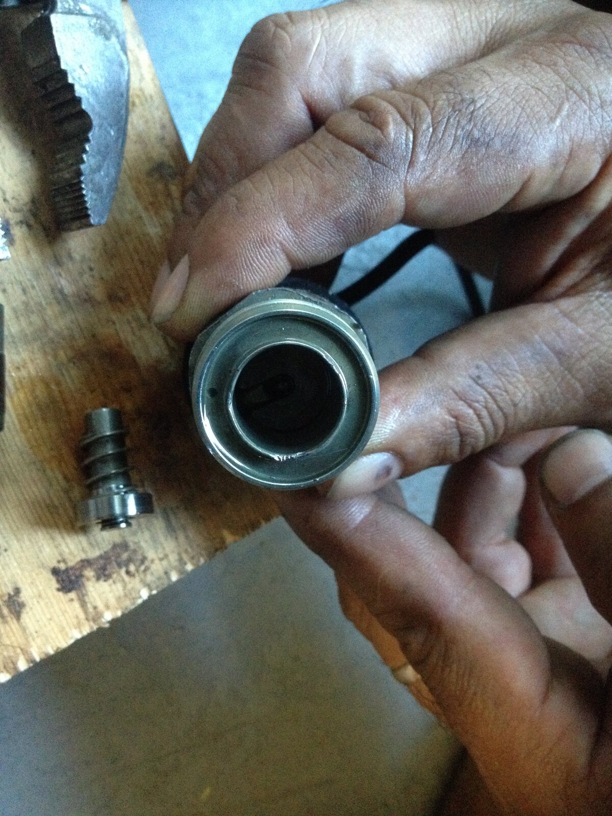

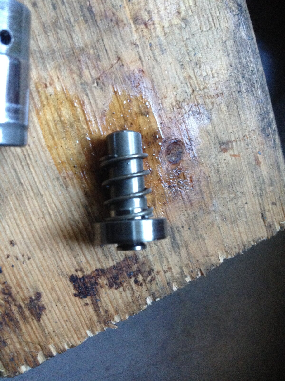

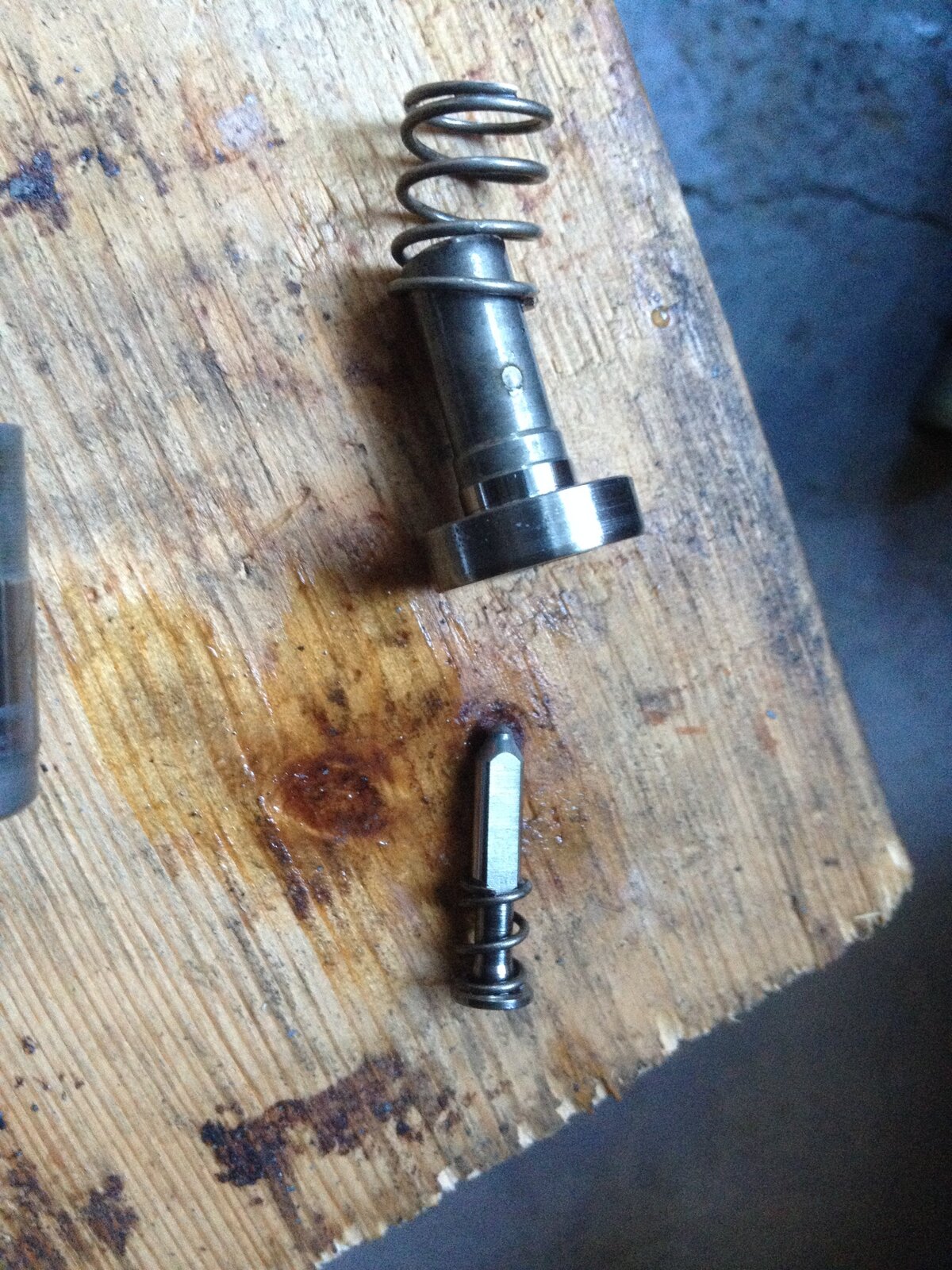

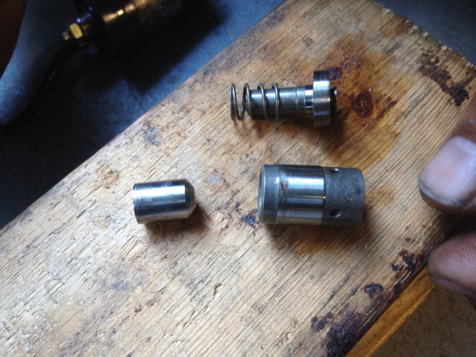

I've pulled one apart already Shayne :icon-rolleyes: There's nothing much too it really... It's a powerful electromagnet that basically pulses some ridiculous amount of times in a minute. The duration of the pulse affects how much fuel is pushed through to the injectors, working in harmony with the timing control valve right underneath it. I think adjusting the nut may adjust some kind of preload tension on the plunger, allowing that duration gap to increase marginally.

Heres some pics of when I took apart my spill control valve...Enjoy :lol:

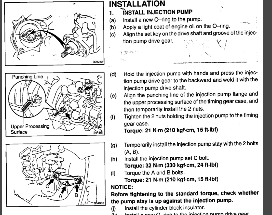

Would someone be so kind and check there pump alignment out for me, just so I can confirm I have mine set right. I've been noticing how clean the exhaust gases have been since the head job, and don't know if it's down to the timing being slightly leaner or just because of the cleaner head. I've also been getting good fuel economy like I mentioned before, nearly 400 miles with in town driving, that's never happened before. I have my pump timed exactly as this manual suggest, but it could be wrong, as a couple other details within this manual have been wrong.
There should be a line on the pump which is in line with the notch on the mounting casting, as shown above. If someone could check there's out and let me know that'd be great.
I've just been out to check and that looks right to me .

Thanks for checking. I don't necessarily mean new head, but I did re-seat the valves, port the inlet and exhaust ports and the intake and exhaust manifolds, and the turbo manifolds as well. It's just surprisingly really as I'm used to a touch of black smoke on at least start up. Now I get none at all on start up and driving. I just advanced the timing but didn't change the starting up. I'll run it like this for a bit anyway and see how she goes. I've got the fueling tuned about one full turn clockwise from standard setting so I wouldn't say I'm running on the lean side. Plus the power is there...
