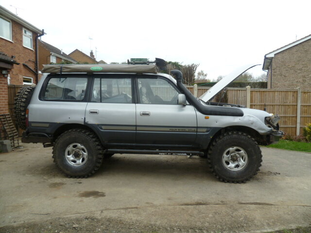

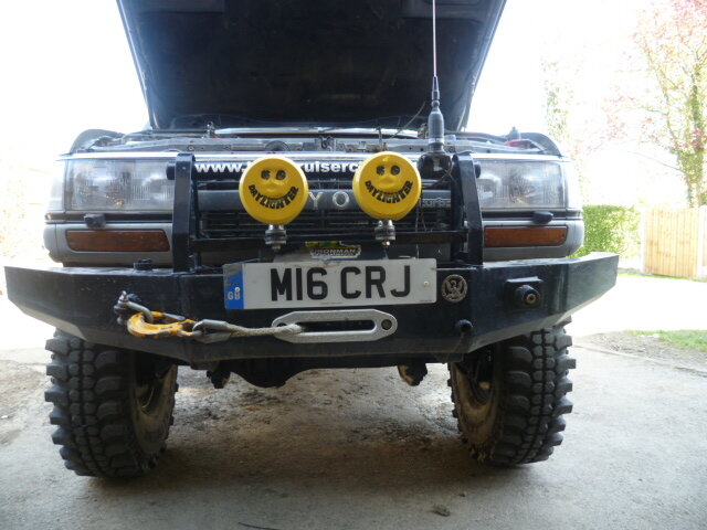

OK, that look a bit better?
[attachment=0:1bh5v0er]P1000863.JPG[/attachment:1bh5v0er]

Before:
file.php
And after:
file.php
You took the indicator out? No its an optical illusion that you can only see if you life the bonnet and remove the indicator :think:
:idea: So now you have to modify all those bumpers and sliders or you could make new ones and sell the old ones :whistle:
Nice try Rob.
Actually it's only gone up 40mm. I don't really like big body lifts but mild ones actually make a lot of sense. It certainly gives you better access underneath for other jobs. When you get beyond a couple of inches you start to run into all sorts of modifications that need doing. The front bumper was built with a lift in mind so that's fine. The rear one will just need a rubber strip. All worked out fine.

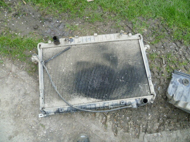

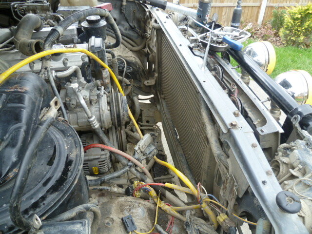

I have to drop the rad correspondingly tomorrow. It had to come out anyway so I took the opportunity to give it a good blast through. It was solid - again. Next time I'll remember to pull the blind down.
[attachment=1:29j6xfkq]P1000861.JPG[/attachment:29j6xfkq]
[attachment=0:29j6xfkq]P1000862.JPG[/attachment:29j6xfkq]

40mm, you would have thought that it would be easer to see it. I knew it was there but the proof was the rear bumper in relation to the rear quarter moulding.
It seems odd as the wheels look look smaller now, its funny how a set of 37s on an 80 don't look huge with a mild lift. Just reminds you have huge these trucks are.
I know. It's actually very apparent when you are standing there.
I think that it's something to do with the two tone on my truck Rob. Without the coloured arches it look really odd. But these new tyres sort of fill in the line. OK OK I know it sounds odd, but the truck does look very different.

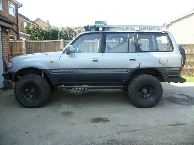

Here's the truck with it's new BFs on.
[attachment=3:137qw1cb]P1000869.JPG[/attachment:137qw1cb]
The lift went OK in the end. I have done 4 or 5 of these now and still don't know how people claim to do one in an afternoon. Even without any major snags it's at least one very full day, if not a day and a half. OK fixed other stuff as I've gone along I suppose. Running very nicely on these ATs. Just needs the brake bias fixing and I think I have a rear ABS sensor on the blink, so I shall have to raid the spares box again.

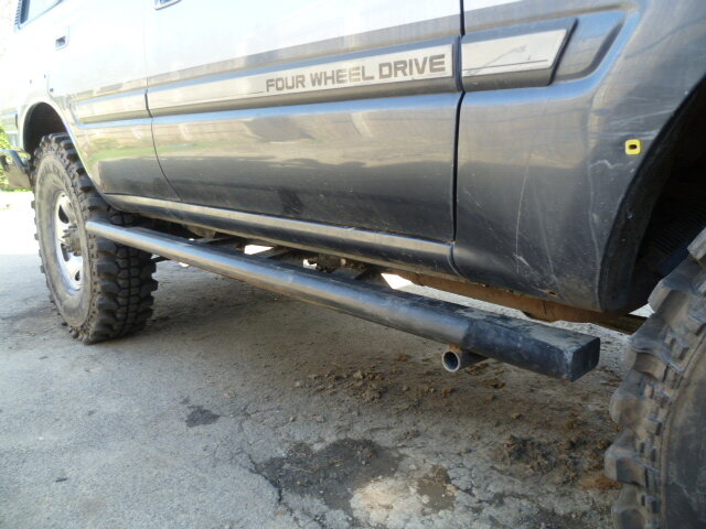

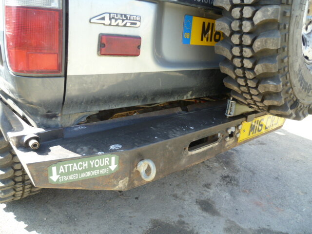

I modded the top rad brackets. This mean that I don't have to faff around with Mr T's STUPID bobbin fixing again to take the rad out. It's a multi purpose thread this one - lift and tyres really. Here's how the lift has affected the gaps all round.

Bumper - rear
[attachment=1:137qw1cb]P1000865.JPG[/attachment:137qw1cb]
Sliders
[attachment=0:137qw1cb]P1000867.JPG[/attachment:137qw1cb]
