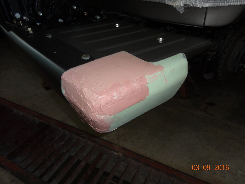

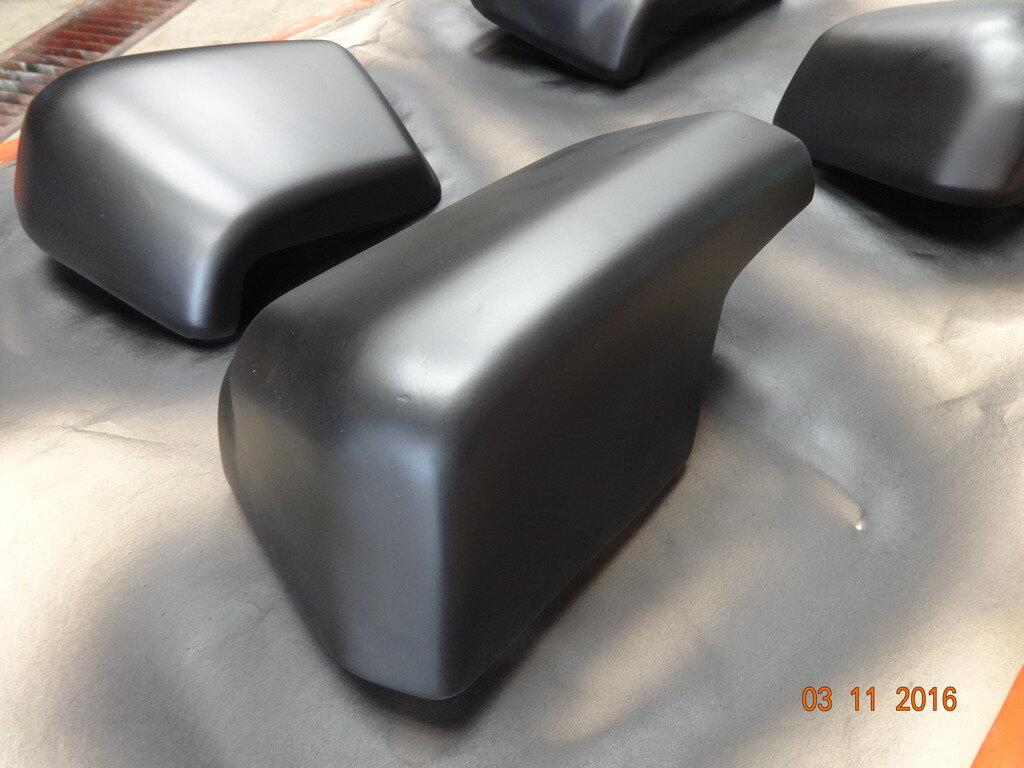

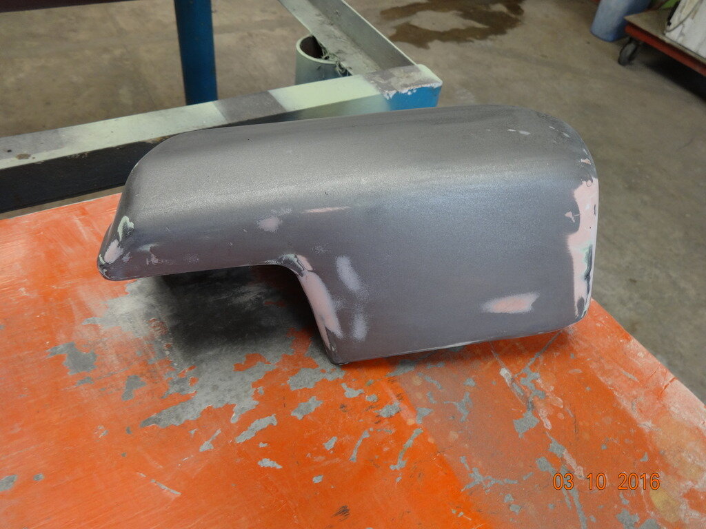

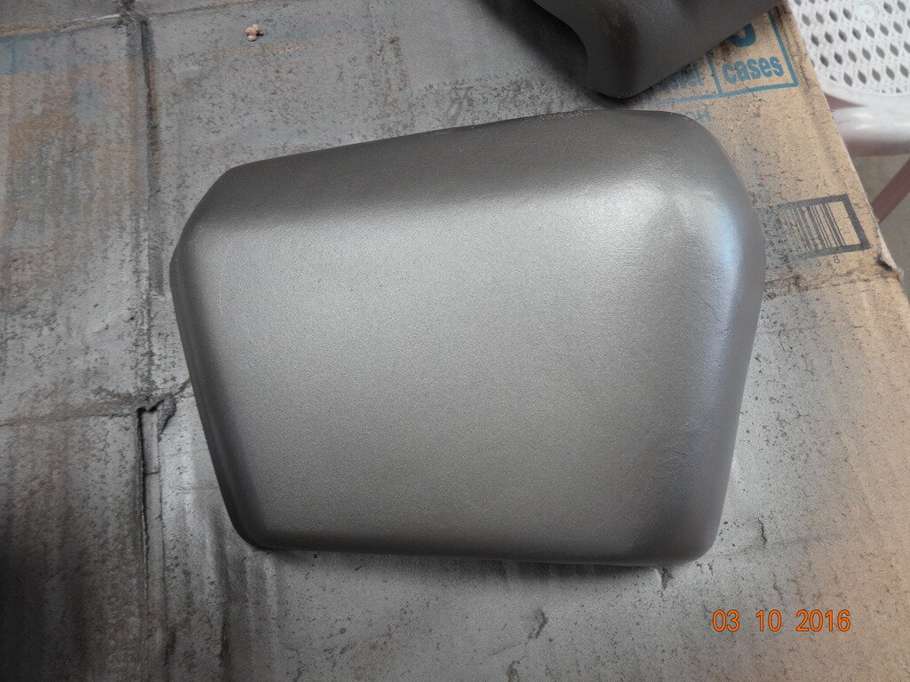

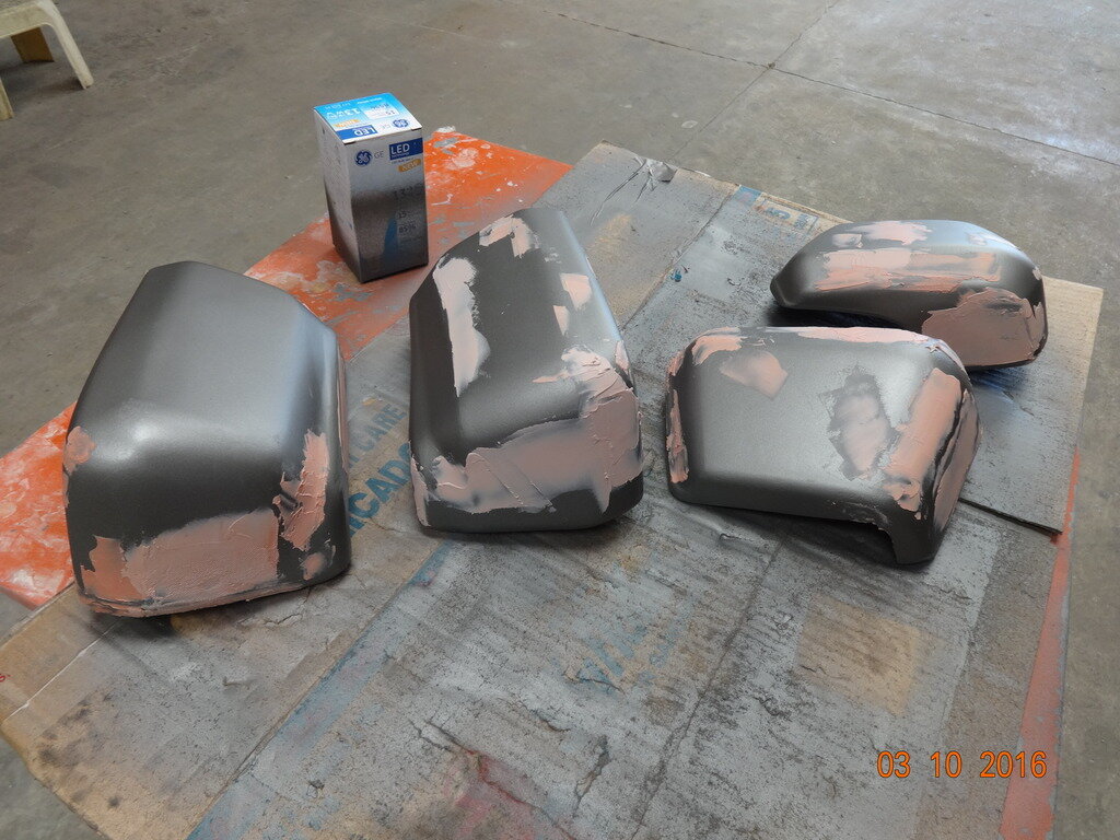

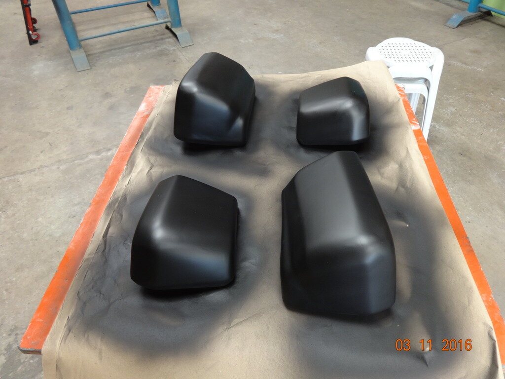

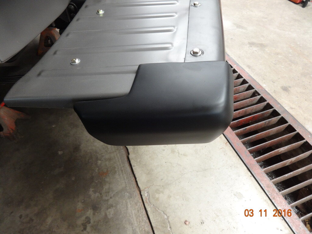

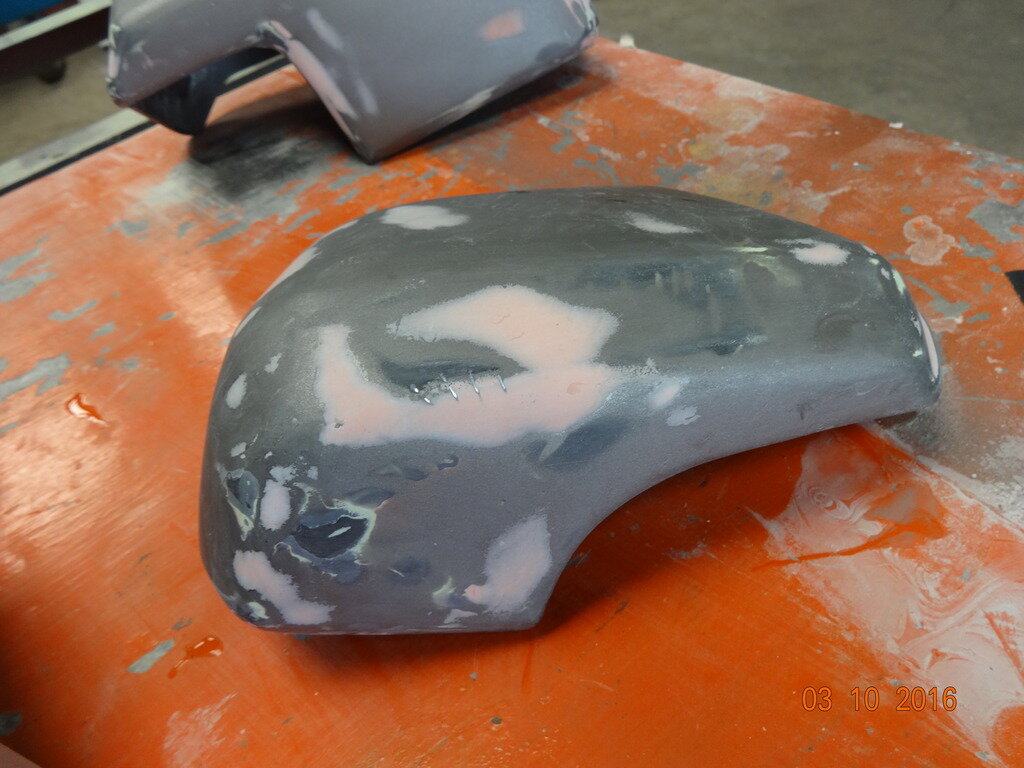

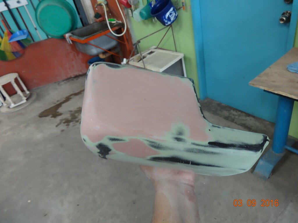

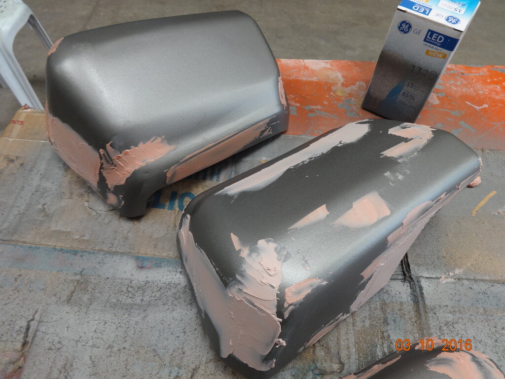

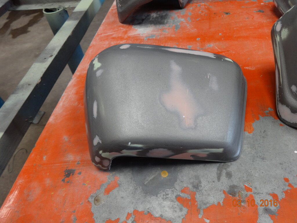

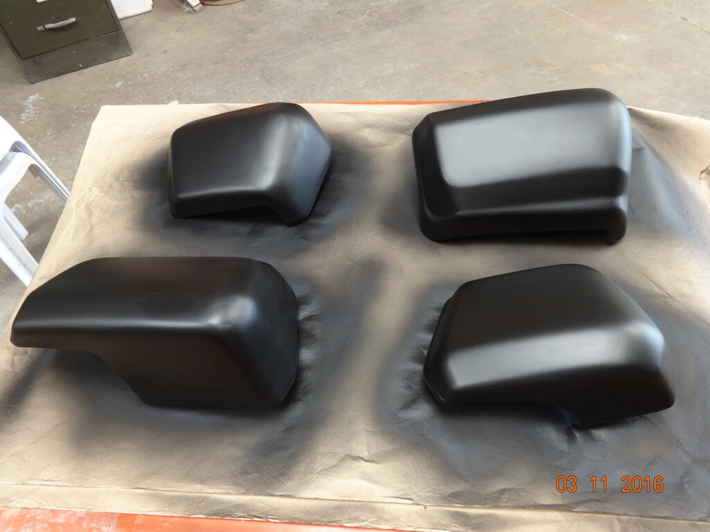

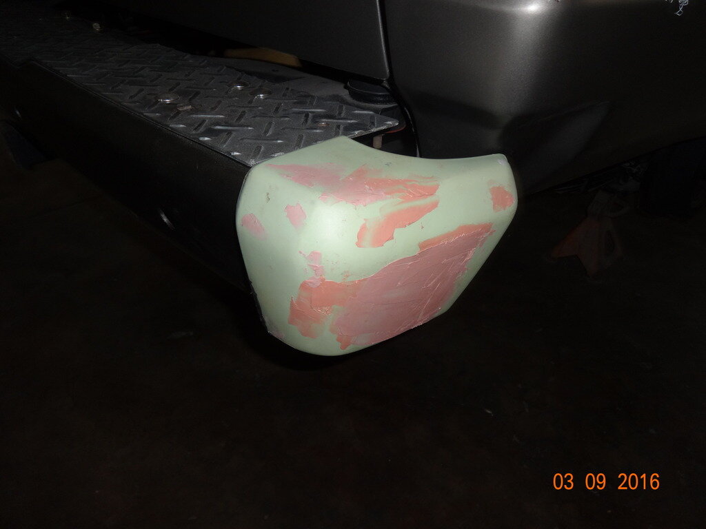

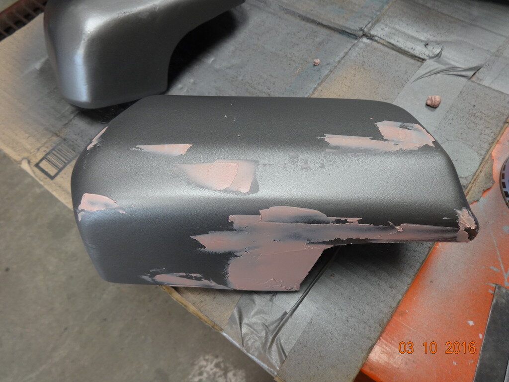

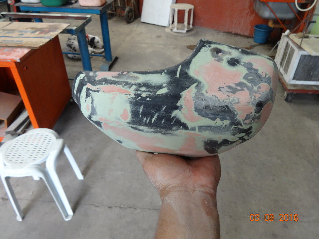

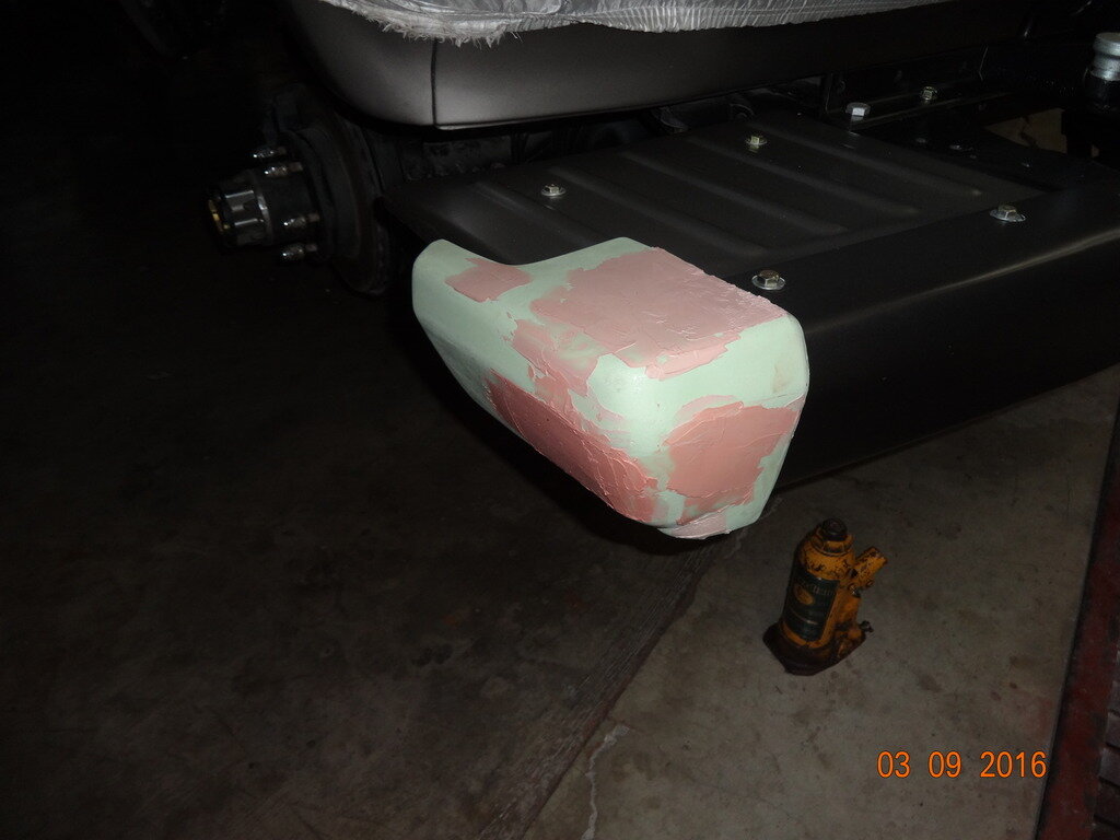

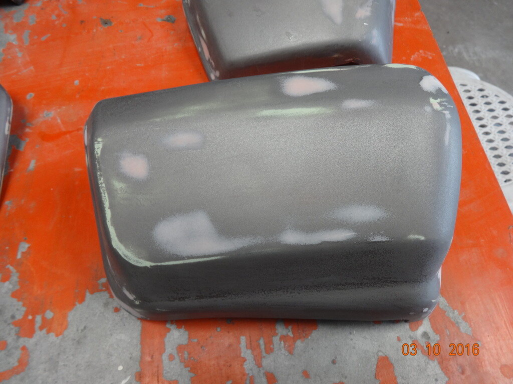

It is a special primer for plastic and vinyl. Examples are in the google search https://www.google.com.ph/?gws_rd=ssl#newwindow=1&q=primer+for+plastic

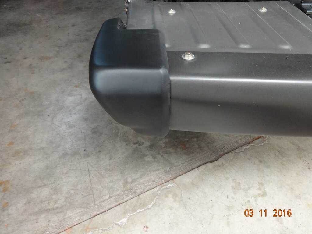

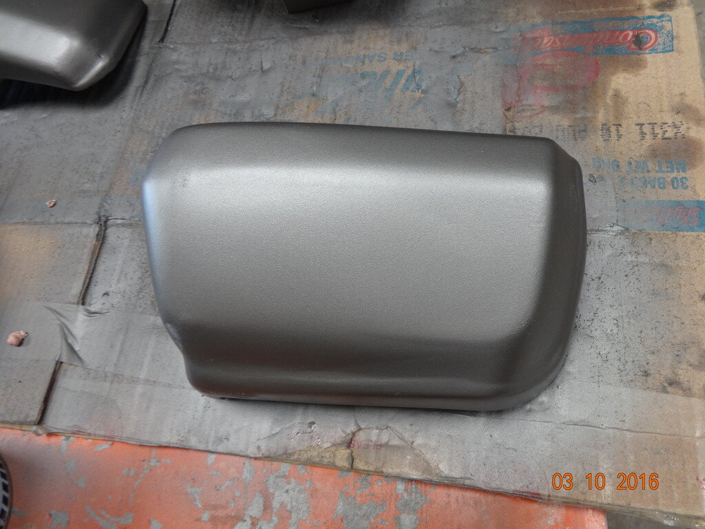

It does not really matter what brand, most important is the surface preparation. I usually clean with water to take off dust and other dirt then allow to dry. I then apply acetone before spraying the primer. I use a touch up spray gun to apply multiple layers of thin coats.
Thanks Oding i was always skeptical about durability without a key for paint to grip , i never thought of acetone .
