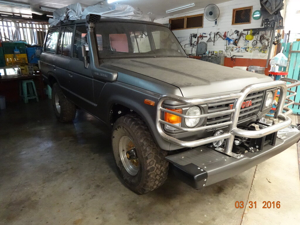

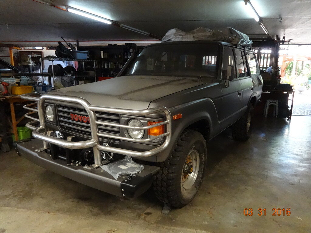

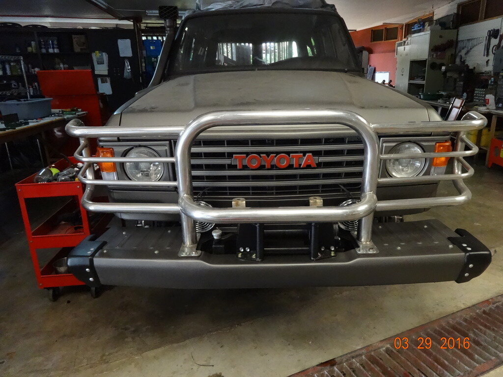

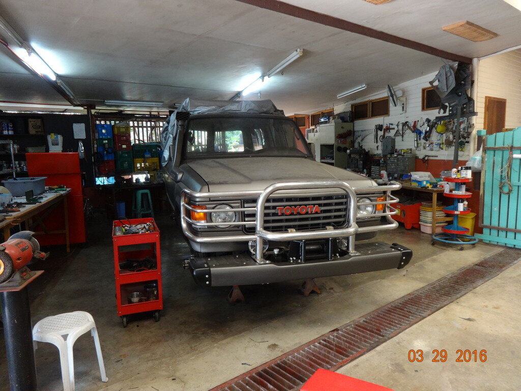

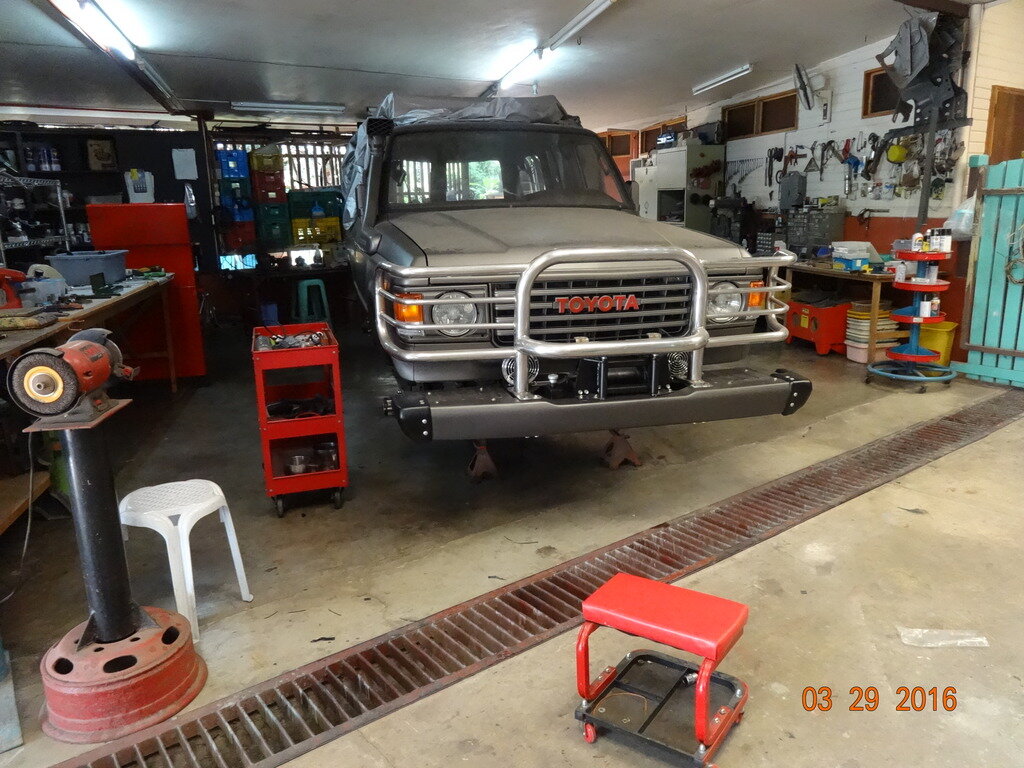

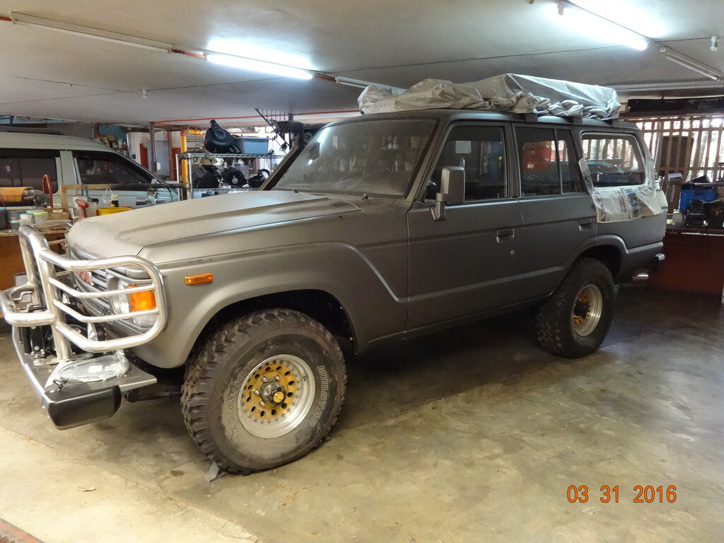

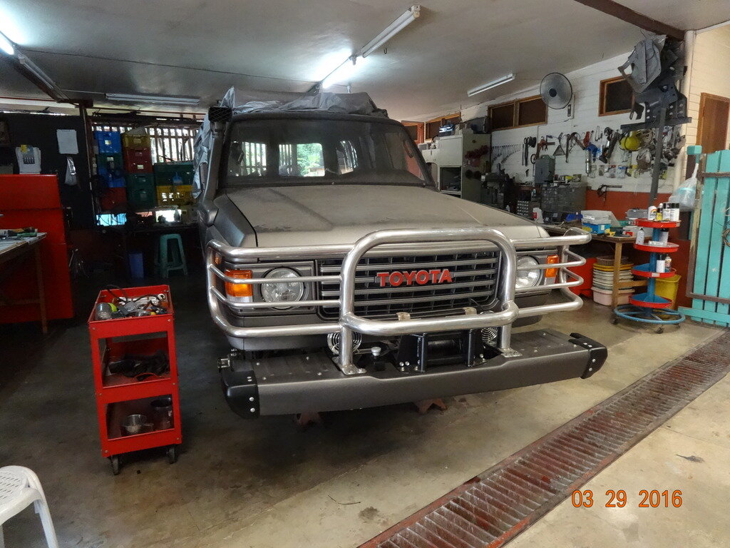

Installed the grill and and headlamp doors. I will schedule for the bleeding of the brake and clutch system tomorrow.
Looking good Oding. One thing if I may be so bold that I might do if it were mine is to paint in the heads of the coach bolts to match the background black. I don't know if it's the photos but they do stand out rather a lot.
Hope you didn't mind me saying. [emoji4]
I guess you have a point. Sometimes we need other people's opinion to get it right. "You can't see your own ears"

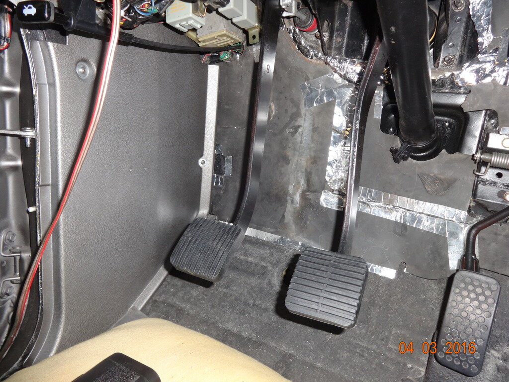

Test drive to adjust brakes and clutch. Check if all under chassis components are in good working condition. Then back to install more. A/C, sound system, drawers, LED bars, etc. Hope to be all done in a week.

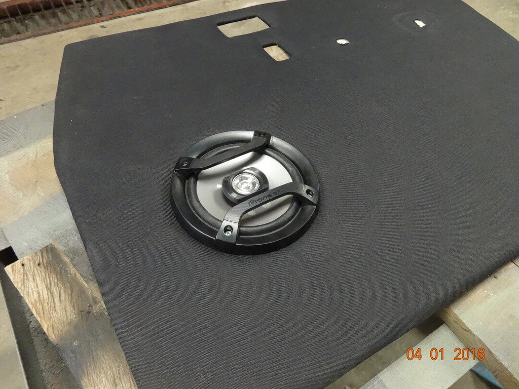

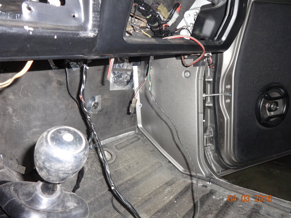

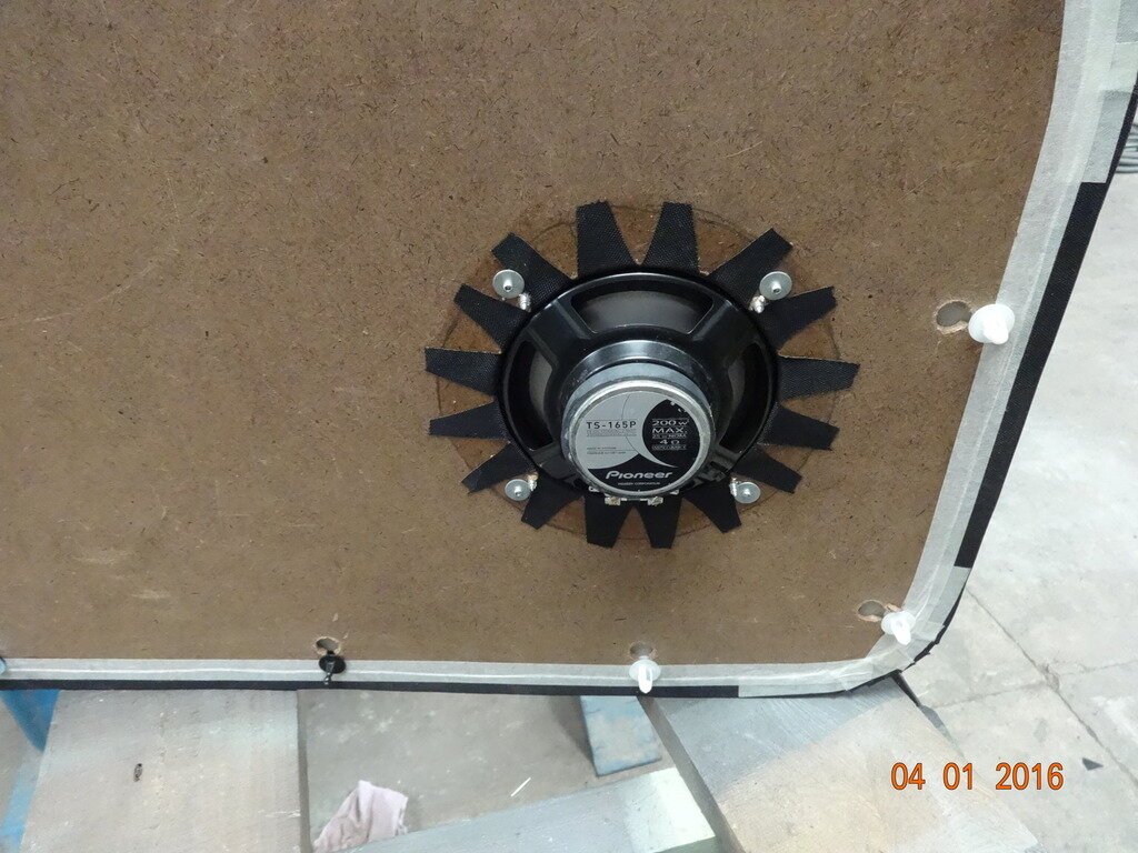

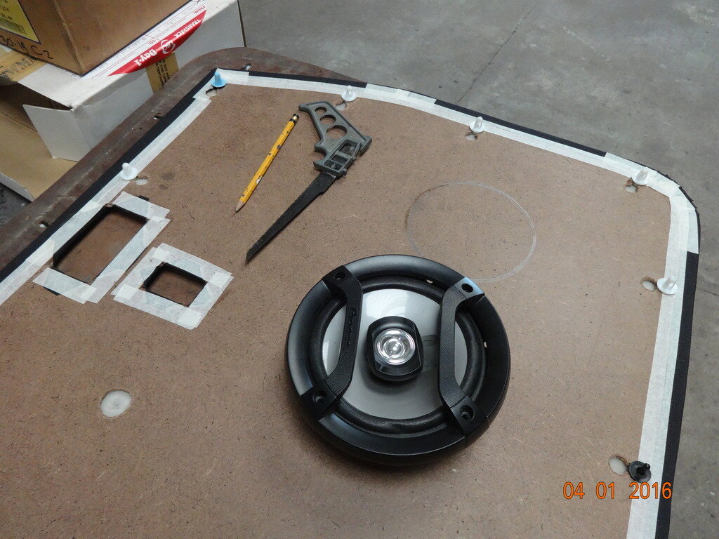

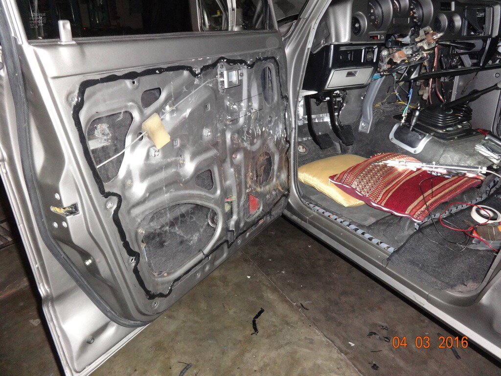

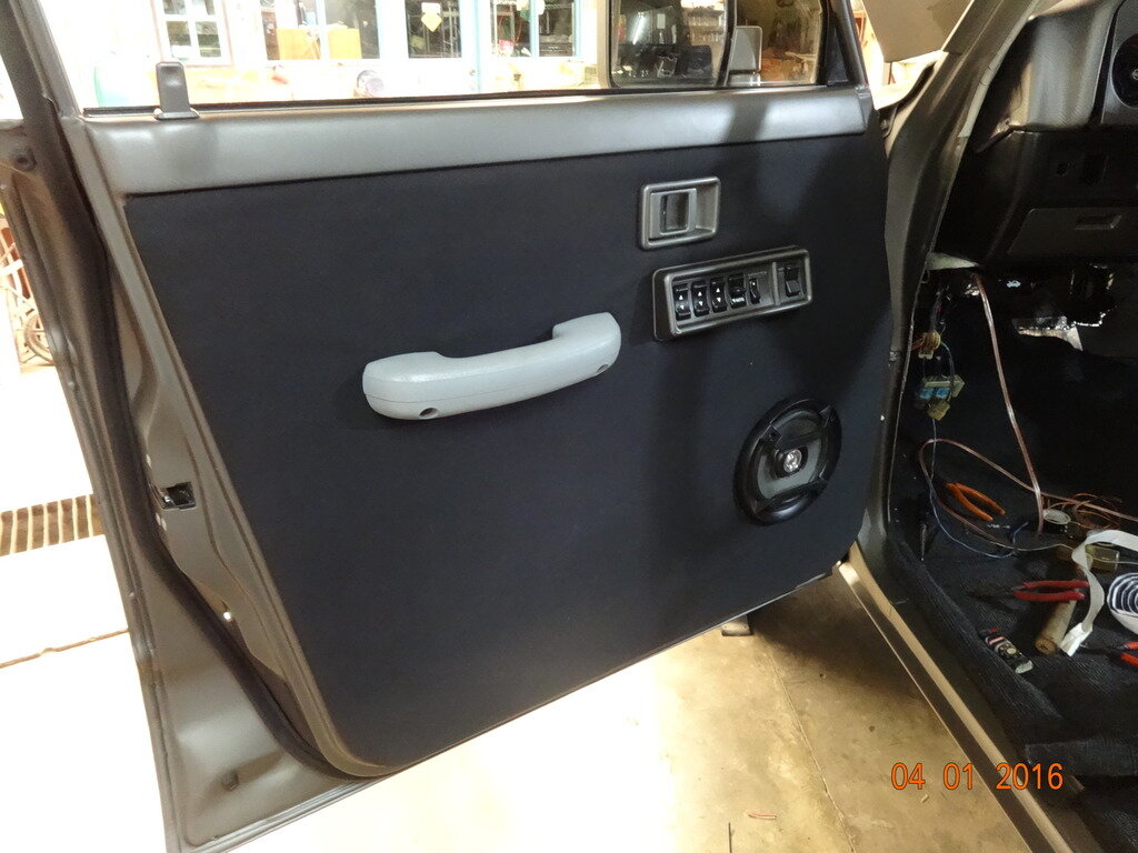

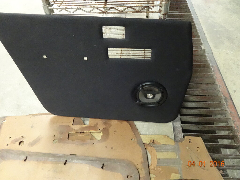

I decided to install the speakers today. The power steering has a leak and I need to check it before the damage gets more serious.

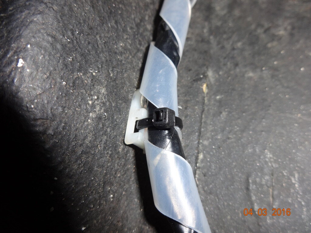

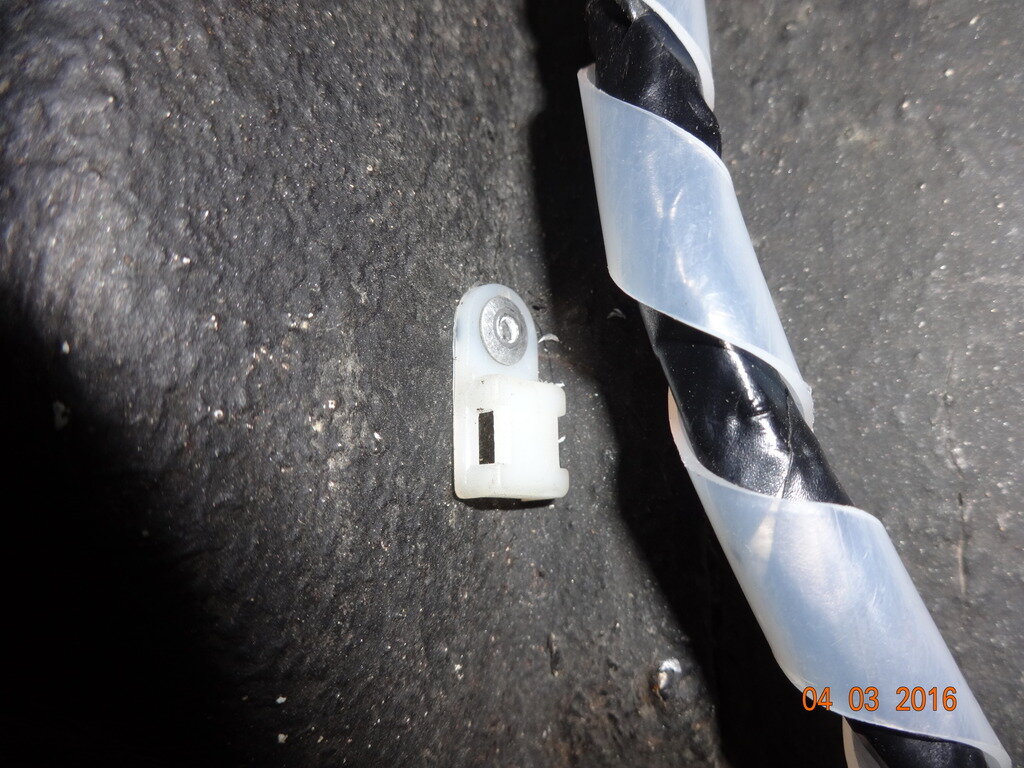

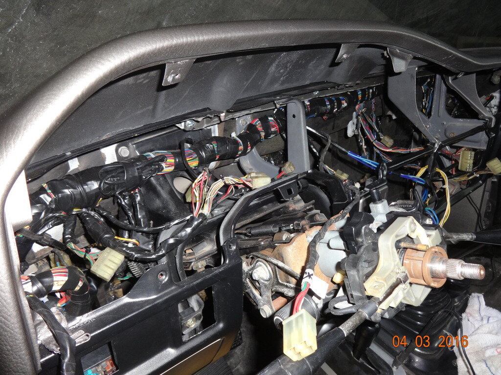

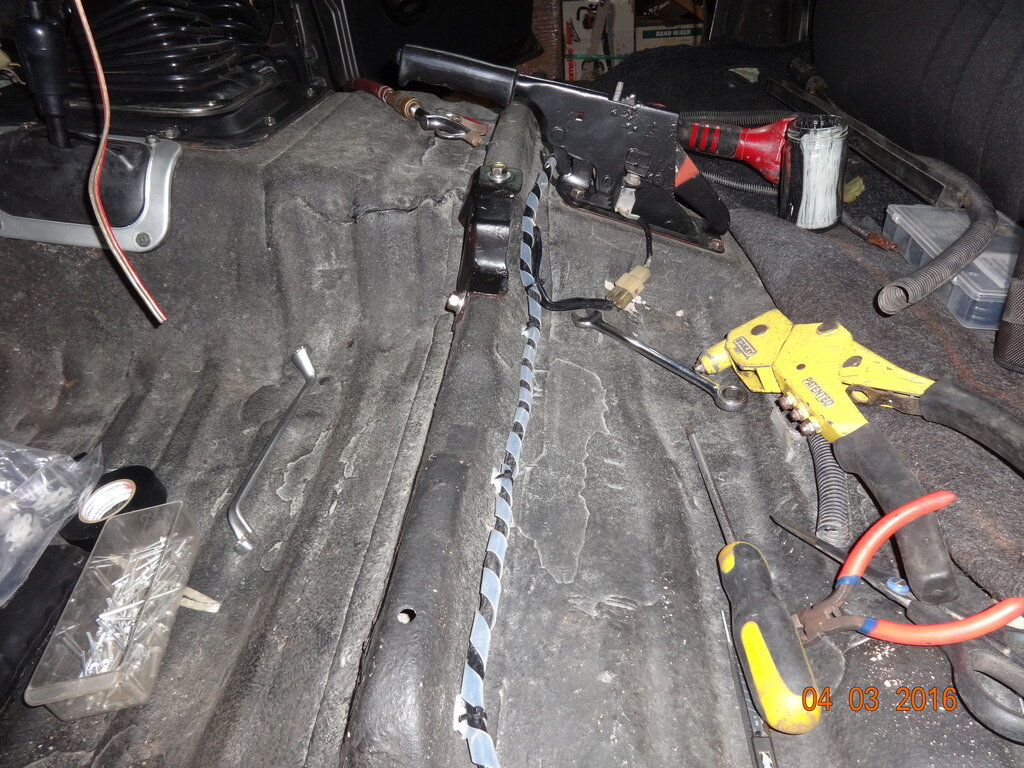

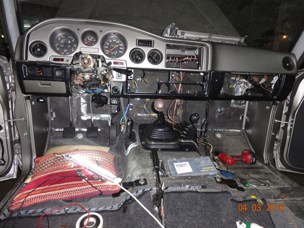

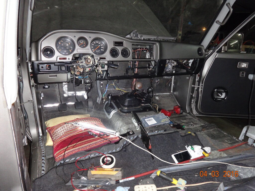

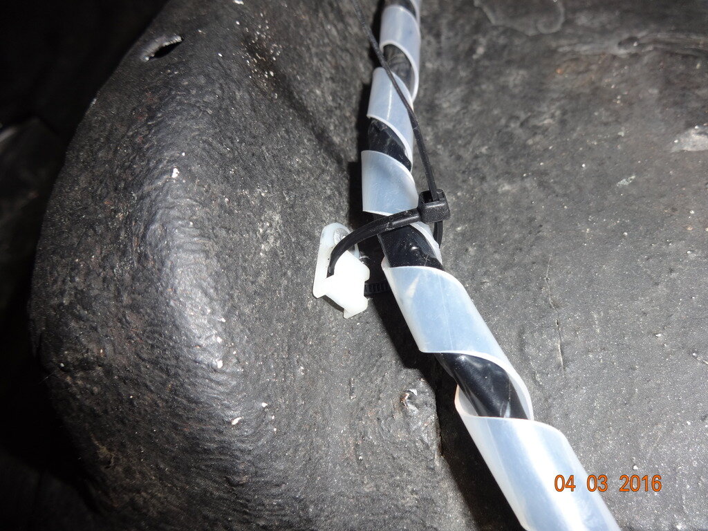

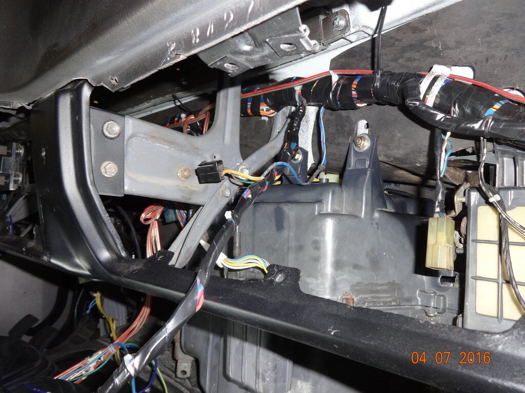

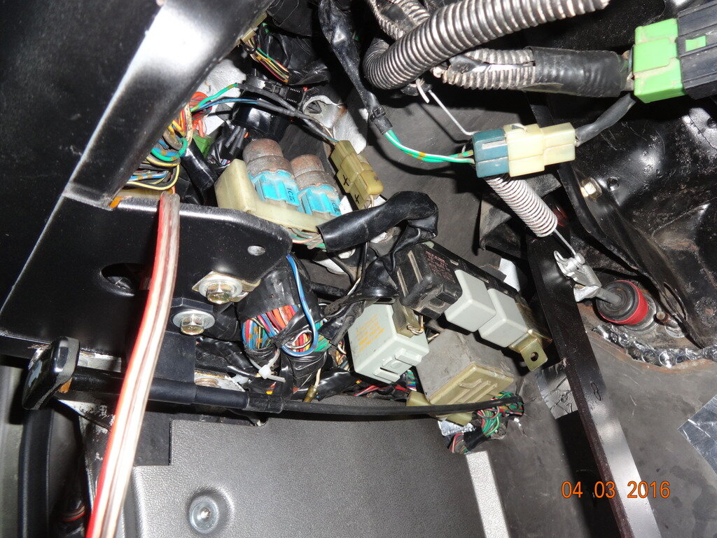

I had to crawl and lie on my back so I can organize the wiring harness behind the dashboard. It was like solving a puzzle trying to squeeze in as many in a tight space. finally got it.

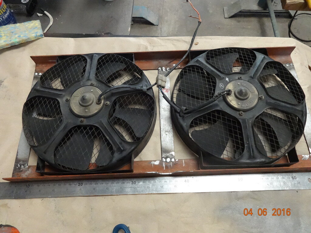

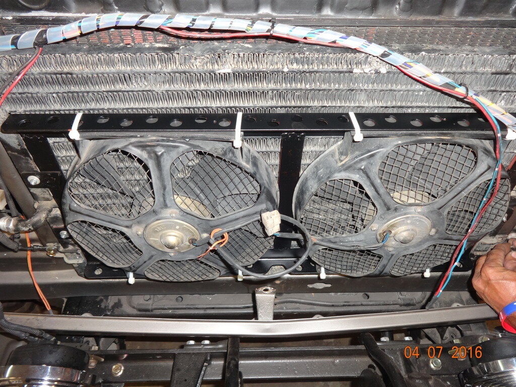

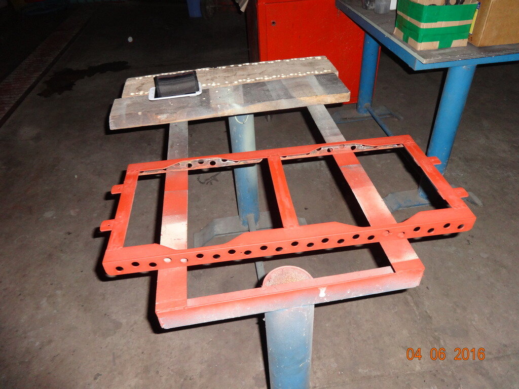

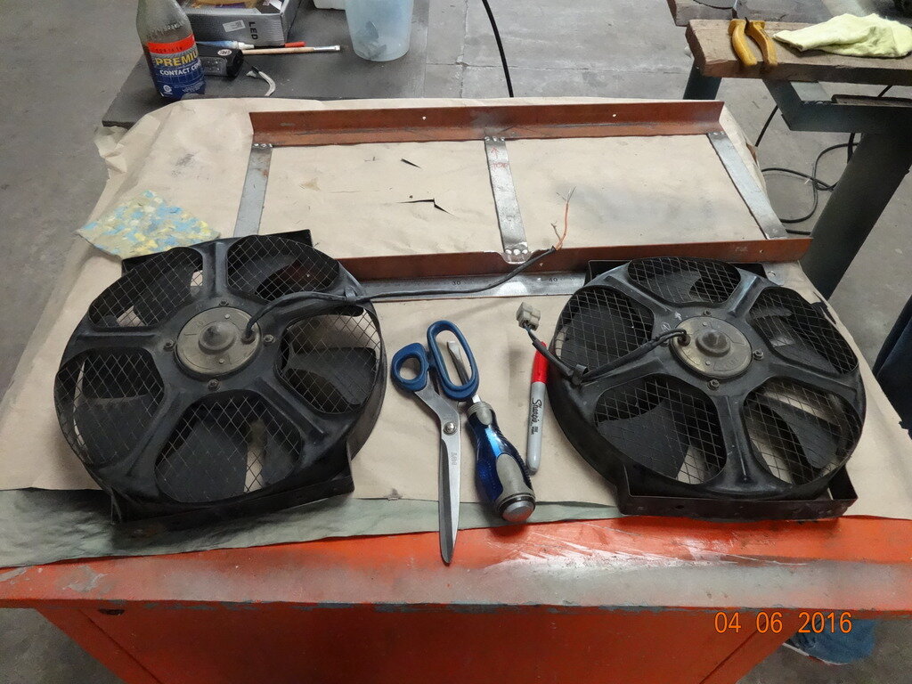

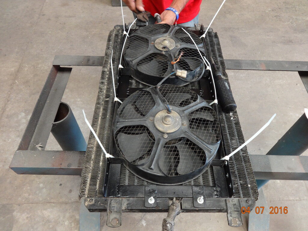

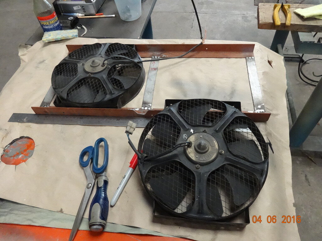

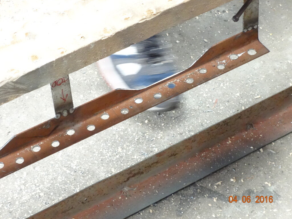

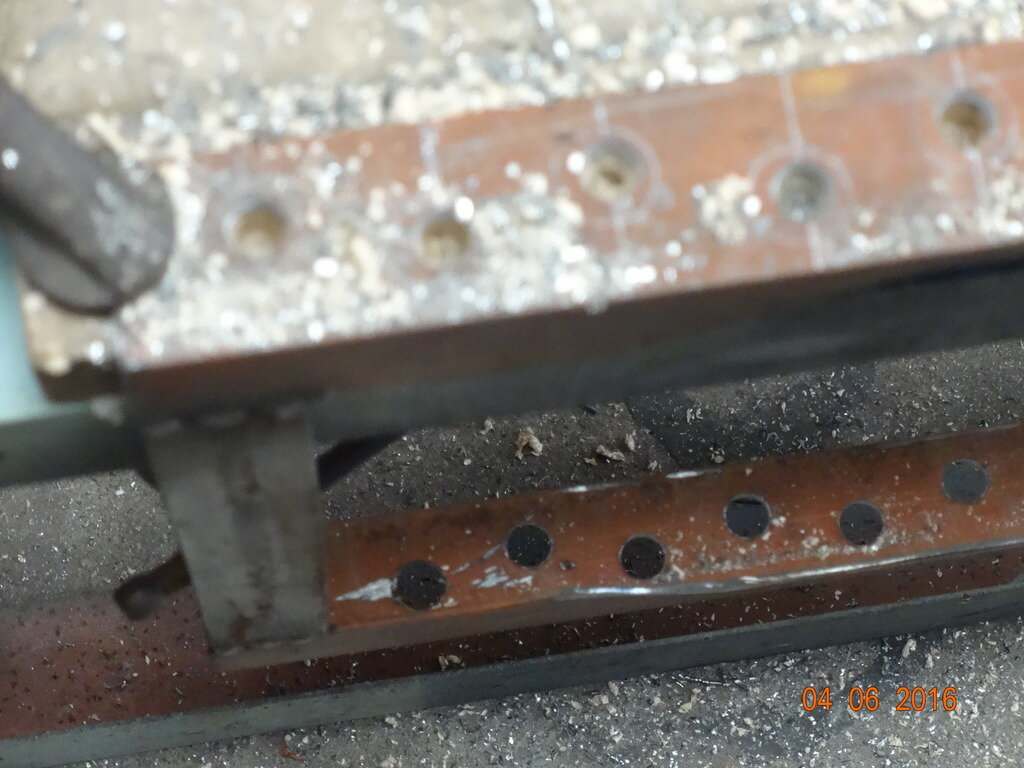

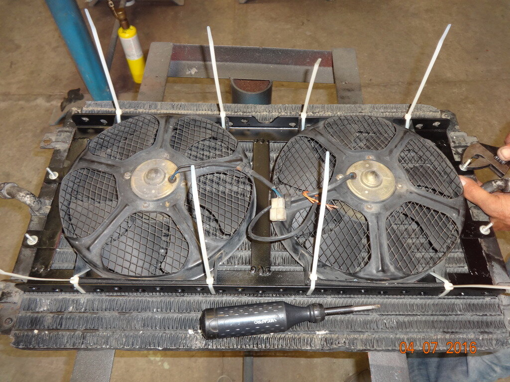

A fabricated condenser fan bracket. Complete with lightening holes.
A coat of red lead paint for primer.
More pictures tomorrow on the finished fan holder. :thumbup:

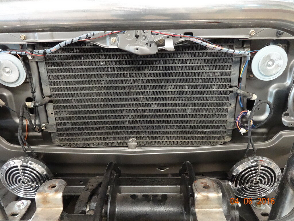

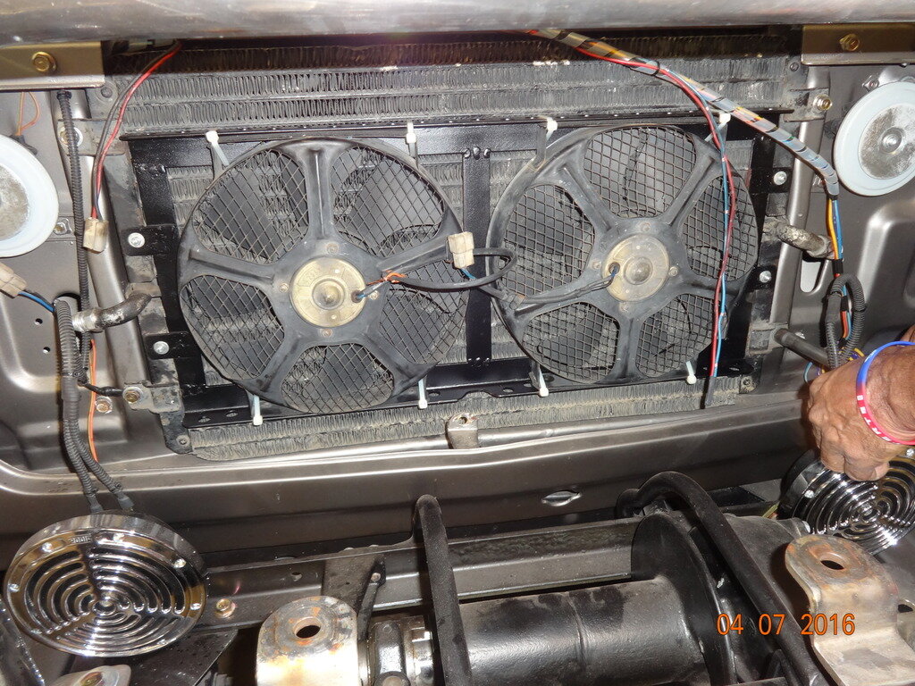

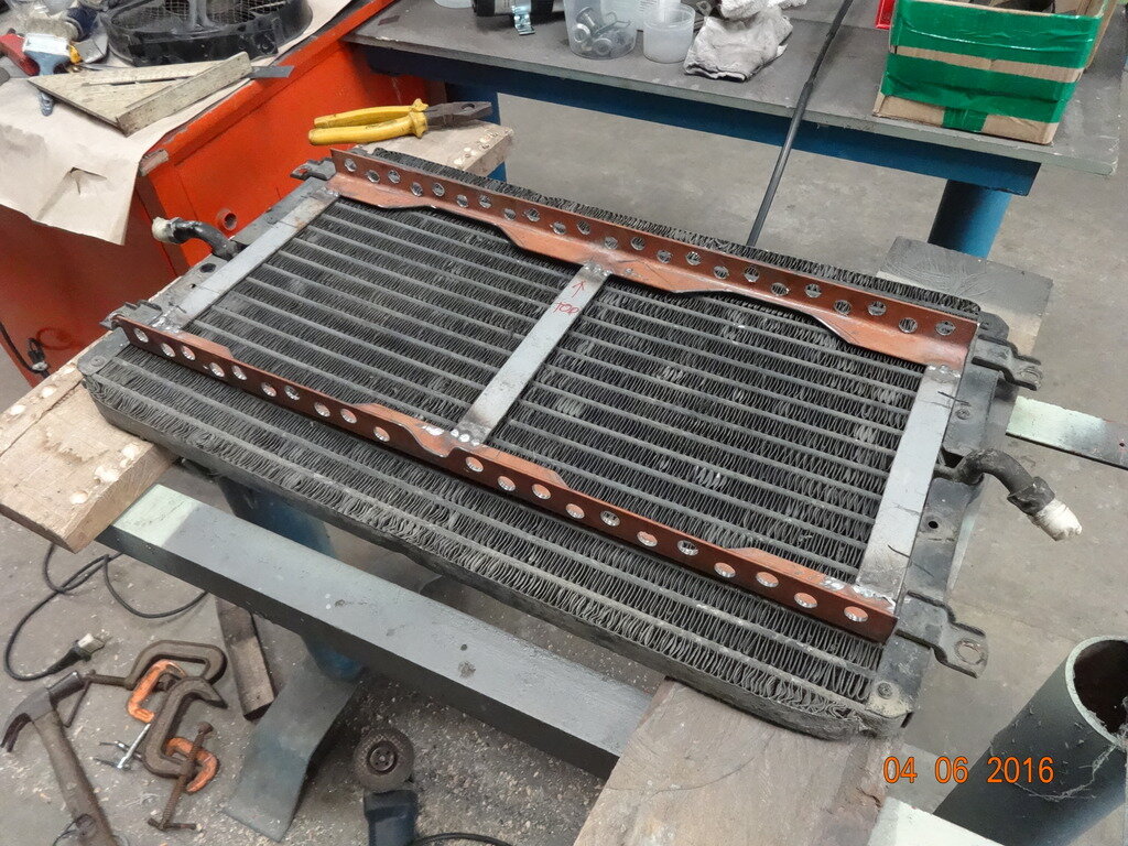

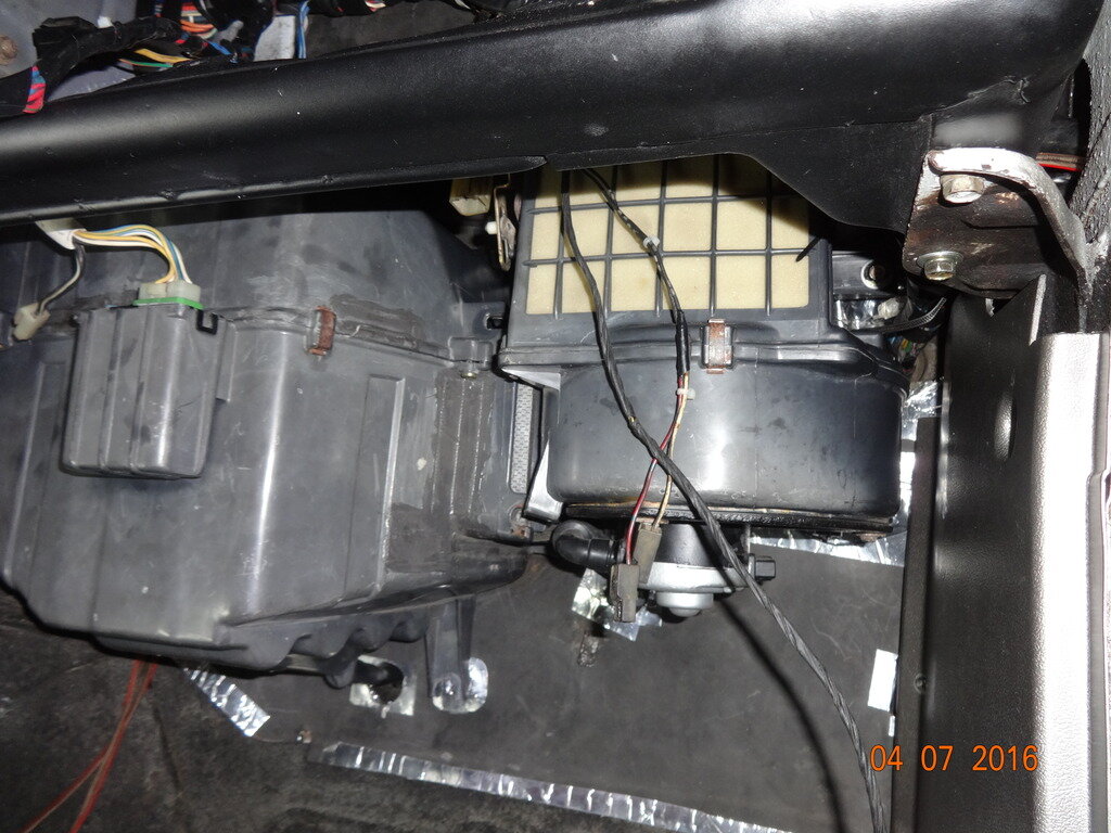

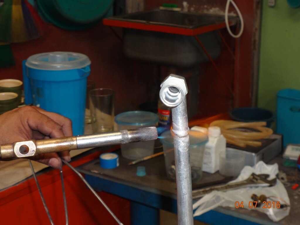

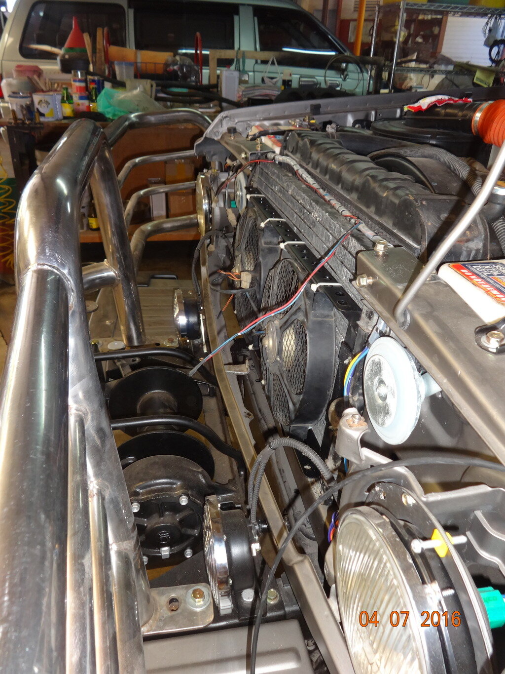

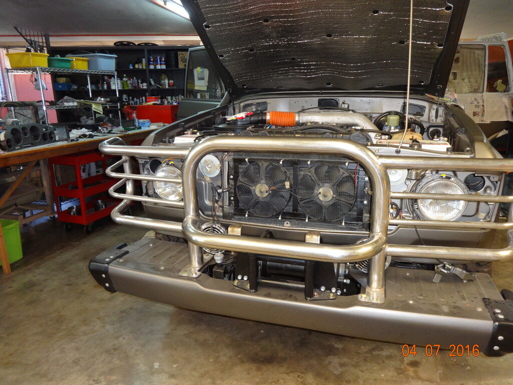

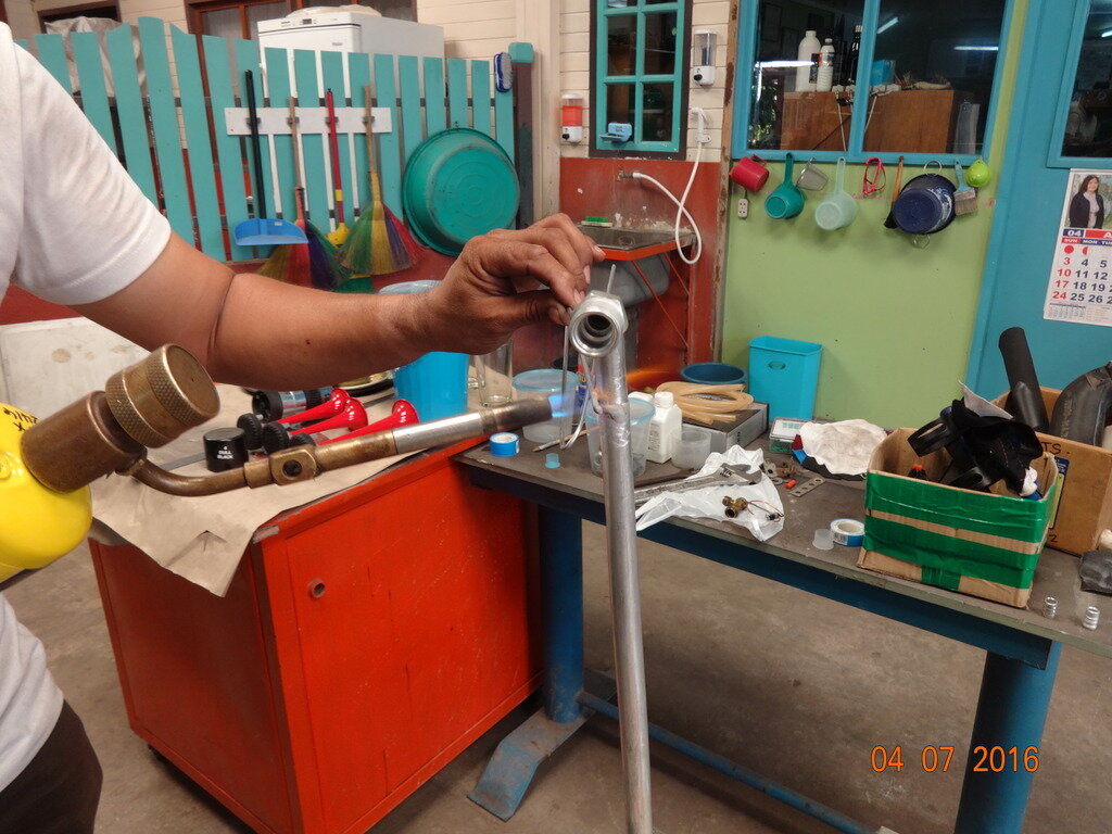

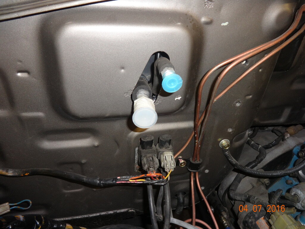

Installed the A/C condenser with fan, blower and evaporator. Laid out the primary and secondary tubes.

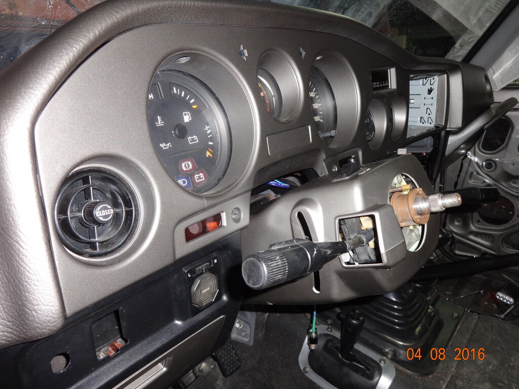

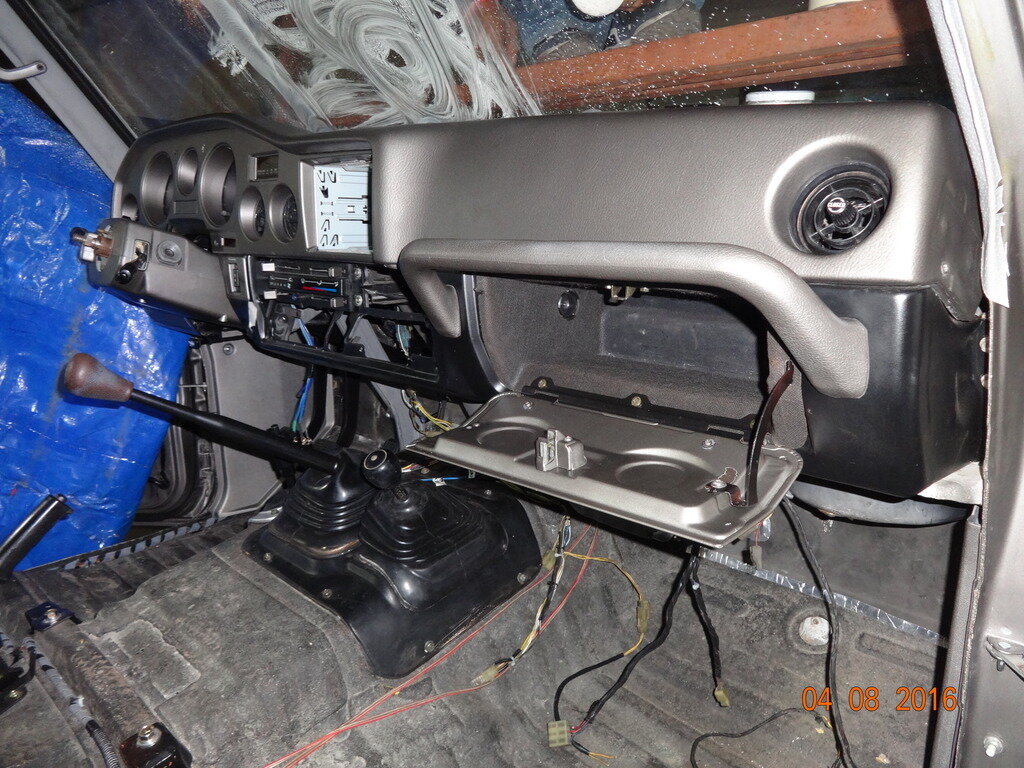

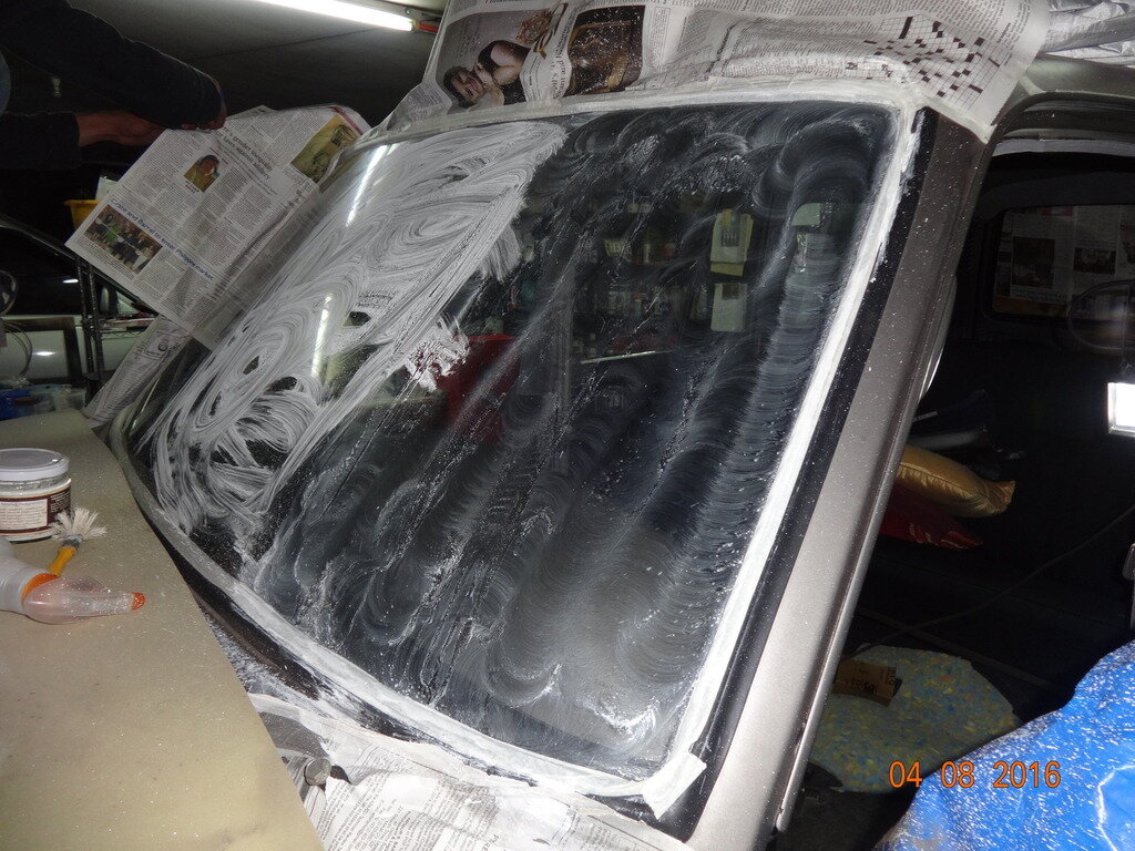

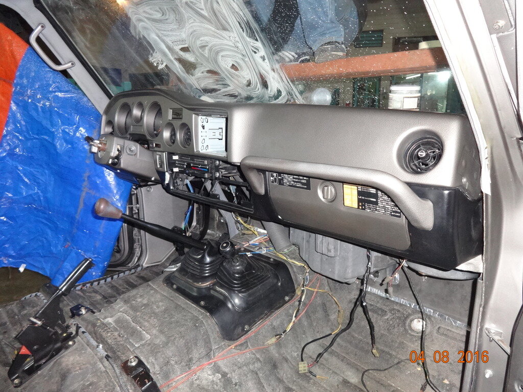

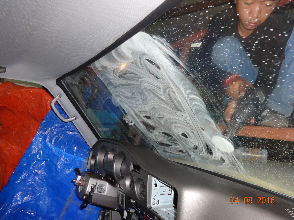

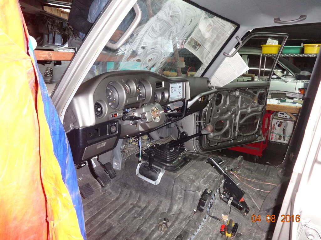

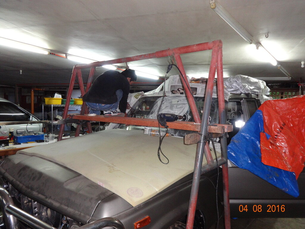

I got the windshield buffed clean from dirt before installing the tints. Also had a chance to install the instrument panel and the glove compartment.
