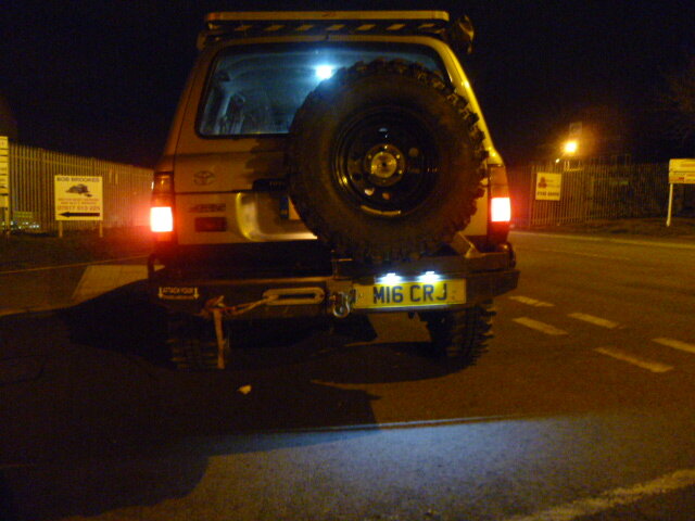

Well we're nearing the end of the build on this. At last. Memo to self, stop working on other people's cars :roll:
Got some natty little LED lights to go on the carrier
Accessed through the back via neat plastic caps
But then the issue was how to power them up given that the carrier has to swing. Yes, I could have mounted them on the bumper over the number plate, but with the carrier open, they were very exposed and I figured I'd knock them off in a heartbeat. I tried the curly flex off a phone charger but that lasted 10 seconds. I decided to give it a rest and put a new liner in the MIG. It had been getting a bit scratchy. Sorted.
Now if only I could find something to run the cable in that was flexible, strong and could be secured at either end. Hmm, ideas idea. Nope not a clue. :think: :think:
HANG ON
MIG liner???? :idea: :idea:
Yep, made a little clamp to take one end, threaded the wire through the middle
And put a clamp at the other end too
And there we have an indestructible flexible conduit.
Did a bit more fettling on the latch mechanism, which works absolutely brilliantly by the way. Very easy, very secure. (Patent pending :whistle: )
And voilà, Bob's yer Mother's cousin as they say.

top marks Chris, that looks fantastic! :clap: :thumbup:
looking forward to seeing it in the flesh. :)
I know how much time is involved in making stuff mate always swallows the hours up. Does look good.

Cheers Carl. This one actually went pretty much according to the plans. Plans - well I say plans, I mean I didn't hit too many 'Oh fook' moments in the entirely bespoke build.
Some may call that blind luck. I wouldn't argue. Much. Actually at all. :lol:

Sorry Joe, lost me. What obscured lights? Do you really think I would build something like this and obscure any lights?
Number plate clear - check. Illuminated - check
Brake lights - check
Side lights - check
Indicators - check
Fog lamp - only one required - check
What am I missing?
Chris
Sorry Chris i was just pulling your leg as the uk colorados had to have low level lights because of the spare wheel.
Joe
Ahh you had me worried there mate! Of course I did a rear bumper for a Colorado if you remember and that had low lights in there. So much easier in an 80! No fancy plastic.
Had to work out the dimensions so that I can get the 37's on there without blocking the lights.
Chris

Actually, in truth I am not sure what to do about the OS fog light. It's not fully obscured with the 33" tyre on, but just about. With the bigger tyre on, it will be. Now I can go for an MOT with no tyre on and nothing is covered at all. But as you only need one fog light, what do I do if I leave the tyre on? If it's there but not working, it will fail. If it's there but obscured, I am guessing it will fail. If I blank it off - I am guessing it will be ok?
Might pop into my local MOT place and ask them. Stupid really. How often do I use the fog light on this truck?
