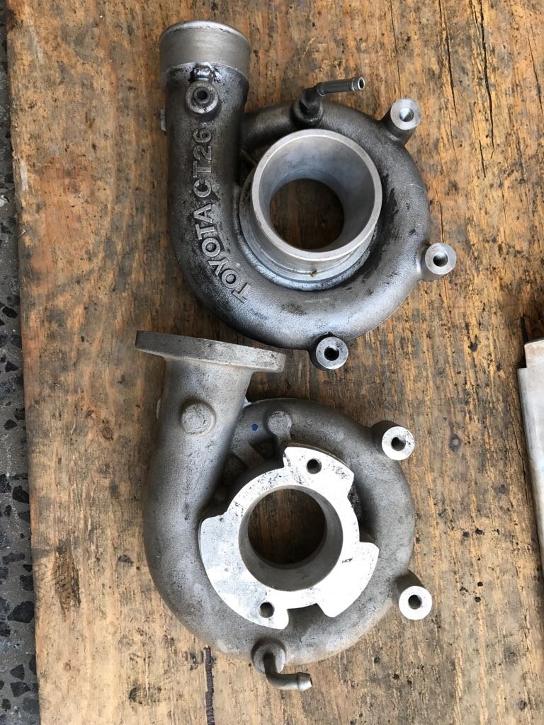

Have made a few mods for performance gains including top mount intercooler and 3” custom exhaust. My next mod is a larger EFI front casing on the turbo and compressor wheel to up the boost.
These are the most common mods most do because the 1-hdt doesn’t have a electronic tuning brain.

Yes it does make a difference if towing or having to pull uphills etc. Certainly it pulls better but would need to drive another stock form to see any difference as we kinda get use to things after a while.
Having the larger casing I am having to make a adapter so the stock air intake hole will fit the different housing. I'm hoping to do this in a month or two and be interested in seeing how yours turns out.
If I had to do these in order I probably do this turbo first then exhaust and then intercooler if need be from my experience. These all tend to cost a far bit when adding them up...lol

I won’t be doing anything with this for a good while just looking for info as I’m doing a full restoration on my 80 at the minute I wonder could you just get a silicone hose adapter or something similar to fit the new housing?
I'm not sure at best as my mechanic has done this before quite often. I know somehow its going to be machined probably the exhaust inlet being cut to suit but far importantly for the air intake a adding a piece to attach the existing air duct too. Hope that makes sense with the illustration. Will know better when I get it done and will do a write up to share.
