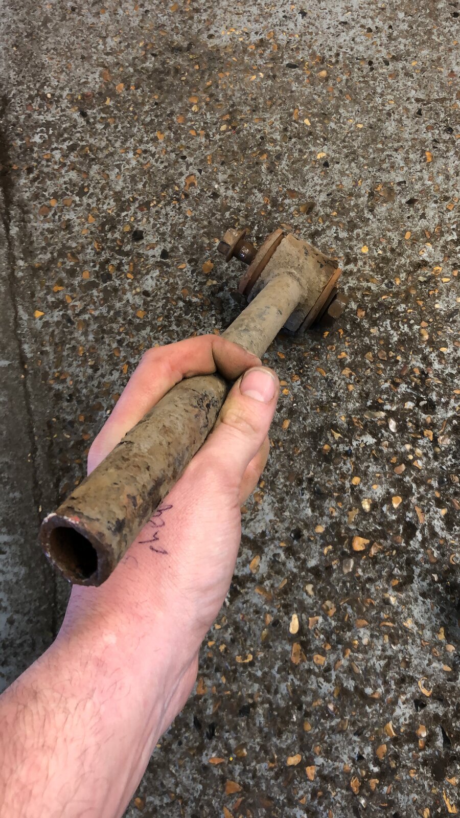

I snapped both upper arms on my 100 series back axle !
Broke at the weld, not seen that’s before !
Two news ones fitted all good, I suggest if you do a lot of towing like me and or have a very high mileage car inspect the upper arms for cracks.
