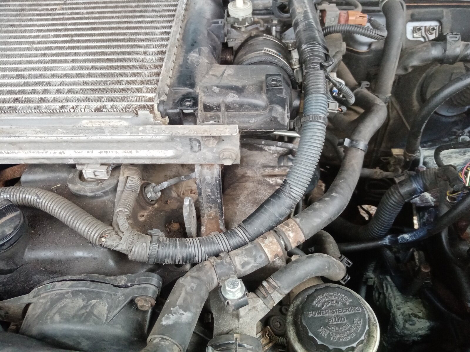

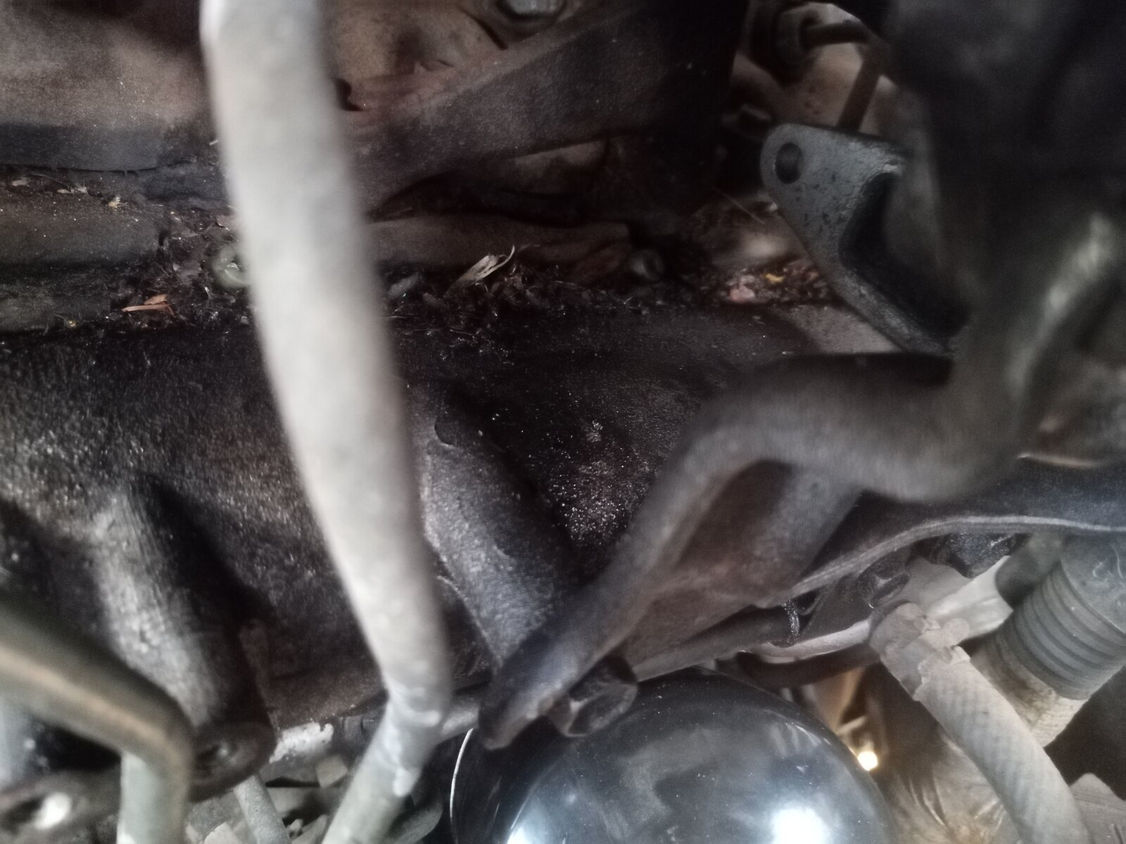

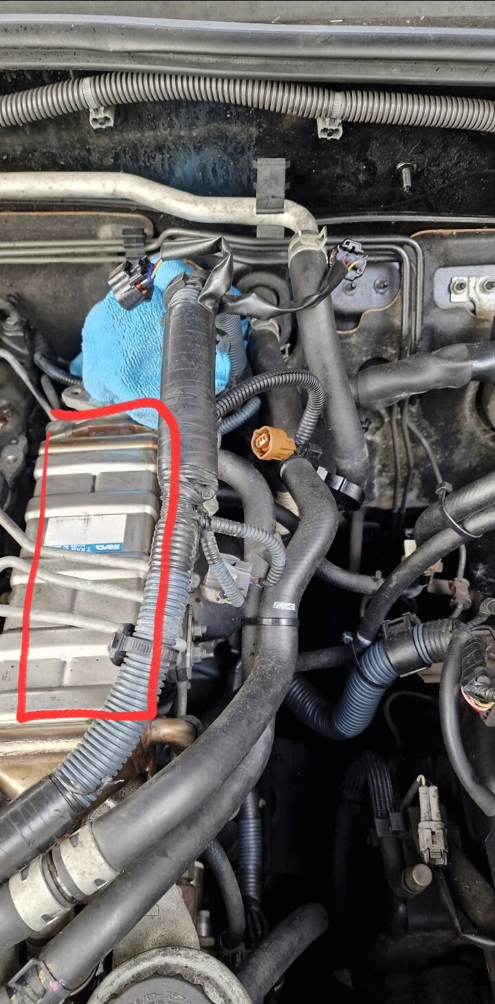

I've took the cover off to look for the oil leak it's damp under that black pipe in the picture.
It also looks like I'm missing a part there's a flange that looks like it needs a part bolted to it or a cover plate surely it's not just open like that it's also caked with black gunk on the inside the flange.

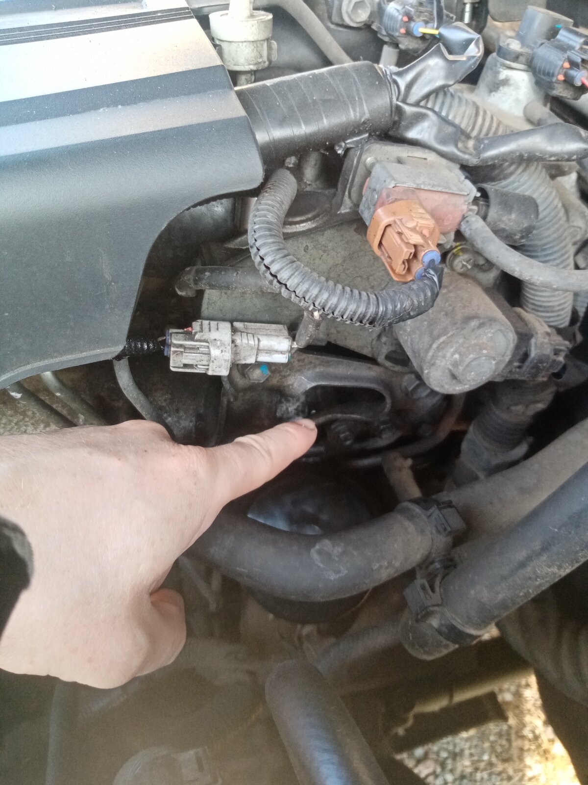

Where is that second photo from, can you zoom out or give a bit more context?
Thats just under the black pipe I've my finger on in the first picture in the last post.

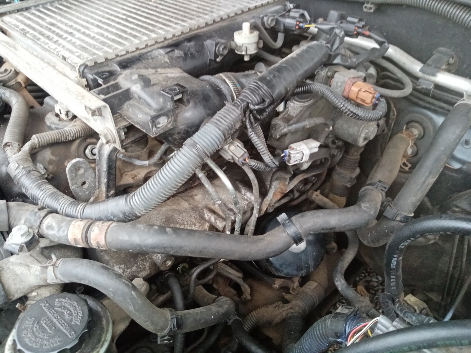

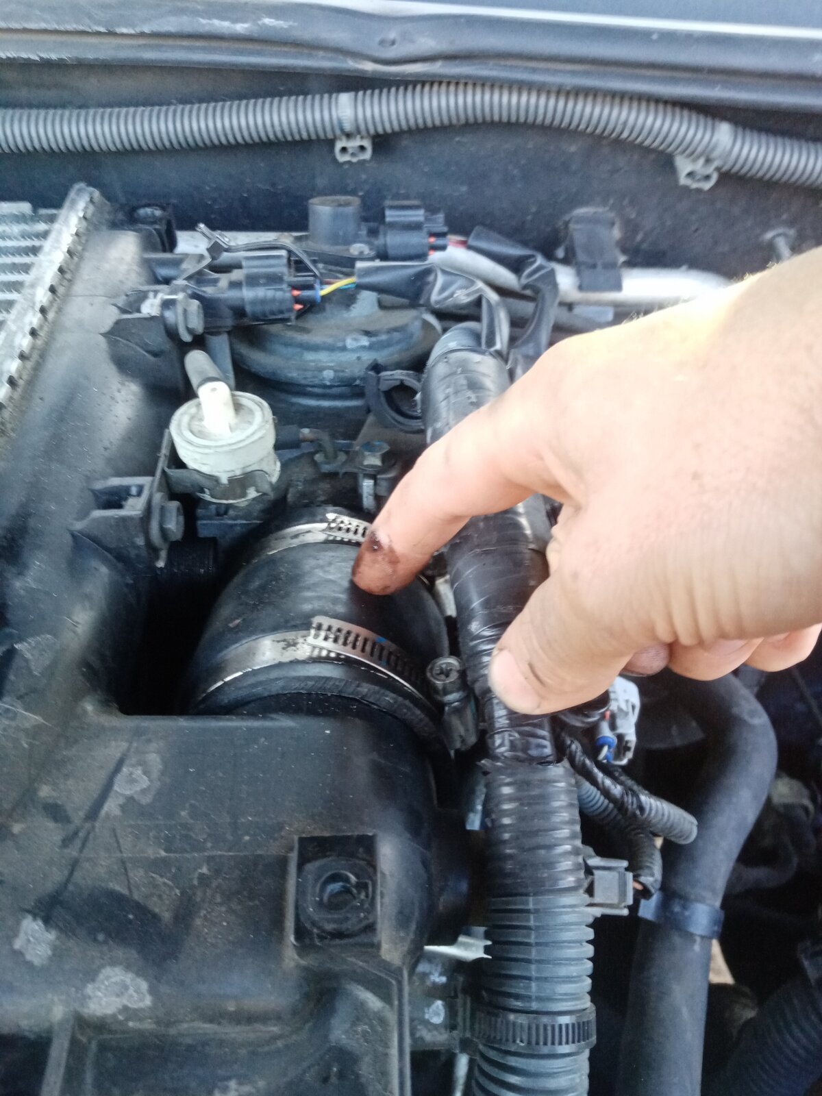

I've added some more pictures. Could it be missing the egr cooling pipe?

This is the EGR cooler - have you got that?!!

Unbelieveable !
Obviously previous owner didn't have a clue if the cooler has been removed leaving open orfices, and I'm surprised it ran properly.
I would check the brakes if I were you NC3.0, to see what else is missing ?
It's hard to get a proper picture here intercooler in the way.
It's missing alright.
How the check engine light wasn't on with a bit missing is puzzling.
Only I'm taking a interest in this machine I would have been driving away with that hole from now till gods knows when.

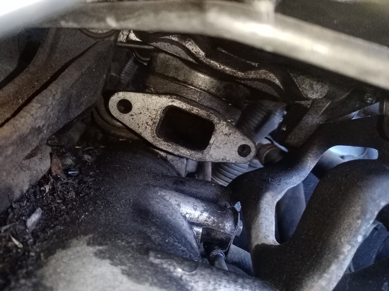

I went looking for a leaking pipe or gasket and found that flange with nothing bolted to it.

So your egr valve has got a similar flange on the bottom of it wot normally bolts to the end of the egr cooler - is that open too or is it blocked?
I can't really see in past that flange.
I did try to pry at it, seems on firm like it's bolted.
I can't see were the egr coolers other end connects to there's no hoses hanging about or openings I can see.
I'm going to flick through the books for it that are on the fourm link just to school myself on how it all works.
It's going back to the mechanics on Thursday morning and I've sourced a egr cooler for it just need to make a list of what parts we need before hand.
I'm interested to know why someone would remove this part and leave that open seems crazy.
