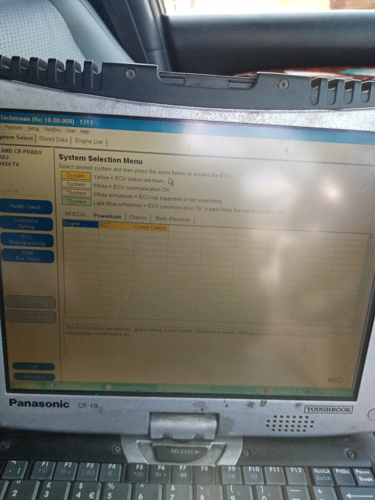

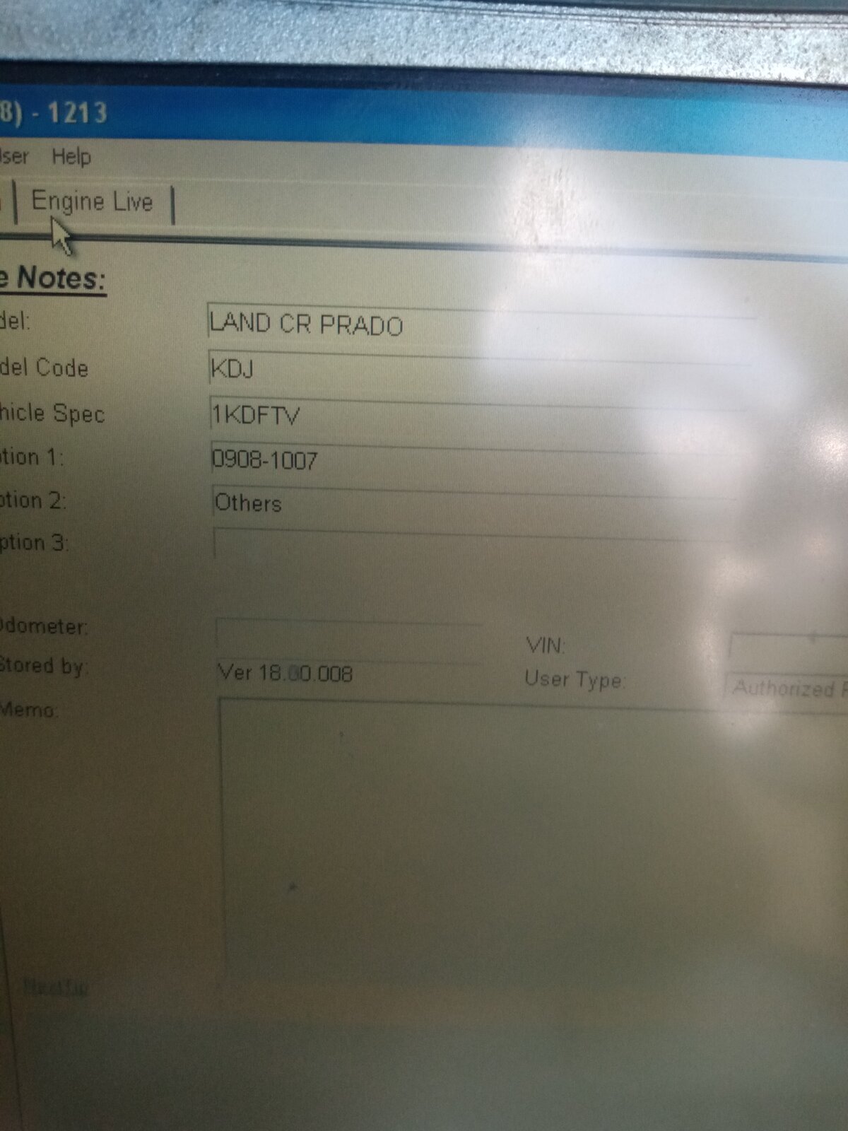

Techstream setup I'm stuck at the open page basically with no clue.
There's a few drop down menus I know the engine is a 1kd-ftv but there's a few other options on the drop down I just selected one and tried my luck. I can't get any live engine data just yet.

I think you double click on engine to get into the engine ECU
Then I think theres a live data button on the left? (From memory, havent used it for a bit!)

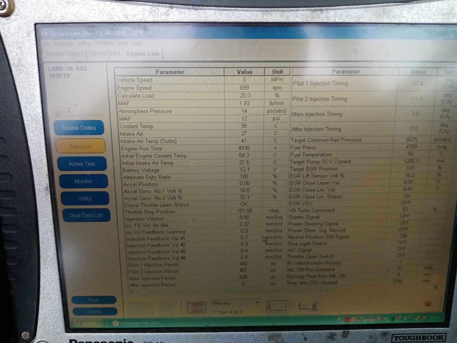

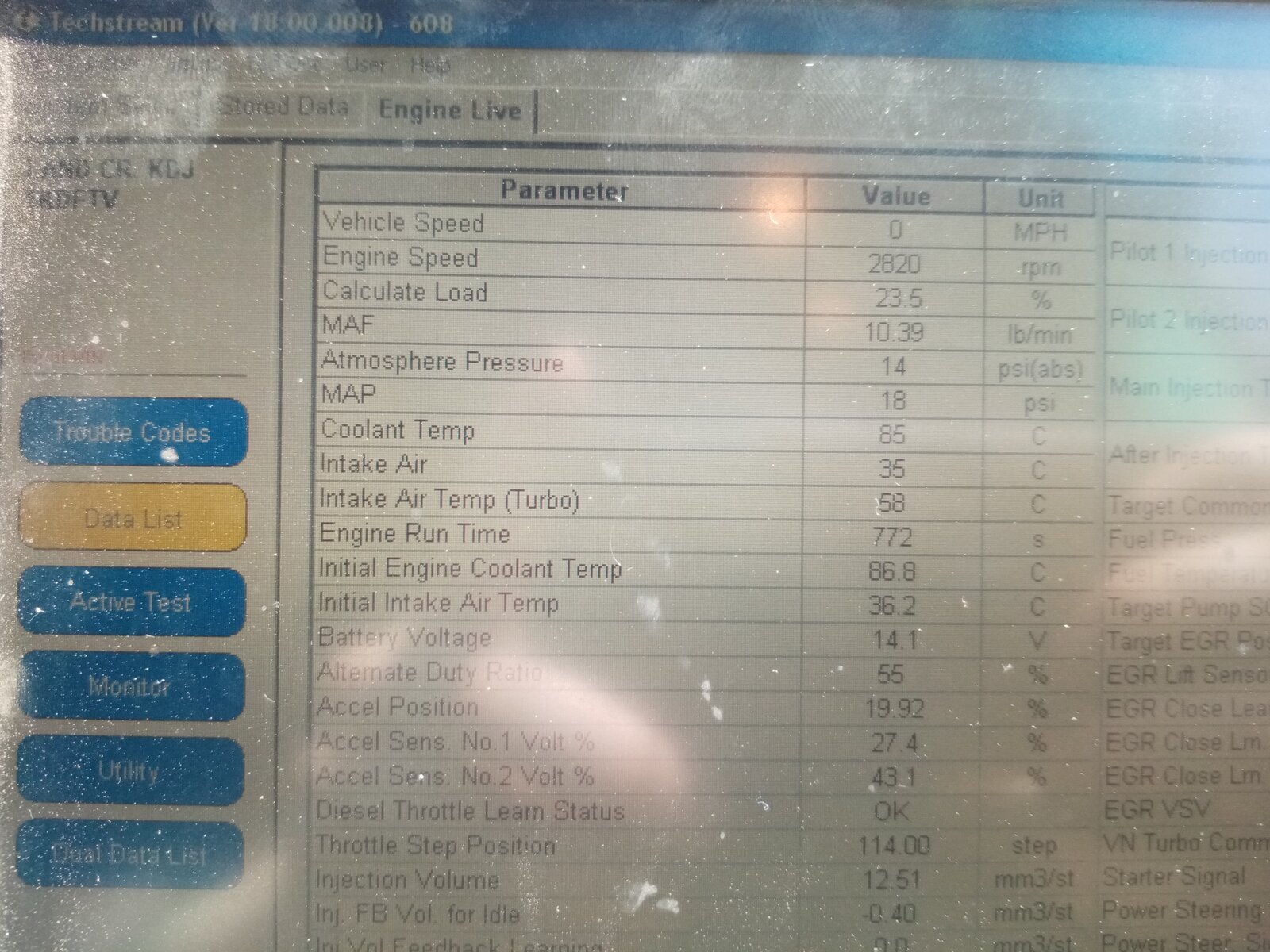

Think I got some data up here.
It shows some injector data no idea if its good or bad.

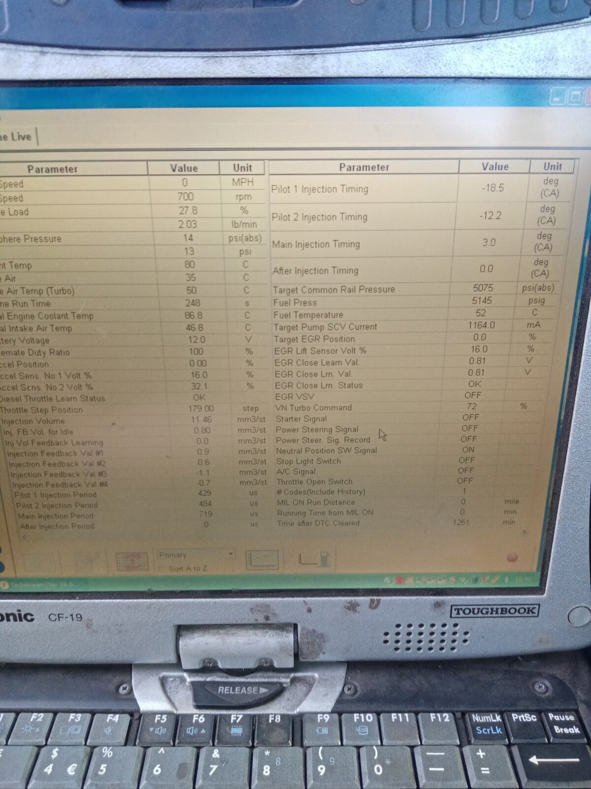

Make sure its fully warmed up before you check, coolant at 82/83 whatever it is, then try and get a clear pic of that whole screen
The coolant was at like 86 I think,
what should it be?
It was hard to get a picture there without glare hence the shit angle. il try again at night can't be any glare then.
There could be a output to pdf on it somewhere that be handy.
I think the coolant is 80 on there? Needs to be 82 or 83 I think.
Pic doesn't need to be perfect just try and get all the numbers in, or take two pics one of each column of numbers - they're all handy to see.
Also make sure engine is idling, everything is turned off (lights. Blower, Aircon, radio). Is it a manual or auto?

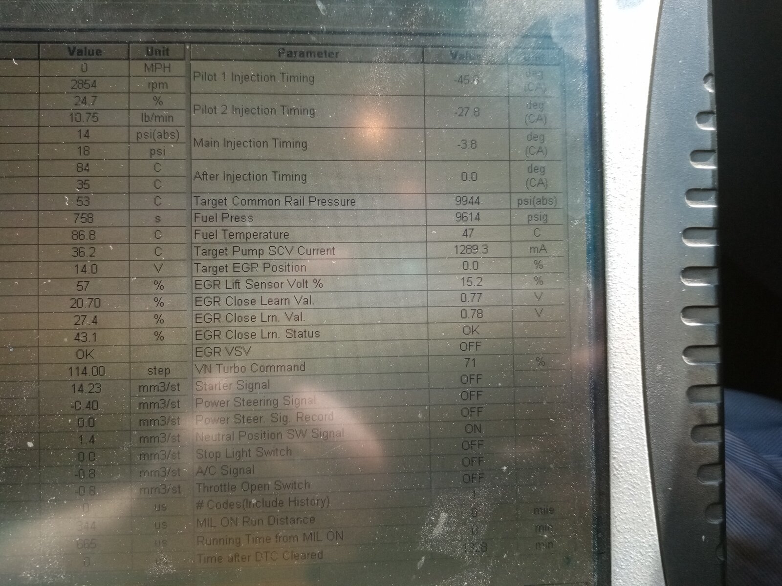

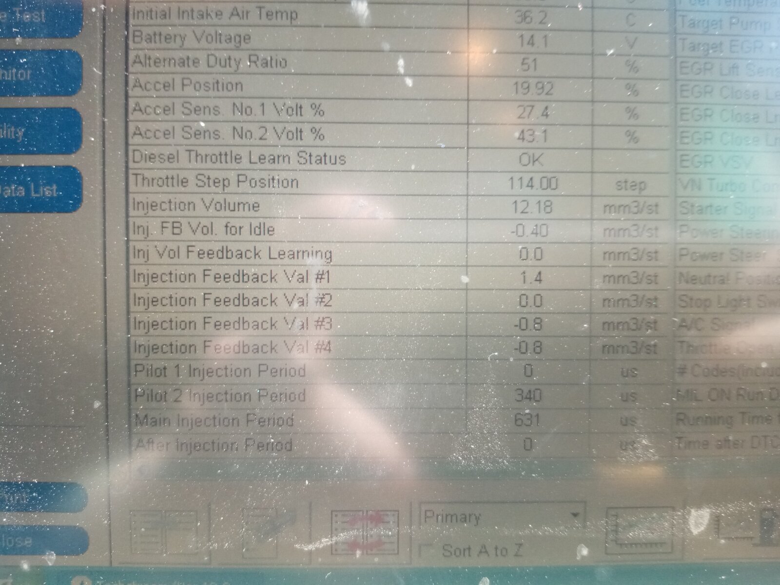

Think I've got some readings when the coolant temp over 80 had to rev it a bit to keep it there.
Had to take a few pictures glare is awfull.
Pics look alright (we can make the numbers out!) but it needs to be idling to check the numbers, so cant be revving it up. If your coolant doesnt reach 82/83, is your thermostat opening too early? If 80 is the highest you can get on idle, post that and we'll have a look!

These readings are after a long run out.
The coolant temp seems high.
The heater in the cabin is blowing cold air.
Checked the coolant tank at the side of the radiator nothing in that so I must have a leak somewhere.
The gauge in the dash for engine temp hardly moves.
