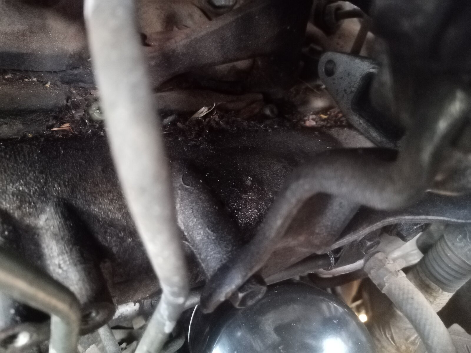

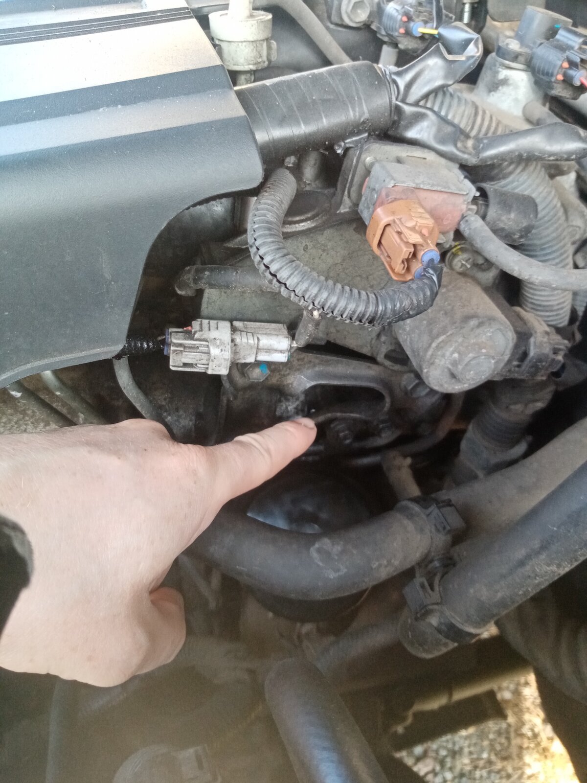

Where's your oil leak? (Just out of interest!)
Not sure what's that's called but I've cleaned it a few times and it's still damp and reappearing so a small oil weap, so it's kind of suspicious to me oil should be on the inside of the engine unless it's in a gallon jar.

In the first photo, is that a bit of white string I can see, securing a hose ?
It maybe reflection off a shiny spring clip, but check that and the hose there anyway. The only thing roughly above that is the egr valve which may have a leak, they collect quite a bit of oily black s**t.

Checked for string couldn't see any.
Thats what it started as black tar like gunk and now its just light oil like only just damp to the touch.

Take the plasic intercooler cover off and check around your egr and hoses for any leaks.
