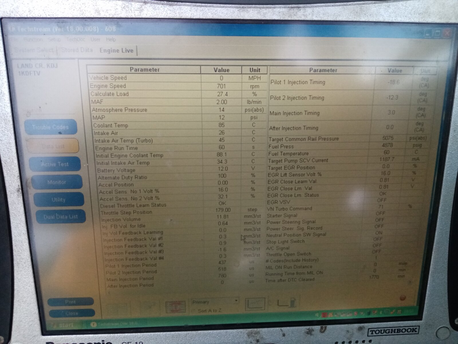

Check injectors?
This was taking about ten minutes after with the engine off.
The coolant temp dropped down.

I think the coolant leak is the main thing to sort here! Is your header tank totally empty? Get that sorted before you cook the engine!!!!
As for injectors, had a look at the first set of numbers (with the high temp) and I dont think they look too bad. Your calculated load is 20%, on new injectors its supposed to be about 11-12 I think. So the engine is working harder. Injection volume and main injection period is higher than it should be, but everything else looks alright to me - so as Mr fourby4diesel would say, not catastrophic but start saving!

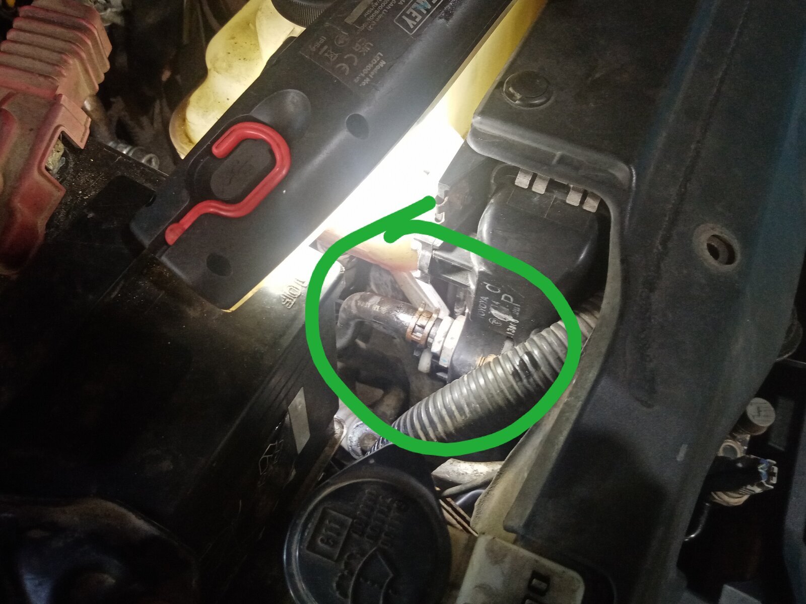

Header tank to the left of the radiator empty!!!!

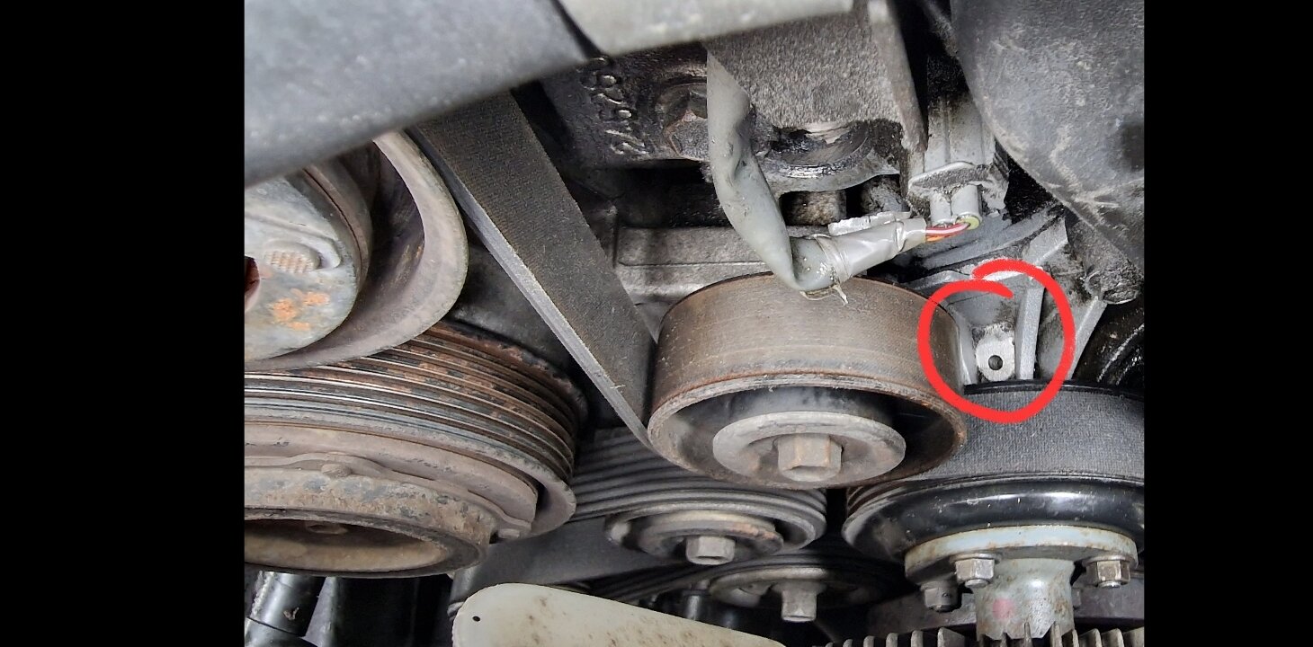

I checked round that water pump.
Can't see the weep hole on the top of this water pump. Picture attached.
The header tank seams to let out like a bit of air like a puff wheni shut the engine off almost like it's wheezing is it not a closed system.

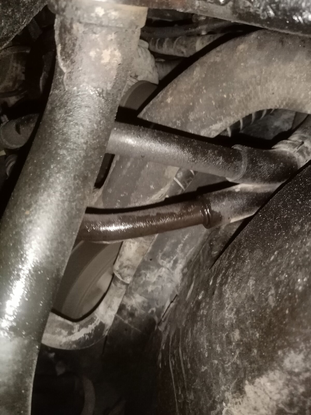

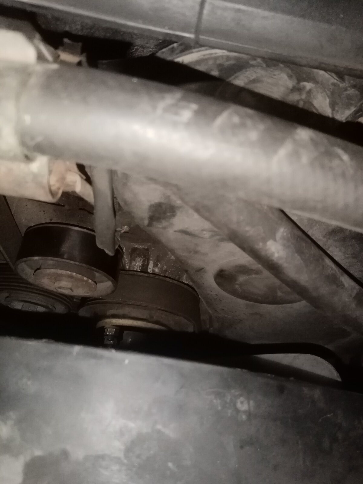

Found a leaking pipe underneath also it's oil looks like a clip is missing.

It's a closed system but it's under pressure so you can expect a bit of a pop/wheeze when you take the cap off.
Also the header tank caps do fail on these, you can pressure test it but they're cheap enough

It's wheezing away with the cap on every 3mins it let's bit of air out I only heard it after I've shut the engine off its faint.
The oil leak is underneeth one pipe coming from around the big fan cover.
I pushed the pipe around and it started to drip more. Might just need clip?

If your hearing it with the cap on id replace the cap - it might be releasing pressure too early.
I can't put those hoses in context - can't see underneath mine because the bash plate is on. Is that big hose the bottom hose from the radiator to the engine block?
You think oil is leaking from one of those hoses? Any idea what kind of oil it is?
There's also a smaller diameter hose between the header tank and the engine block - worth checking that for leaks. I remember taking that off (and the bottom radiator hose) when I changed the coolant

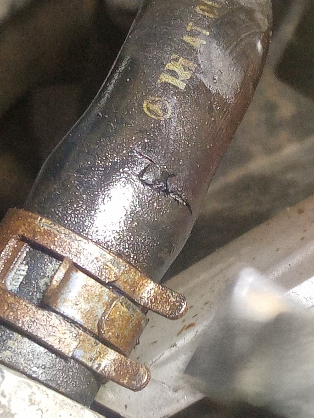

Poked around that pipe more leads up to the radiator to left hand side.
Looks like a tiny crack and a very small leak.
The over flow spills over it and thats why I thought it was damp. Plus there's waxoil and lanogurad all over.

That looks like one of the ATF cooler lines I think? Might be worth checking the ATF level once you've replaced it!
That pipe leads down close to the transmission along with another one.
Il get the fluid atf oil checked we did change the fluid there back a few weeks.
