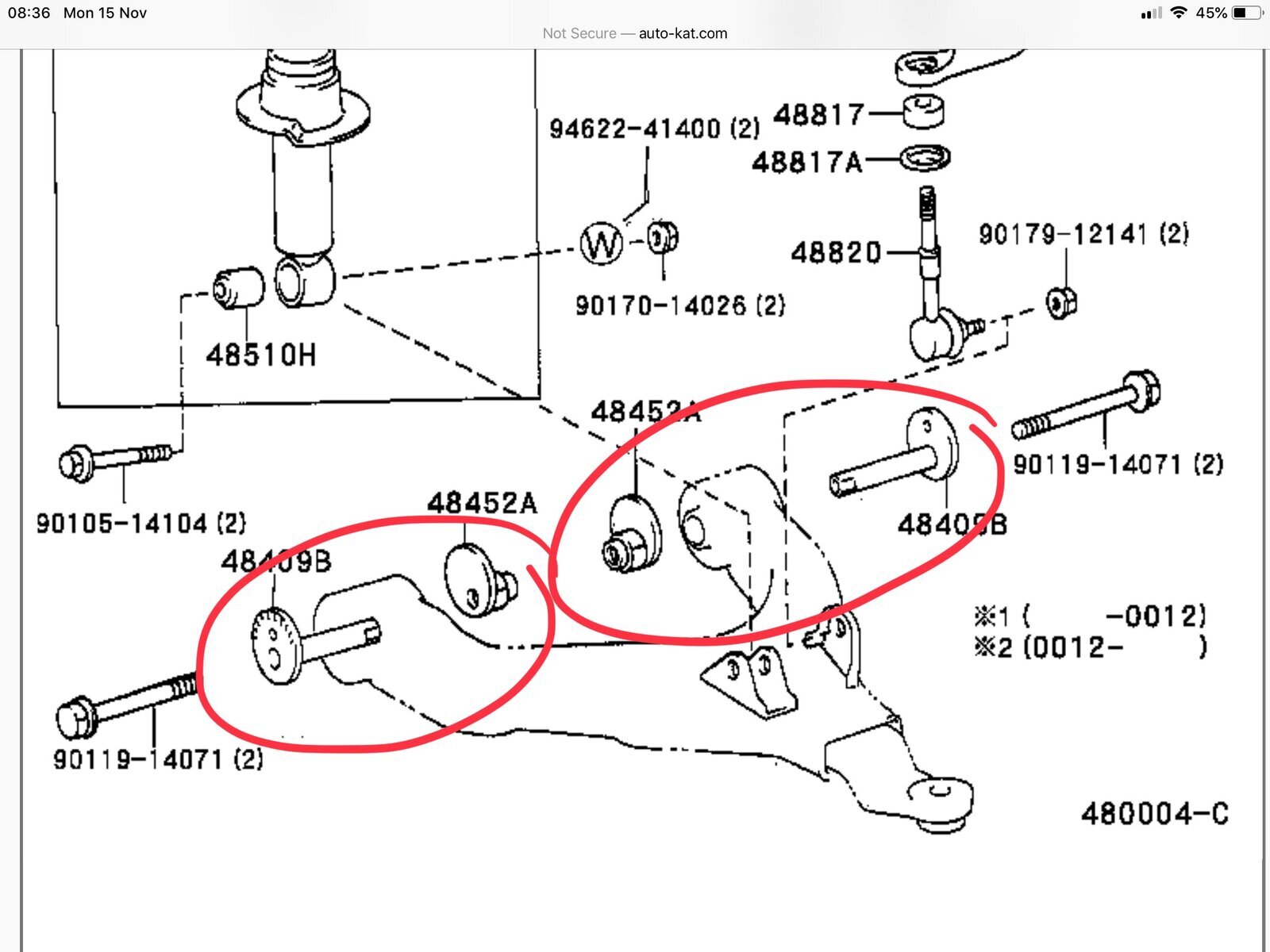

Just been looking on the parts manual for a 90 series, is this them on the lower wishbone ? Assume I adjust together for camber / toe alignment

Not much in the way of camber anyway so it will adjust your toe more than anything which can be put right with the track rods .
Though i wouldn't bother yet if you plan to add a lift or change wheels in the future .
