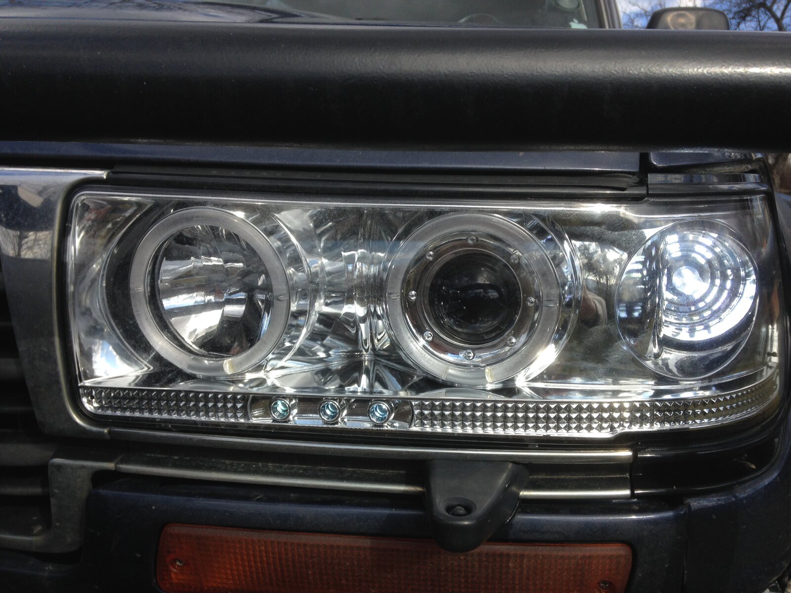

Please excuse the state of the grill ....
Looking good Clive.
I've got the black version of those on my 80. ..... I've used the corner (side lights) as the main indicator and the LED angel eye rings as the side lights....

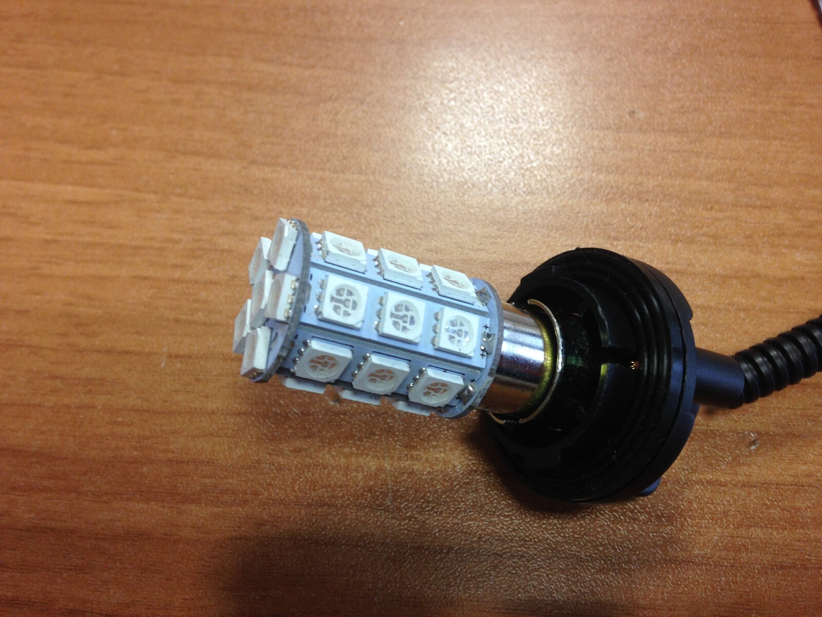

I've decided to go with white side lights, only because I already have 3 indicators each side. They will be 27 "plate" LEDs like these...
Should be bright enough :lol:

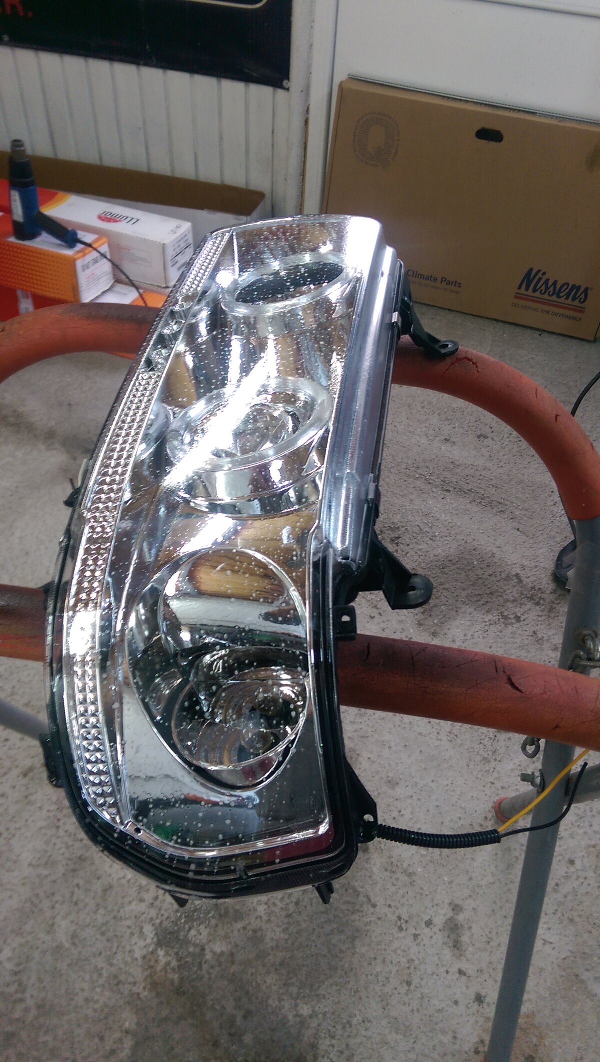

First he found one of the plastic mounting tabs had broken in transit, not a big deal, some plastic cement and a small reinforcement plate bonded on cured that.

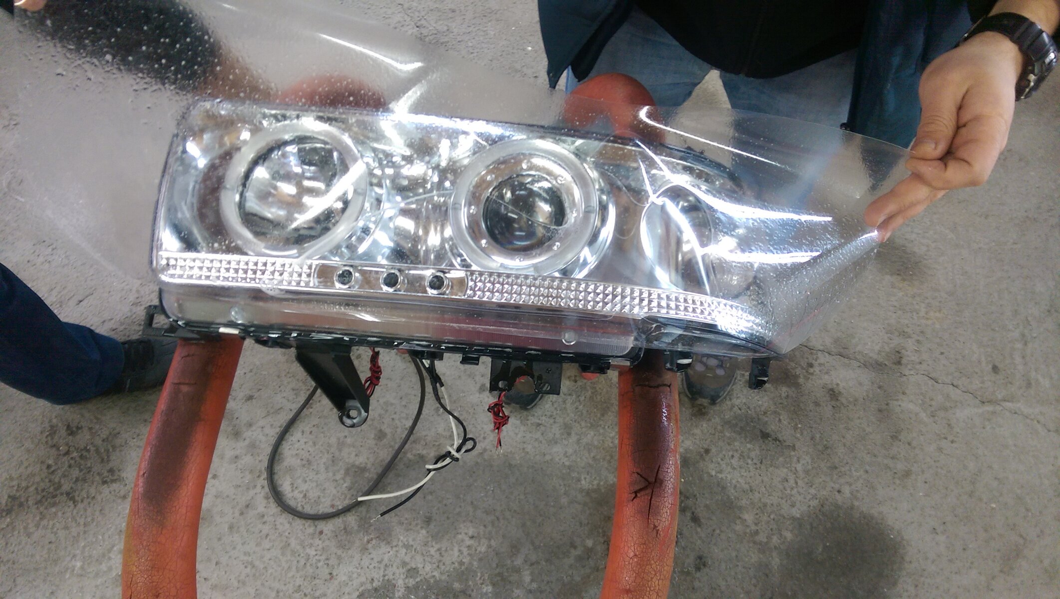

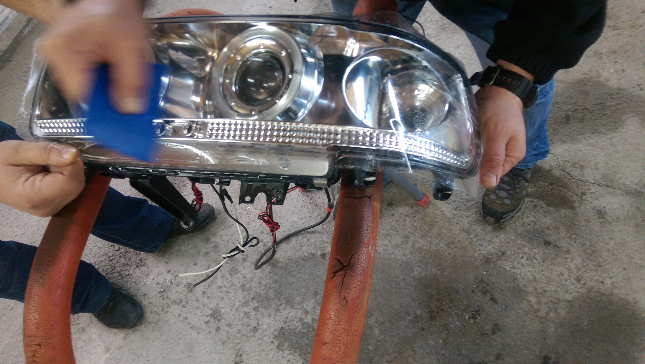

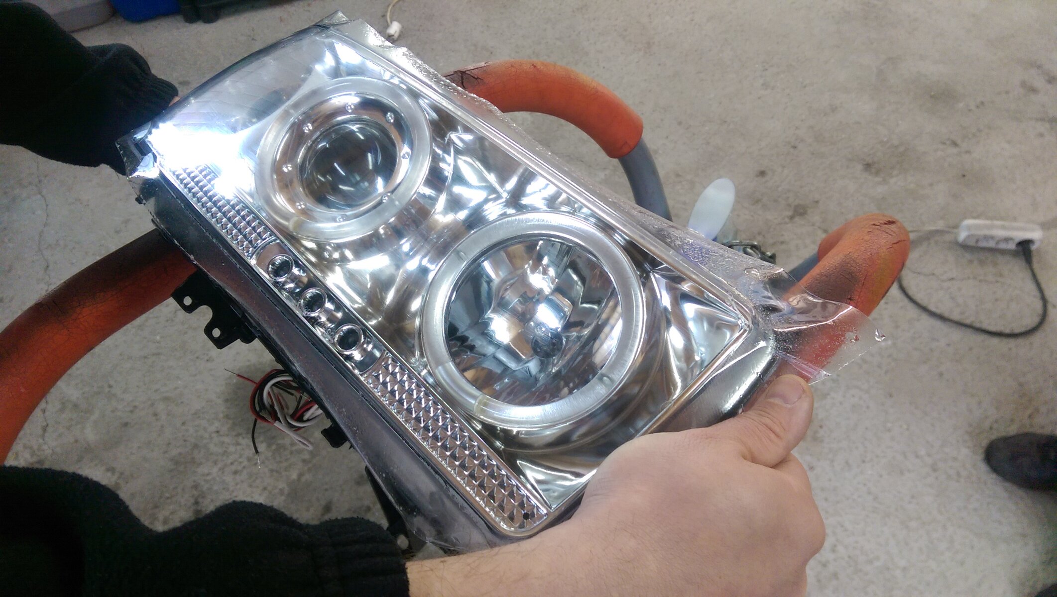

So, the next step was to wrap the units to protect against scratches. These are obviously plastic lenses, not glass like the OEMs, so some protection was called for IMO. Down to the local wrapping shop went Cris, lamps and camera in hand...
The wrap is as good as invisible, and there's no "open" ends that would likely peel back over time, he did a good job on them.

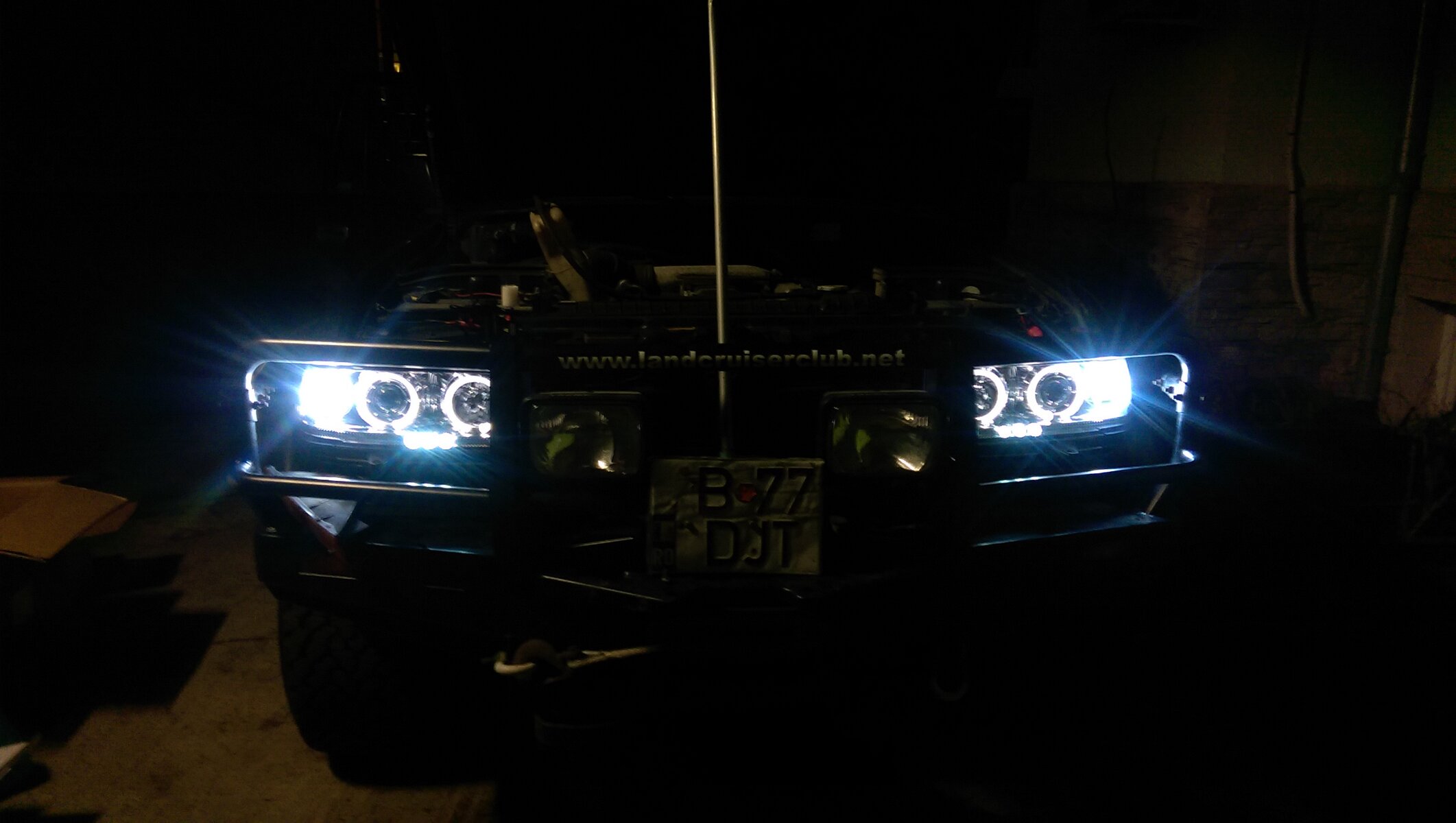

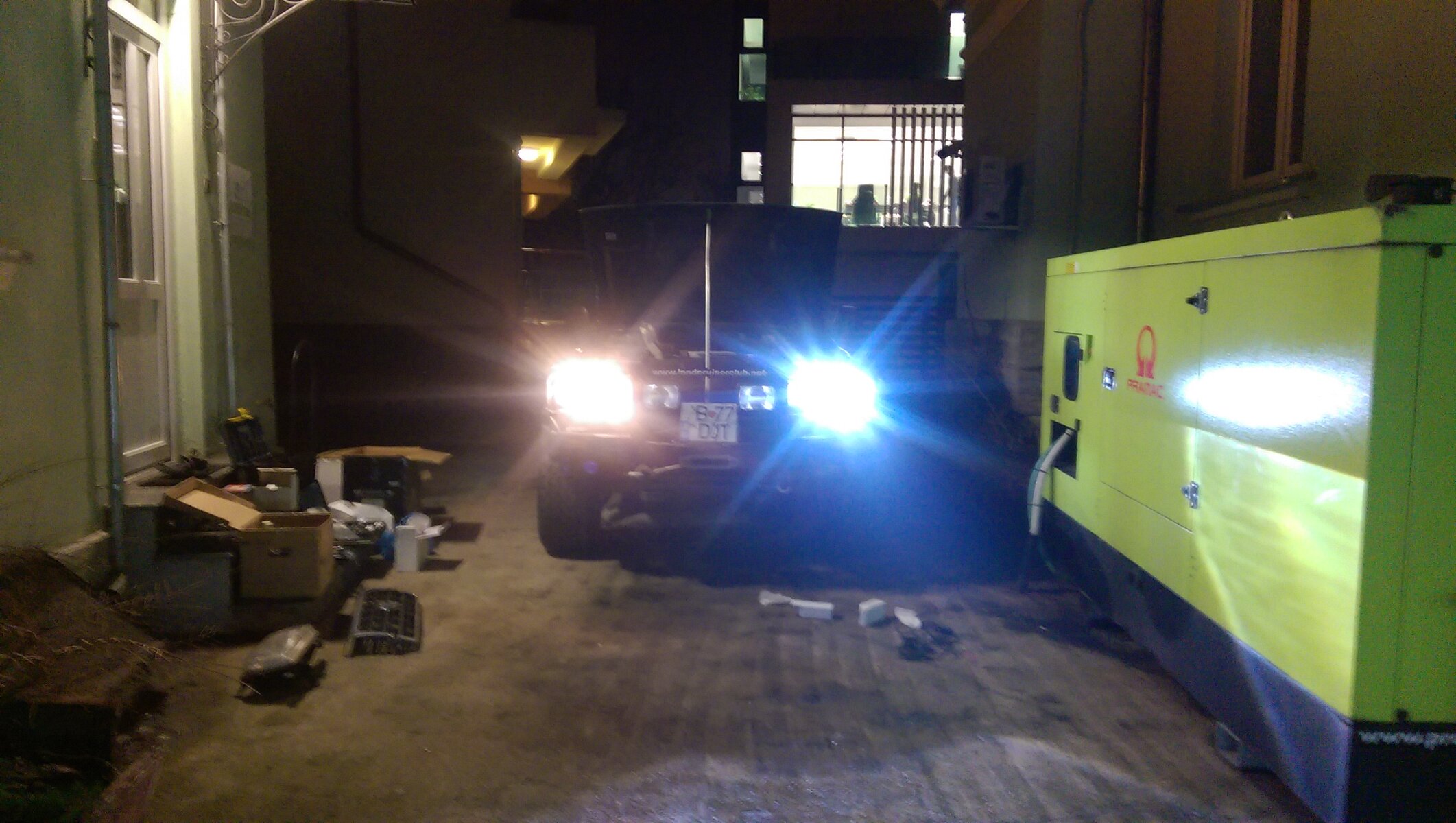

One side fitted, the warm-up clearly visible with the "blue" appearance, one of the pitfalls of HIDs, but it's something I can live with if the beams are good.
The beams are white in operation, so no problem for me.
Both sides fitted... the Angel Eye feature in action, on side lights only

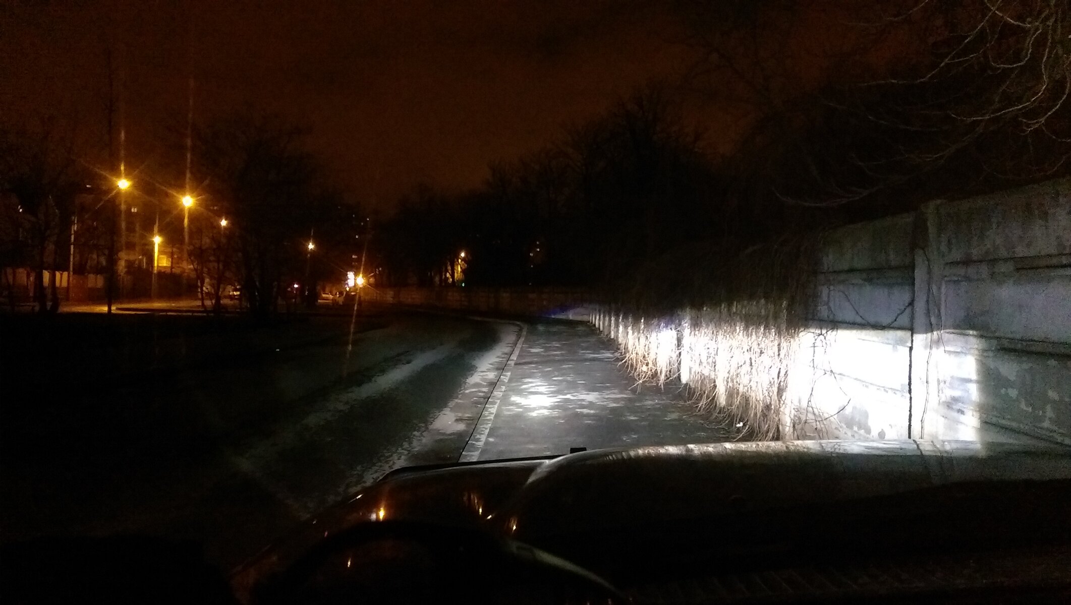

The beams... no photos against a wall, which would be more indicative, but clearly a nice bright beam and rising to the right (remember this is a LHD truck) which will illuminate the verge nicely (essential here, because road edge lines are always deteriorated or invisible on Romanian roads!)
I picked up the truck Friday evening and drove to the house very pleased with the light pattern. I had no opposing traffic complaints and I could see where I was going, for a change, both road and verge illuminated beautifully, with a crisp cut-off line at the top of the beams.

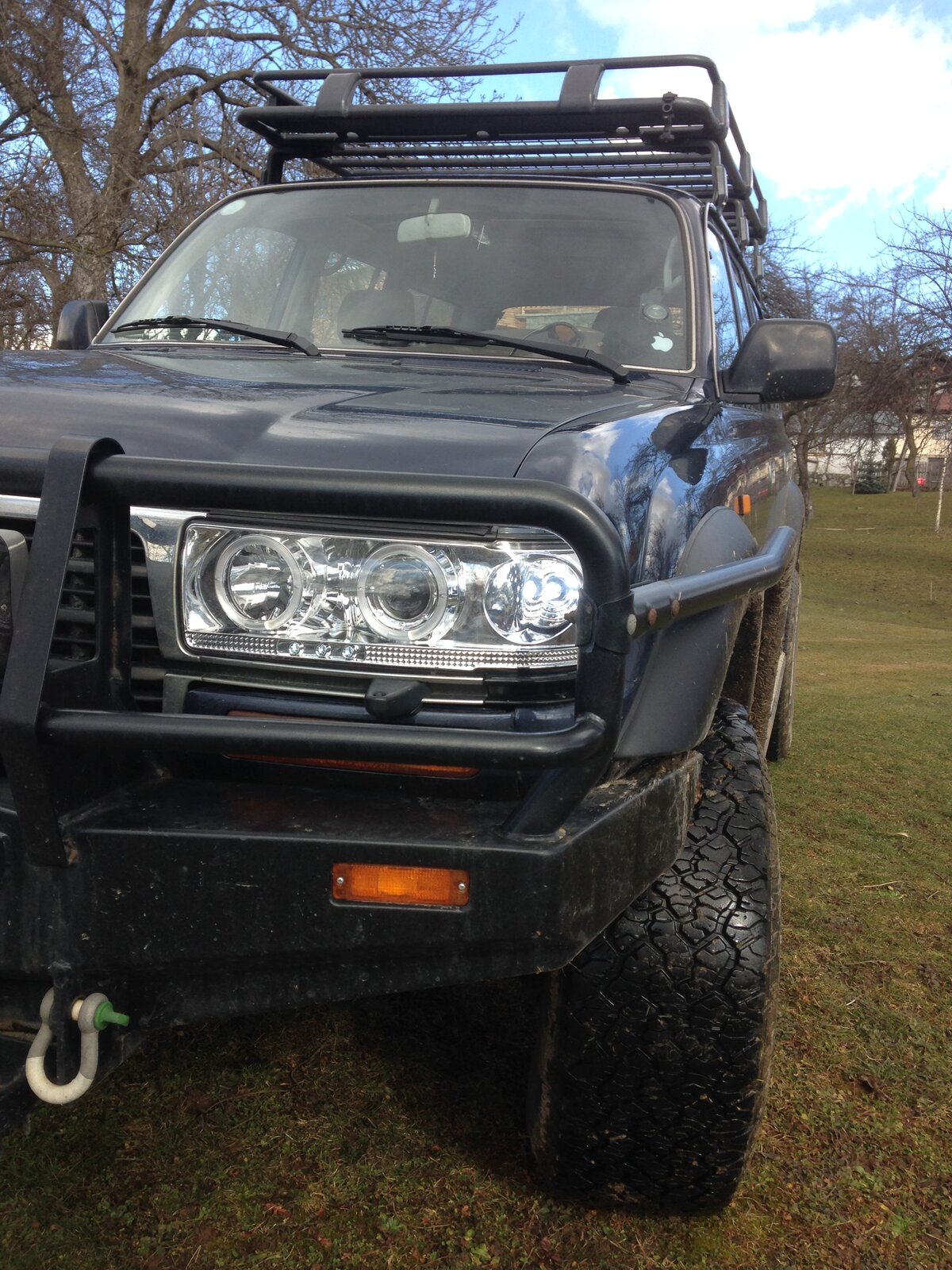

In daylight, the side lights look like this...
The units fitted nicely and give the truck a bit of a face lift as well as giving me more than adequate lighting, which is a big improvement. I'm happy! :dance:
