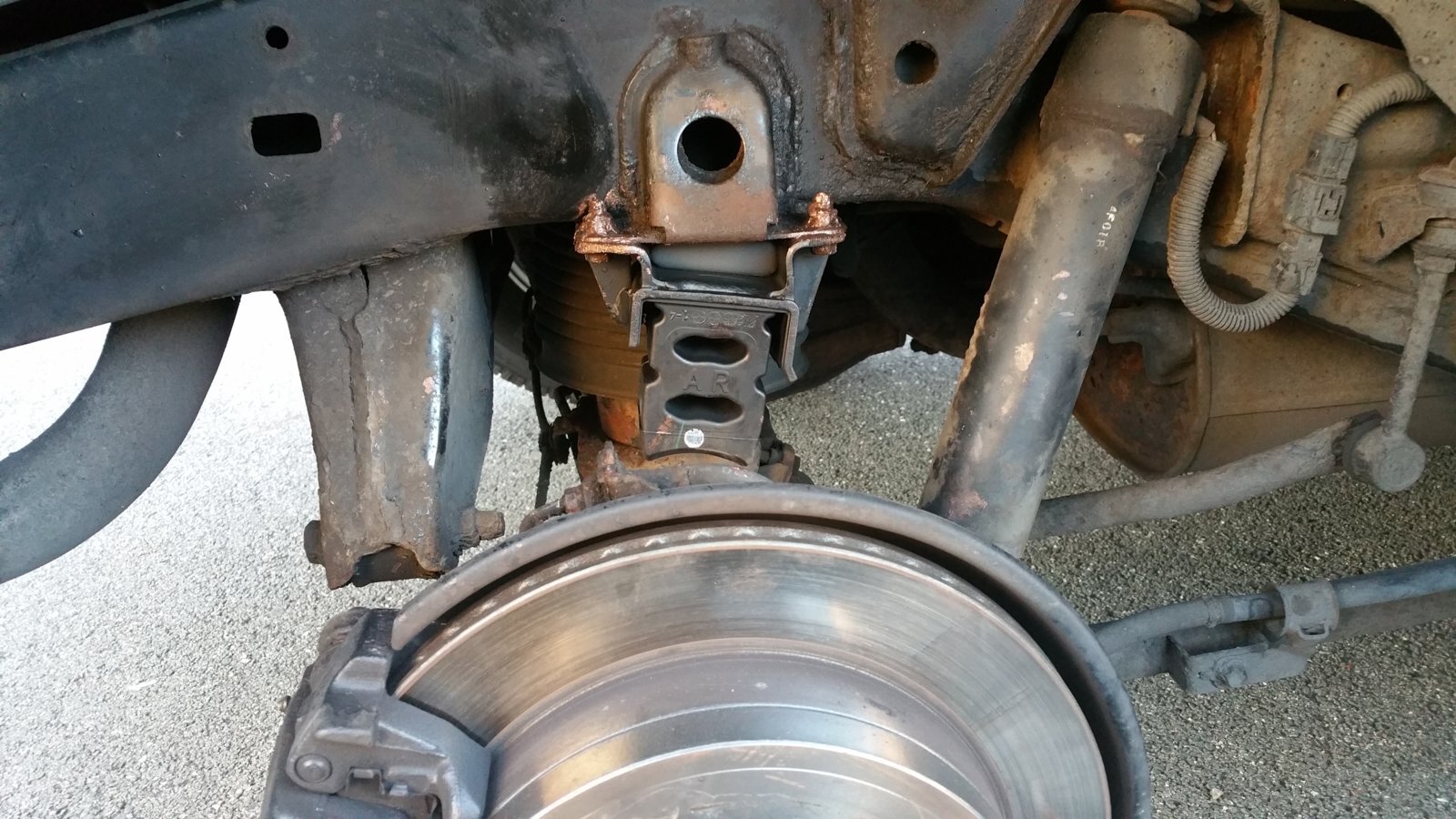

Purchased new bump stop but looks like it has been upgraded compared to the old one.
Main dealer said that was the correct part.
2 12mm bolts which needed heating up with a blow torch and good clean with wire brush.
Got it undone cleaned with Gunk degreaser and lubricated with cooper grease. All done.
