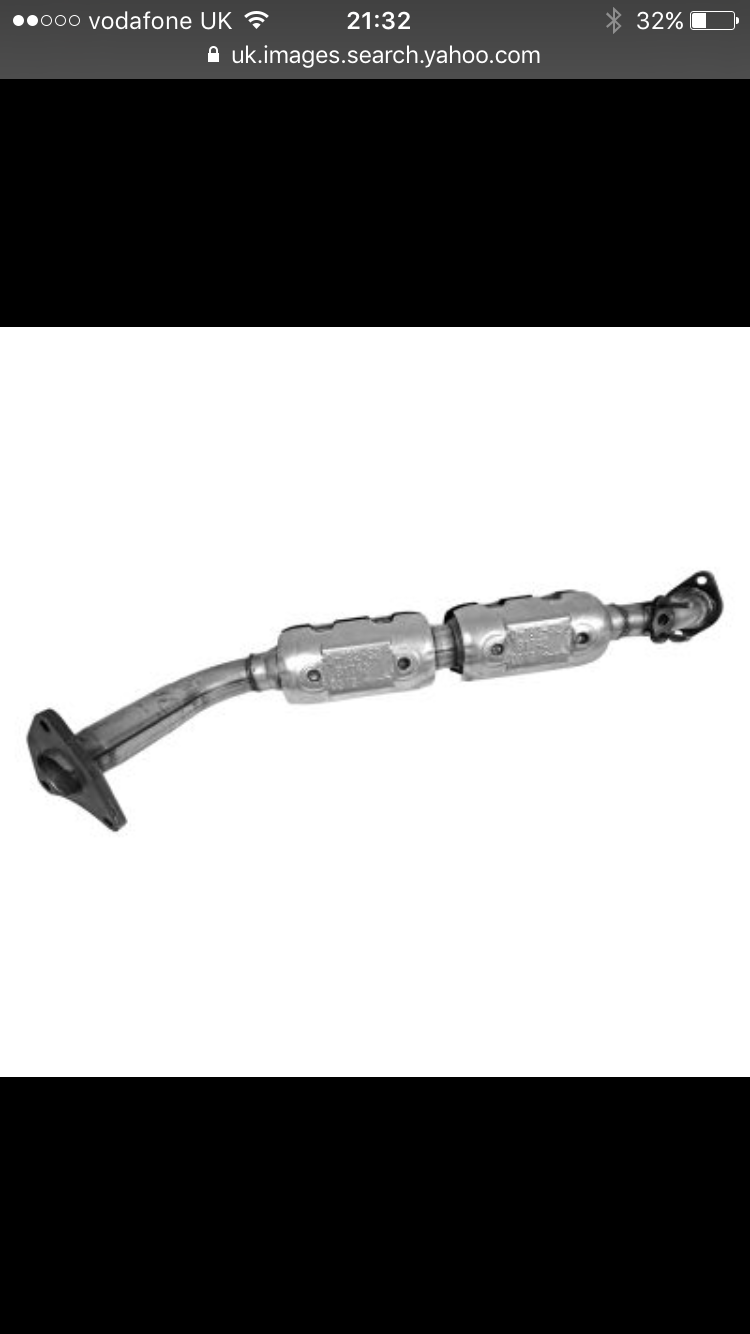

Something along these lines?
Yeah like that. One is part of the front pipe and one is a separate part. Just an extra thing to look for on a petty while poking underneath.

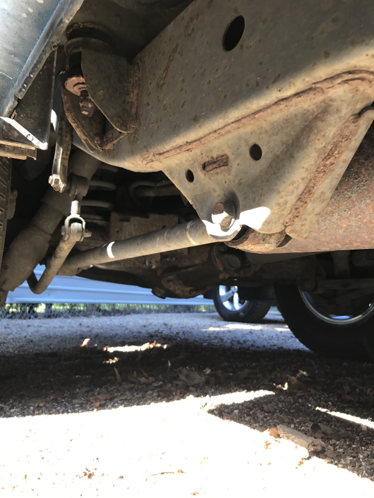

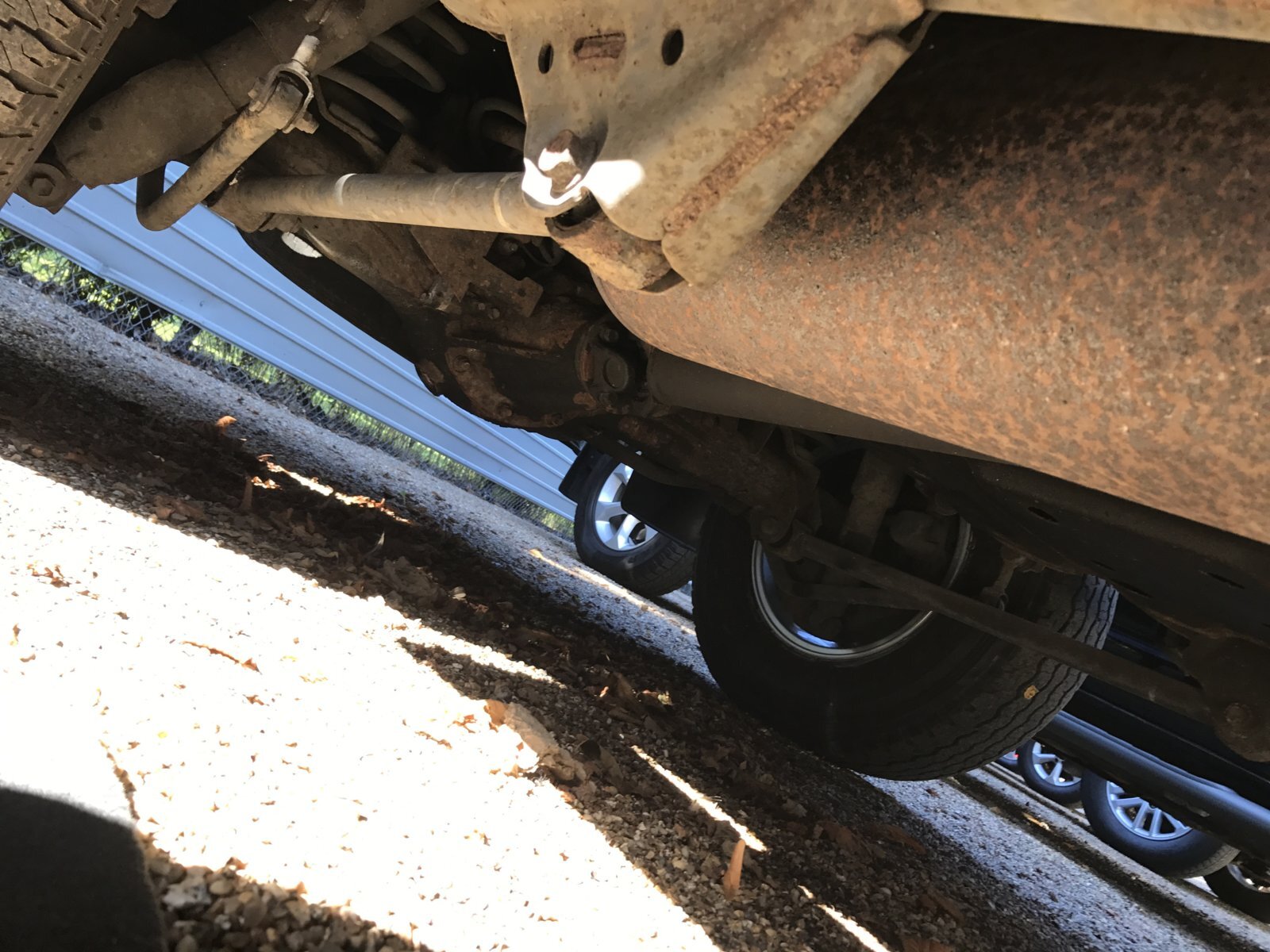

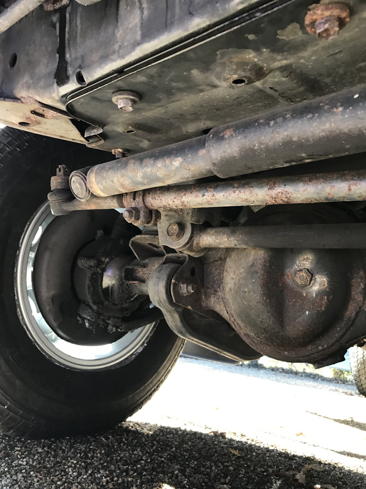

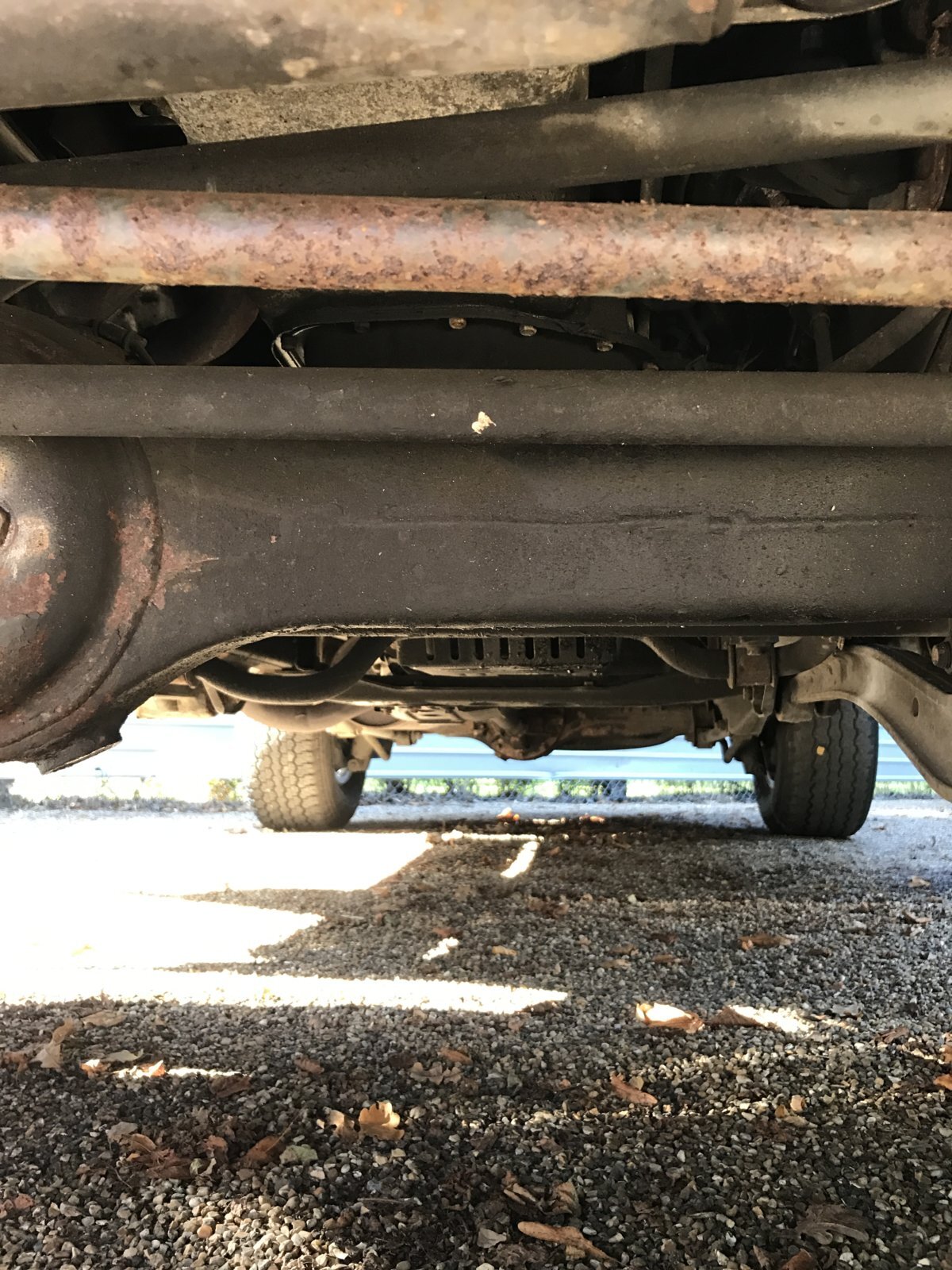

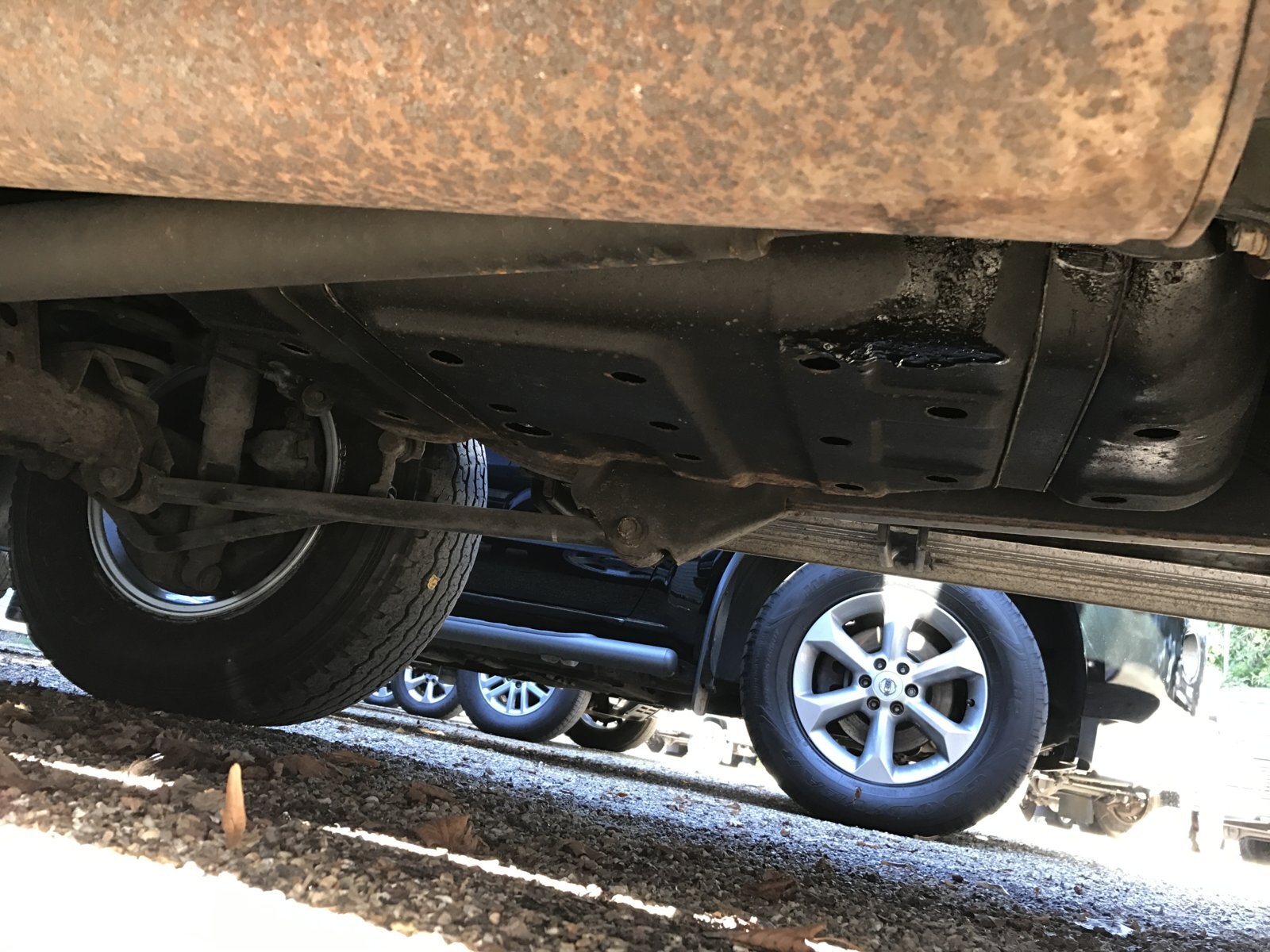

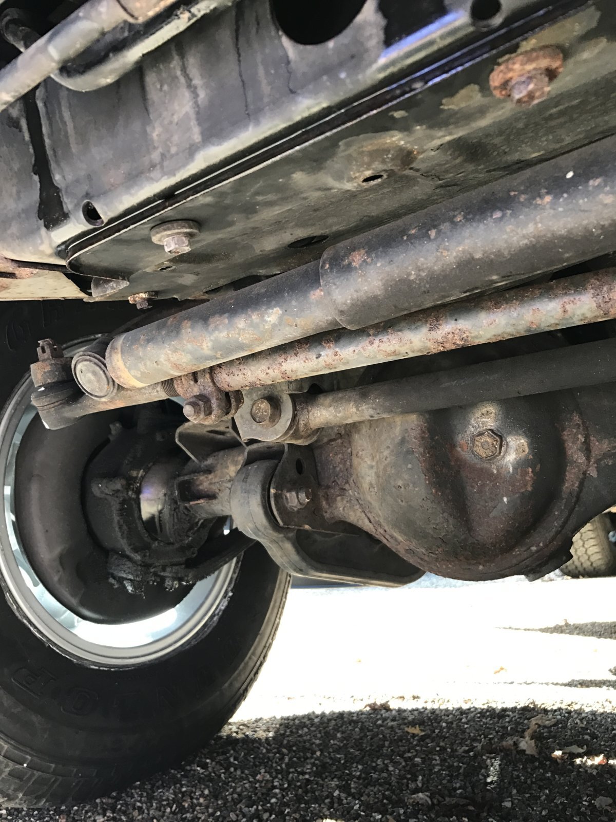

So I've been to see the petrol. Drive wise it turned in sharper to the right and the ac wasn't working. It pulled strong, I liked it, I think the manual might be quite fun even on road.

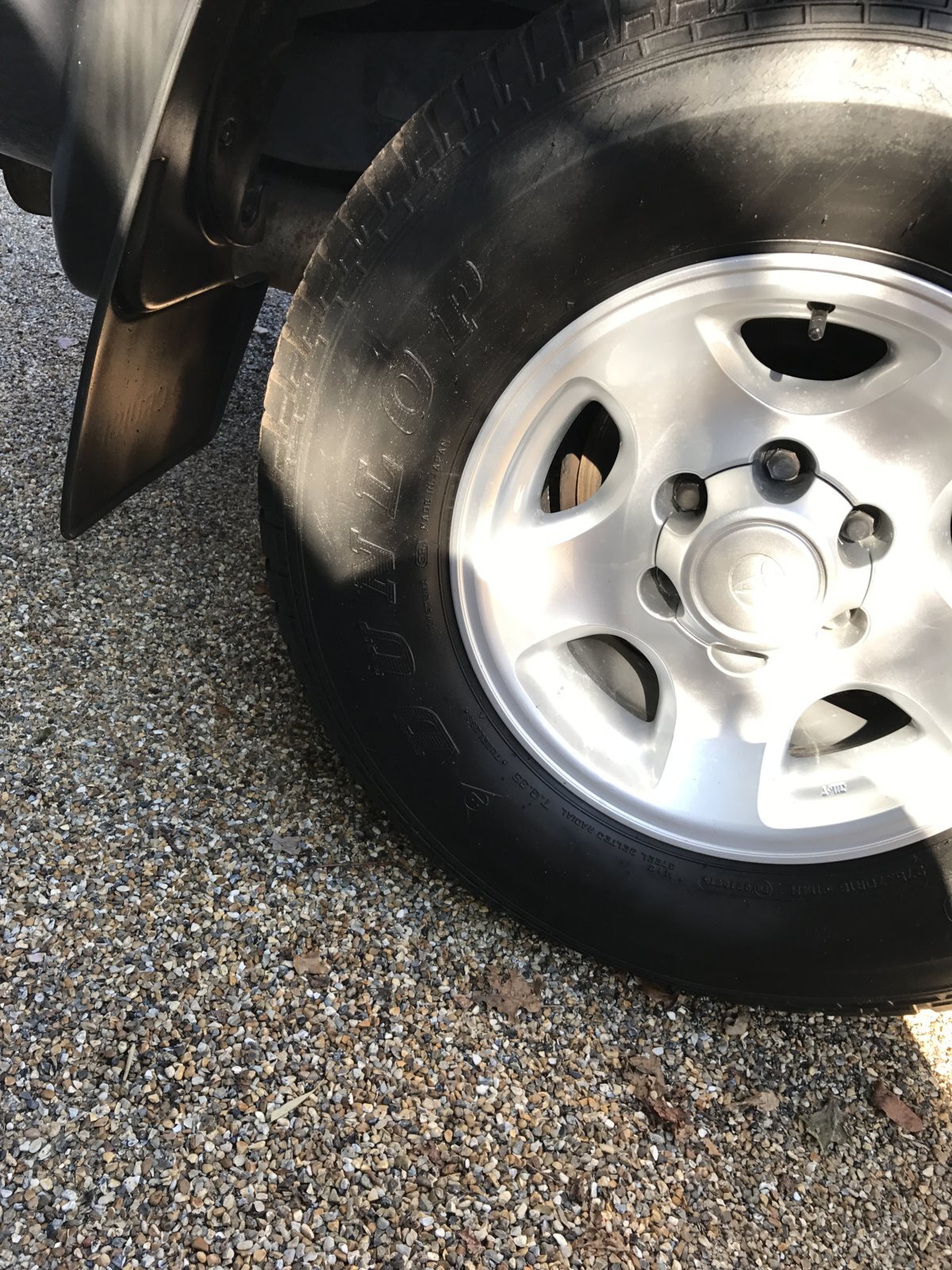

The chap said no tow bar looks to have been fitted. The interior was good, both converters were there, tyres looked old but lots of tread and no date.
No Rust I could see on the panels, none around tail gate, windows, only thing that didn't thrill me about was the paint but it looked original. A few spider webs and scratches, bigger one on bonnet and big web on corner of rear bumper. Now bear in mind this was the first one I looked at I thought the under side looked rusty and few weeping areas of oil. When I said to guy he said this is one of the better ones.

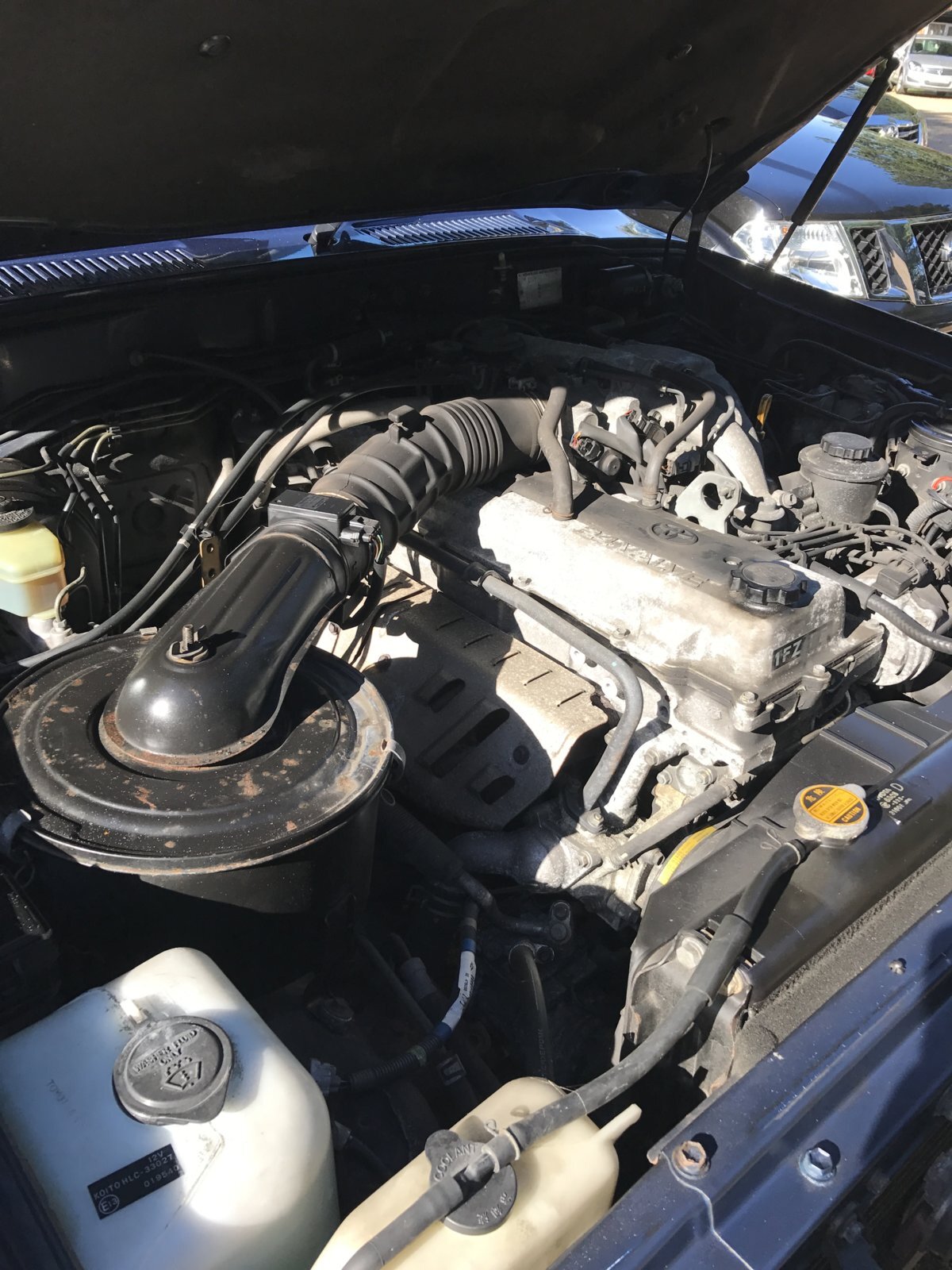

Do all the engine bays look to be painted with a flat paint and not the particular finish of the outside?
IMG_4859.JPG IMG_4861.JPG IMG_4862.JPG IMG_4863.JPG IMG_4864.JPG IMG_4866.JPG IMG_4867.JPG IMG_4869.JPG
have you bought it then ?
No, i was hoping these photos might give you lot a chance to say a bit more about the car?
The engine doesn't look as clean as the car Chris see but that could easily be dressed.
From the pics it looks a fairly honest and unmolested under side to me, sharper turning could just be worn bushes (they're old after all) prob it's original exhaust. Air con will be the condenser most likely, oil weeps depends where from but again it's old.
Engine bay is cleaner then mine currently! Shiny bay could be trying to hide something so not bad it's a bit dirty.

Looks like it needs a good baseline service etc and it'll be a good motor.

When i first started it up the idle was going from high to low but not so much erratic, more like it meant to be doing it and then it settled around the first digit on the rev counter i think but my minds saying second.
It felt a powerful machine, i had just driven my turbo to see it and this felt aggressively powerful in comparison. I know they're chalk and cheese but i could tell it could pull and thats coming out a 500bhp car.
Im sure a deal can be done but when you're then asking them to sort out issues, air condenser, bushes, have it serviced I can't see them adjusting the price much. I'd like to see some more though so i have better understand ing of good and bad.
