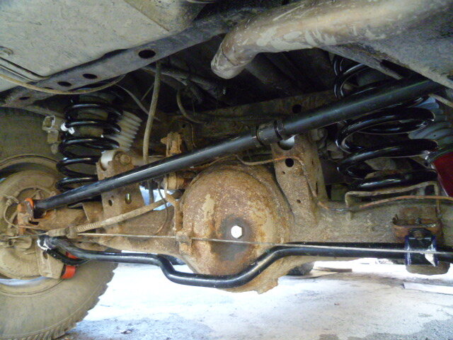

Been for a tootle, no rattles, clunk or creaks. Nothing binding. Feels a bit top of the springs at the minute because it's empty. Steering wheels 90 degs out now but that's easy to remedy. Got the panhards just about right. They are a pain to do on your own. Well the back one wasn't being fully adjustable on the vehicle. That was so cool.

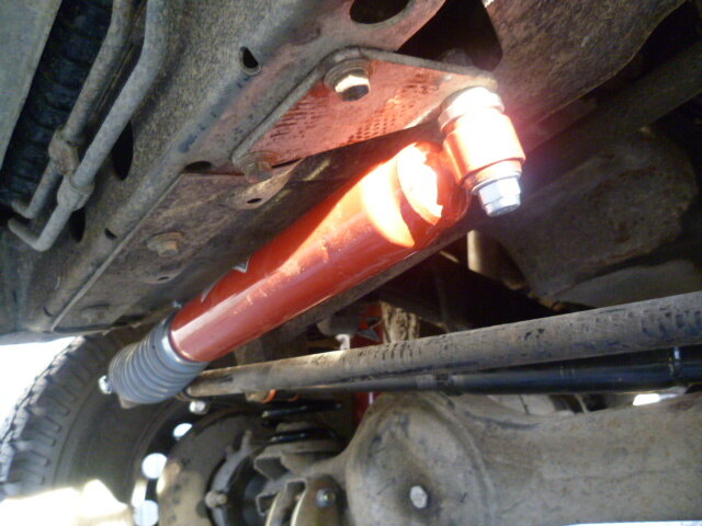

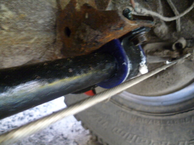

Nice shiny sway bars on, new bushes and links too. Steering certainly isn't light, it's actually very slightly heavy, only slightly. But the new damper is mahoohsive. It's like a rear shocker!

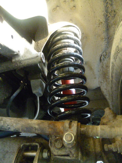

Been over the speed bumps. It's certainly cured the bottoming out.

The little bit of extra angle from the castor plates and the 'mahoosive' steering damper will put a bit of extra weight in the steering. Make sure you get a wheel alignment now to correct the toe as it will be out.

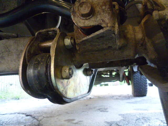

The outer DS side plate needed fettling to account for the weld around the diff bracket

Filled up both tanks. It feels slightly different now, slightly more springy. But despite the loading, the height hasn't dropped at all. Hooray.

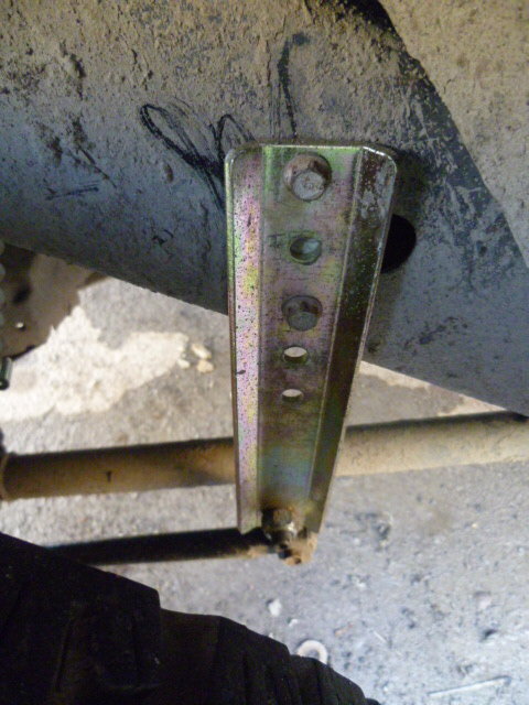

Here's some more eye candy before people start crying in their 4XXXX.

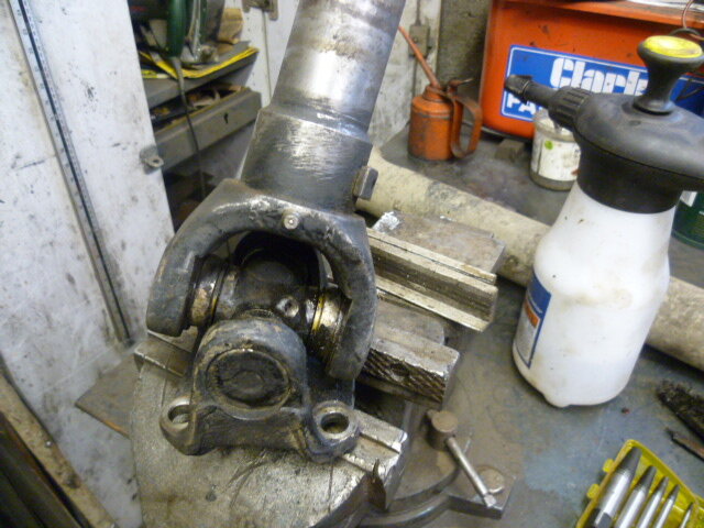

Decent weather again today so I thought I'd get a bit more done. Decided to drop the rear prop first. I could see the phasing was out just by looking. Dunno how that came about but it was an opportunity to give it a good service, re time it and check the input / output flange angles.
Gave that a right good fettle. Warmed up through a bit with the heat gun to encourage out all the old grease. Gave it a good pump through until only new grease came out. Seemed to be in goo order right through. Both ends and the slip joint. All reassembled and re installed no drama.
