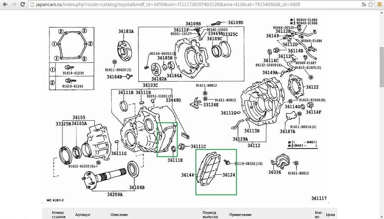

Hello everyone,
I am thinking to buy and install a PTO winch to my 1HD-FT manual 80 series.
There are two main types of transfer cases for 80 series - HF1A and HF2A. HF1A is part-time, HF2A is full time.
Additionally, the later (facelift) HF2As have larger housing, hence the rear shaft drive is shorter. This is mostly because these have a viscous coupling inside as well as a full/ manual diff lock. Mine is that type.
I am trying to figure out the following, for which i need your help.
My transfer case housing is a complete casting and there is no removable cover for the PTO shaft.
Hence the question -
Have you seen/ are you aware of a late HF2A (with viscous coupling and diff lock in it) which has the removable cover for the PTO shaft? If such exists, i am very interested in it.
Thanks!
