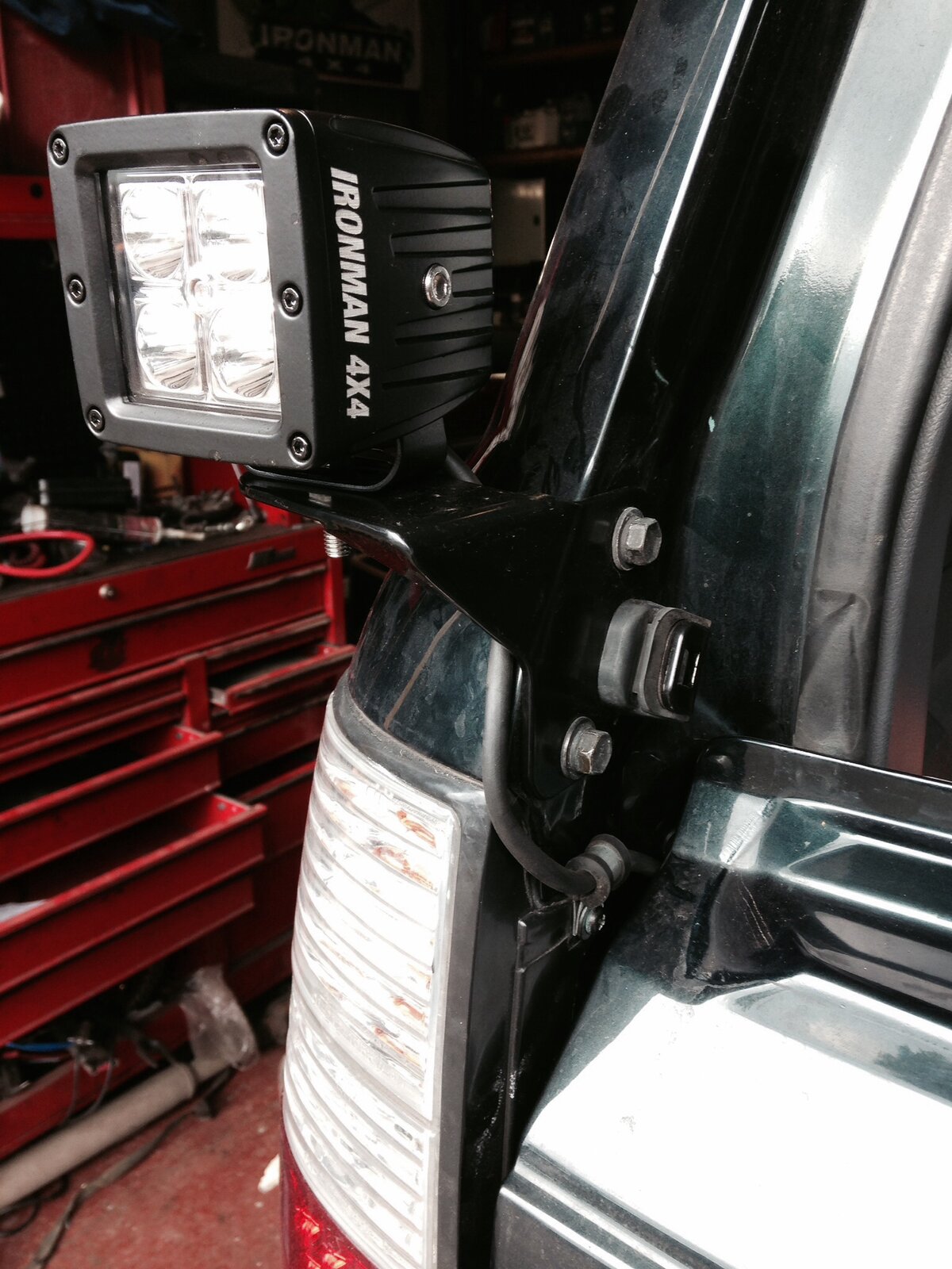

Just need a rubber grommet to protect the wire going threw the body and so I don't get any water coming in
