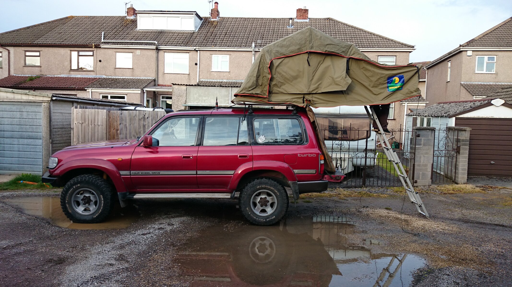

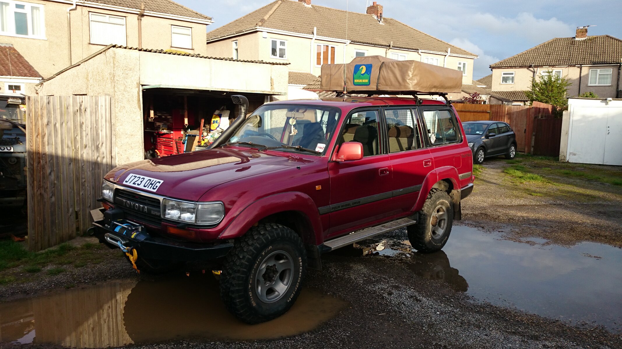

DSC_0015.JPGI dont post many pictures of my 80 put as its clean with my winch on and a refitted my rooftent here you go.DSC_0014.JPG
TBH it really is a tidy truck for its year. The next to last PO had it for 13 years and covered 30K in that time and it was always garaged.
