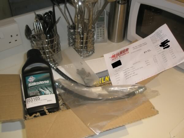

Delivery from Milners less than 24hrs after placing my order :thumbup: :D
2 x flexi hoses (check)
4 x brake hose 'U' clips (check)
1 x 500ml brake fluid (check)
Are flexi hoses the same length as OME ones (check & check) :dance: :dance: :dance:
And all for half the price of a single hose from the Yota main dealers :dance: :dance: :dance:
Thank you Milners :thumbup: :clap: :D (if your watching)

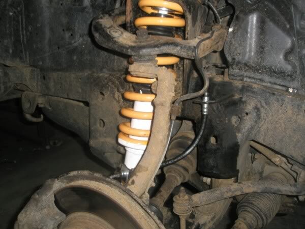

Well mine were cheap from Milners @ just £7.50 each :D Now all fitted & in use :thumbup:
