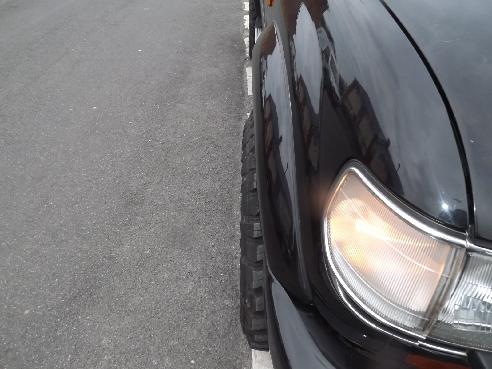

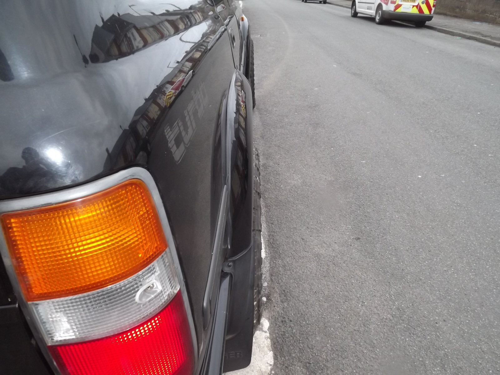

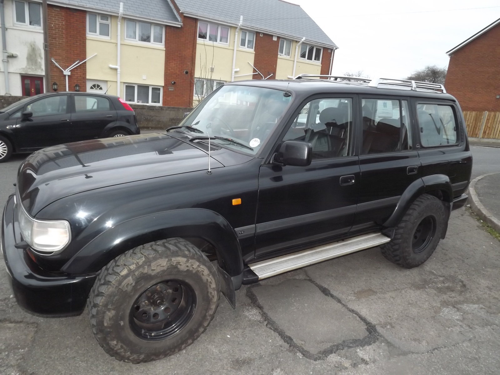

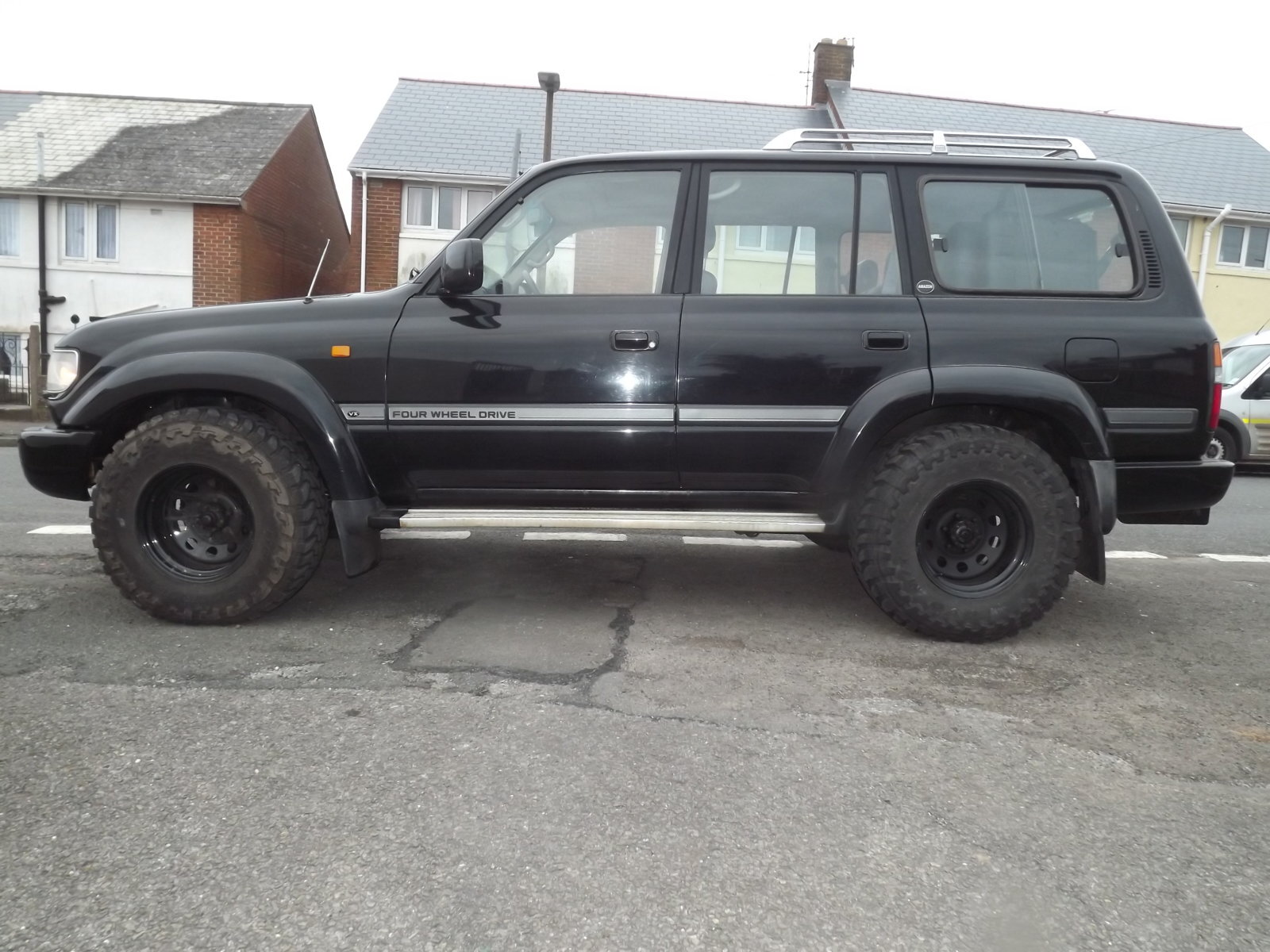

Shagged maybe original suspension and 305/70 R16 Toyo Open Country on a 16x10 et -32 rim . These tyres recommend a max rim width of 9" so on a 10" they might be about 32" tall , for me me they are the ideal rim size for the 80 though everyone has there own preferences .

View attachment 141926 View attachment 141927 View attachment 141928 View attachment 141929
Looking good Shayne, these are a borrow off your 90 I’m guessing, they sit very close if not the same as my set-up, same rim and tyre sizes, but mine are BFG KM2 muds... :thumbup:

Frustration at the lack of availability of tyres has me weighing up the pros and cons of importing everything from a free country or anywhere outside the EU for that matter so yeah they are just swapped offer from my 90 to give me some visual reference to work with .
Truck looks mint shayne, makes me keep toying with black again..
