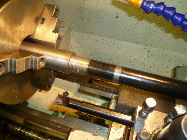

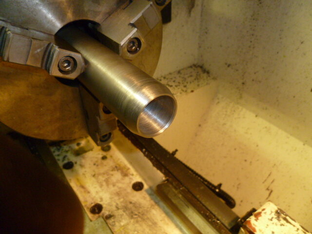

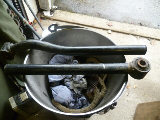

Been sheltering in the workshop today. Got the front panhard rod done. I wanted to make it adjustable on the vehicle like the back one. However, not possible with what I have in my set up. The rod is quite short and once cut won't pass through the headstock to allow both ends to be machined. So I had to compromise really and make it a single thread adjuster.
Given the proximity of the diff pan, you can't really put the adjuster at one end either, so a central cut was necessary
My idea was to make a piece that would slip onto the cut end, sweated in place but not before I'd threaded the other end. This meant that all I have to do was clean up the cut end which didn't require it going in the lathe
Then the other end was threaded 30mm x 2.5
As the other cut end was straight, I could get that in the lathe to thread it no problem.

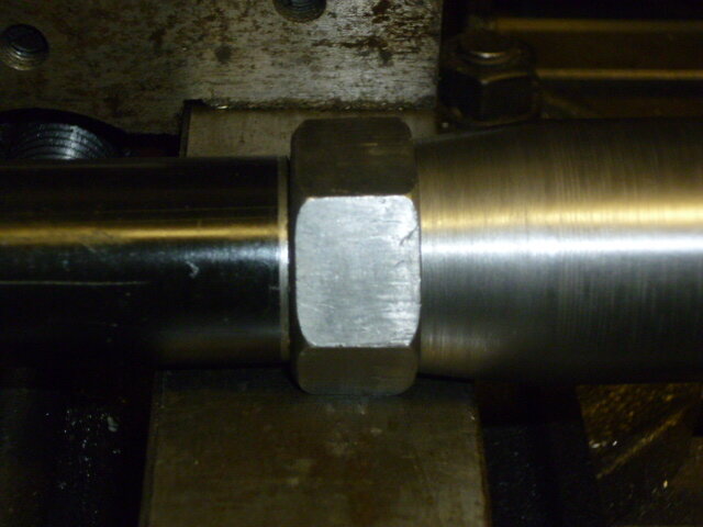

That screwed in nicely with no slop. I added a lock nut next.

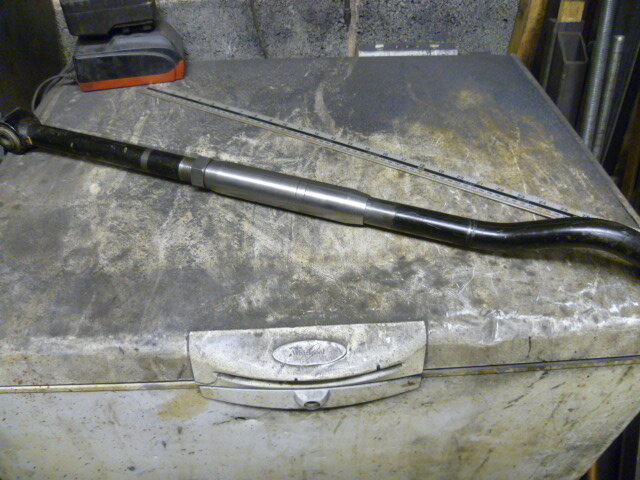

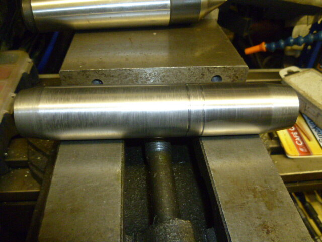

Here's the polished up adjuster section. The two detail rings that you can just see are the two internal ends of the bored out sections.
With one end shortened, I got the new rod to 810mm so that it would fit a standard 80 not just a lifted one.
I might have them blasted an coated. Yellow might look snazzy.

By sweated Clive, I meant an interference fit. Two parts at the same temperature that would not fit together. But one chilled and the other heated, they would. Once pushed together the temperatures normalise and the two section are stuck together for life.

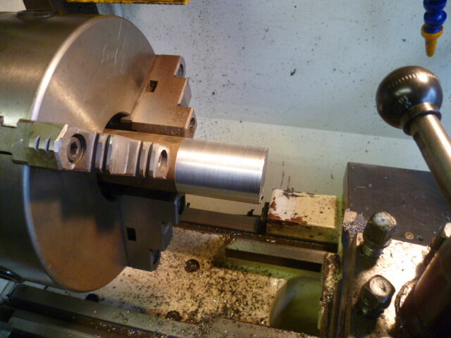

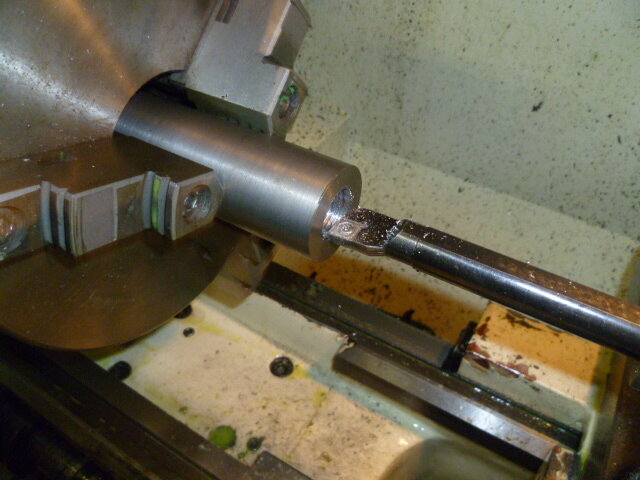

Cheers Ben. Like all things, if I could source tube in that size cut to length all I'd have to do is thread one end, cut the original rod, thread the other end and pretty much that would be it. Oh and source some 30mm nuts. But taking a blank and boring the hole down the centre is a morning's work and a couple of tips too. Same with the rear ones. Strong adjustable PH rods would be a nice thing to be able to produce for people but the time taken would be prohibitive.
