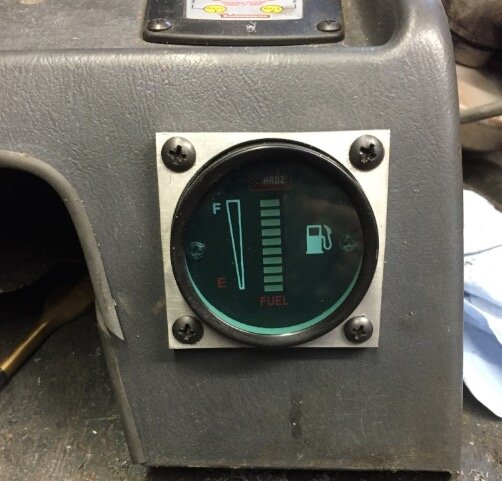

And finally got around to mounting the sub tank fuel gauge. I have tried it and it does actually seem to indicate something. Hopefully fuel level. Made a bezel from aluminium into which the dial fits to stop it pulling through with a bracket on the back to stop it falling out. If that makes sense.

Anymore details on the aux fuel gauge and how you wired it up? I've fitted a aux tank to my collie and have the original wires coming out from it via the unit, but not sure how to wire in a gauge.
Actually, yes I can! Ok the gauge is just some ching-chong e bay cheapy, but quality aside they all work the same way.
Essentially the gauge is an ammeter. It puts current through the float in the tank and measures what comes out. it then displays this on the display. So when the tank is full the resistance is low so what goes in comes back out. As the fuel drops, the resistance in the float goes up so less current makes it out the other side. I don't know what colour wires you have so we'll have to do that later. But, there should be two wires coming out of the tank sender and three wires in the back of your gauge.
One of the gauge wires is 12v in. This needs to be on Acc so that the gauge goes off when you stop the car. The next gauge wire needs to be connected to the sender via one of the loom wires. The other loom wire needs to be connected to the last remaining gauge wire. So in really easy terms, two of the gauge wires connect to the two sender wires. The last gauge wire is power in. This not only powers the gauge illumination etc, but sends the current down the wires, through the sender and back to earth. It had me foxed for a while until JW kindly told me it was an ammeter. It's nowhere near as complicated as it sounds. You only need a length of 2 core to run from the tank to your dash.
Thanks Chris, sounds easy when you put it like that. I've just looked back at the pictures I took and I have three wires coming out from the tank unit. Black, red and yellow hmm I'll update my thread when the time's right. Don't want to go off topic on your awesome thread! Good work by the way :clap:
Whilst you were searching for gauges, did you come accross anything smaller that can be mounted on one of the switch sockets, or is that too small? I wanted something that would look OEM and I think I've seen some fitted there before...
I did actually. I was talking to a company in SA who made a calibrate-able led gauge that was really neat and about £20. I could have as many segments as I wanted on the display and choose the colours too. You could set full and empty so it was accurate. But in months of talking to them nothing ever happened. It was a neat little strip and would have fitted in the dash somewhere handy. In the end I bought one of these for about £8. They are typically all about 52mm so if this works but packs up, I can buy a nice one and it should go straight in. I really only need the empty reading to be accurate I guess. It has a little adjuster which I can tuck up under the plastic trim. I will empty the tank and make sure it reads in the red then add fuel say 10l at a time and see where the segments change. It's n indicator only really as by that time I am effectively on the reserve tank.
The oem style gauge by the way goes up in the headlining in a console. These are available. Speak to Chapelgate he might be able to help. But as mine has a none oem sunroof the console wouldn't fit.
