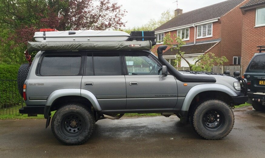

Spot the difference. Come on it's not that hard...
That's right! I have wired the sub fuel tank gauge in. Well spotted.
I was going to mention that but I thought it was too obvious.
It's like Catchphrase Chas. Say what you see.... It was quite easy.

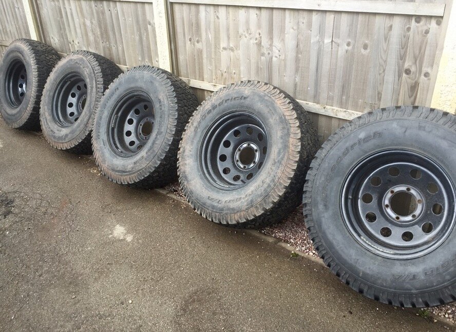

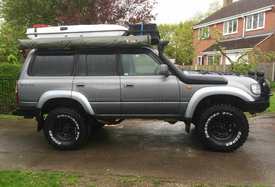

New boots, white lettering the right way too :icon-cool:
I went with the same size, 35's basically but changed from 17" rims to 16". So they're 315.75.16
Plenty of 17" Coopers around, I just figured that 16" is a more common tyre if I ever got into trouble somewhere remote.

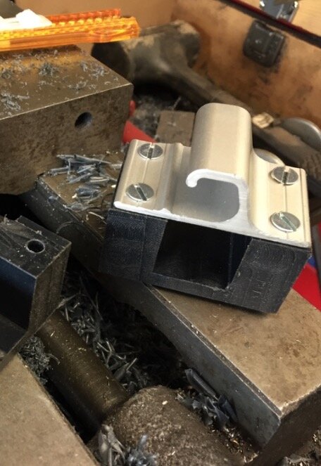

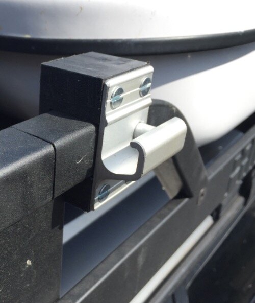

Made an early start on some new brackets this morning.
But what could they be for? Milled some bits out of the heap of plastic stuff I have stashed.
They are a perfect fit on here. Like bought ones!
So I can do this .....

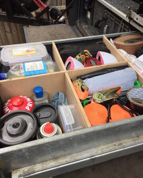

Then I did some stuff in wood. Cripes that's been a long time since I made sawdust.
Have to say it looks simple but what a difference it's made to the way I pack and get to the things I need all the time. Rather than just cramming stuff in, I can now get to the Jetboil and gas, tea and coffee, spoons etc. Yep. I like that.
