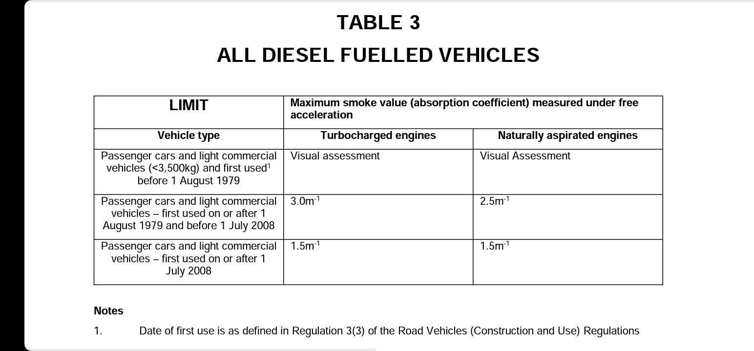

Or do some MOT stations work on the higher limit? sure it used to be 3 at one time for the given age, ie 2005.
I thought the limit was still 3 for a pre-2008 turbo diesel unless there's a manufacturer's sticker on the vehicle saying it should meet a lower limit. I'm no diesel expert though so it may be worth challenging the MOT station and see where they get their info from.

Much obliged Karl.
I'll get the garage to fit the new exhaust as arranged but another MOT station would appear to be the answer, don't want to get into0any argy bargy with where i usually go because their general car work for all our family is good.
Simple error could cost them and customers dearly , print off karls attachment and ask them to double check .
I assume your car is home waiting on a new exhaust so your not choosing a battle but rather doing them a favour if your right and they made a mistake .

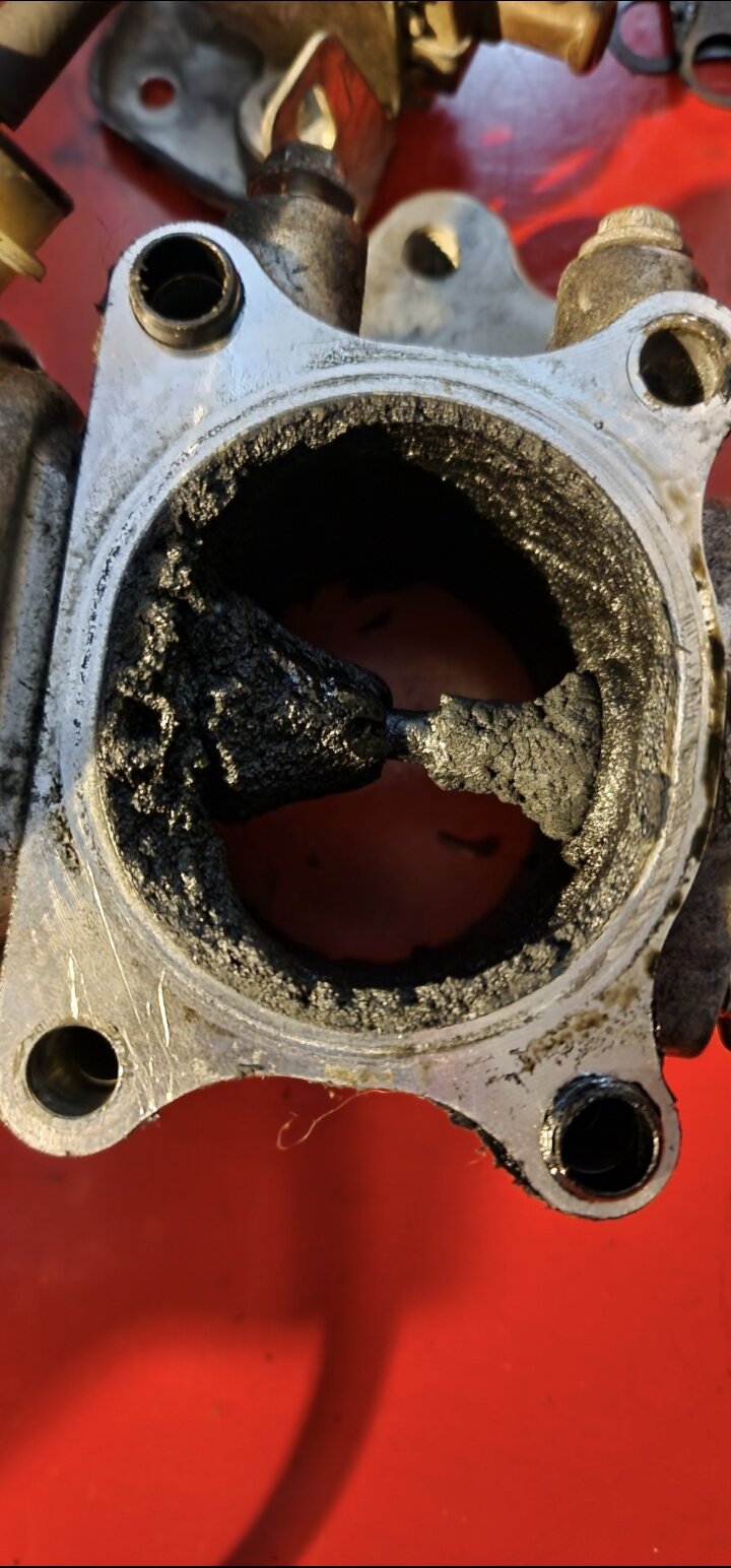

Egr - Mine was the same - did it a few weeks ago when the coronation was on :) 92000 miles and doubt it's ever been done - pic attached
I think id prefer it to be a bit oily rather than an abrasive powder - unless someone knows better - so will be interesting to see peoples opinions on it....

Juddian, I would tend to agree with Karl, if it's sticky s**t, it would tend to stay roughly in the same area and not blow like soot all inside.
As regards the catch can, dont get one with small in/out 10mm I think get the bigger size one 15mm I think, smaller restricts breathing.
