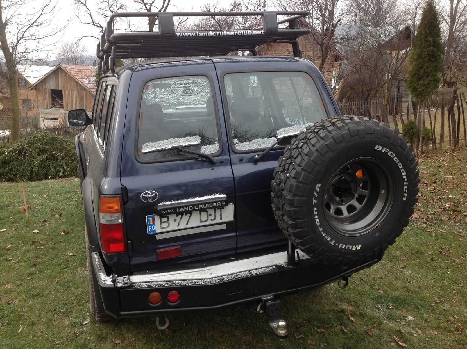

I don't yet have a tow bar set up on the 80. i don't want something that hangs down too far and acts as a plough when I'm off road would i best fit a receiver hitch to a standard tow bar set up or for the work i have in mind would this sort of thing work straight off the back crossmember (plus wiring etc)?dropping the tow ball down will cause some twist / torsion on the cross member but was wondering if you felt it would be acceptable. Thank you
Going back to the OP, maybe I should clarify that I would have no problem using the dropper in the link, directly mounted to the crossmember.
However, a receiver is a different animal, and needs a different approach to mounting IMO.

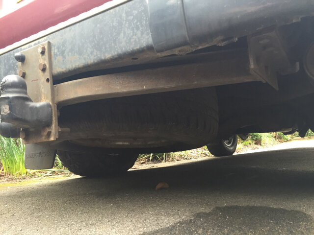

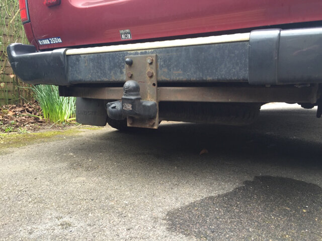

This is what's on my 81. I am not a fan of this! Saying that the previous owner used to tow a 16ft tri axle ivor williams trailer fully loaded with scaffolding daily.:think:

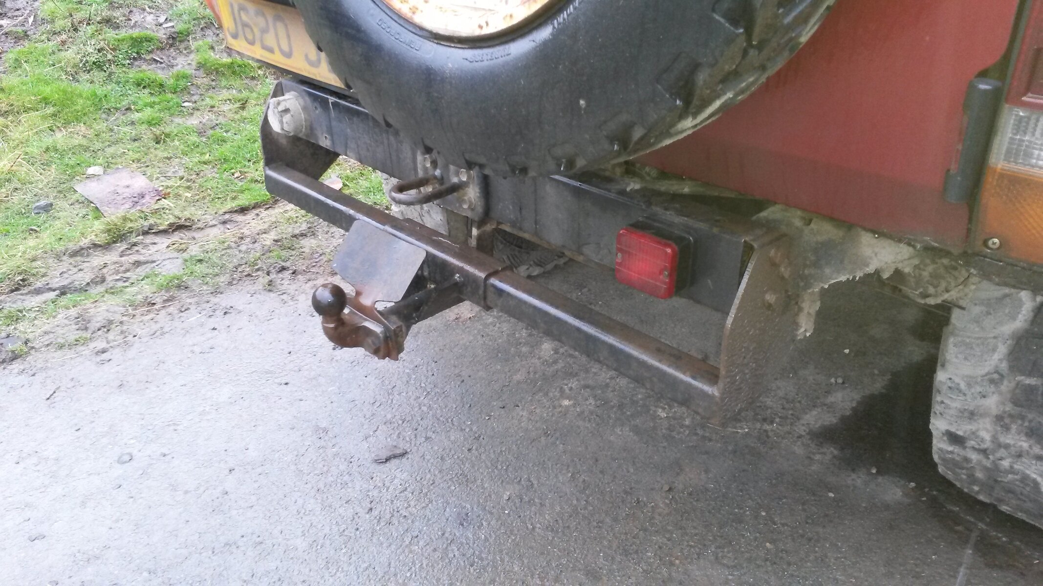

Had this setup on my first 70 series and that was again towing a 16ft ivor williams twin axle daily with full loads of roofing slates, oak beams etc. It towed from 2001 to 2010 did it ok until the rear cross member got pushed into the diesel tank. Since then I have lost confidence in this mounting point.:thumbdown:

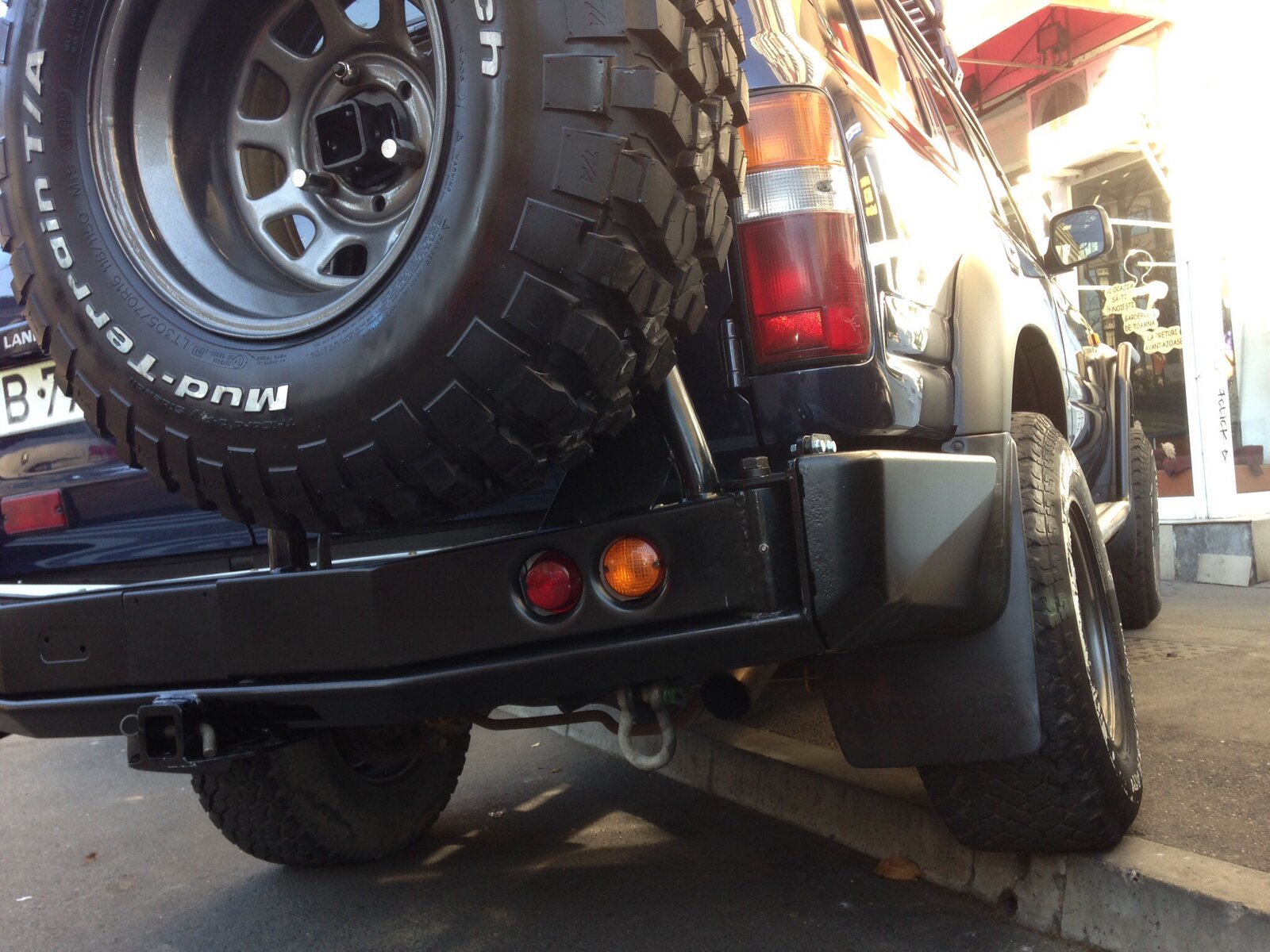

This setup on my current workhorse is so safe and it does tow loads that you have to use low box to get up the hills! IMHO to know that your towbar is well attached to the truck gives confidence and a safety to other road users.

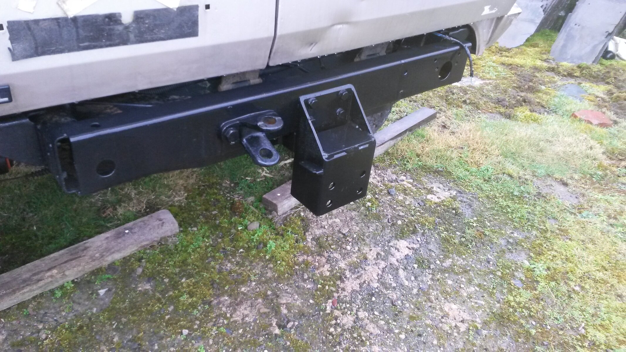

This red 70 has the factory fitted recovery hoop on the rear cross member.

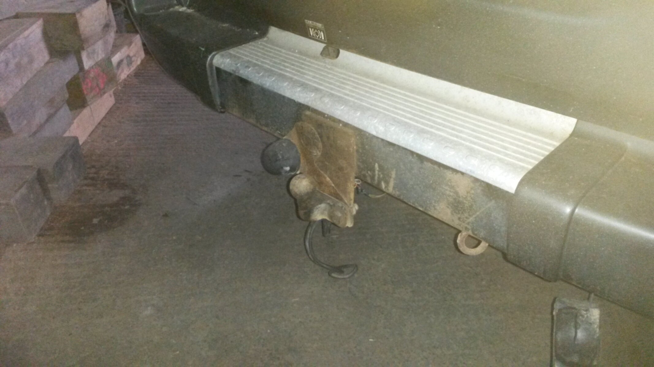

That's how the one I have just let go fits
It looked like yours was held to the chassis with vertical plates. Mine is less nicely designed with angle irons bolted underneath. Good n solid though.

My rear bumper with the integral receiver is high, but I still catch it on rocks and stuff.
The dropper on mine is on the receiver bar, which is easily detachable.
