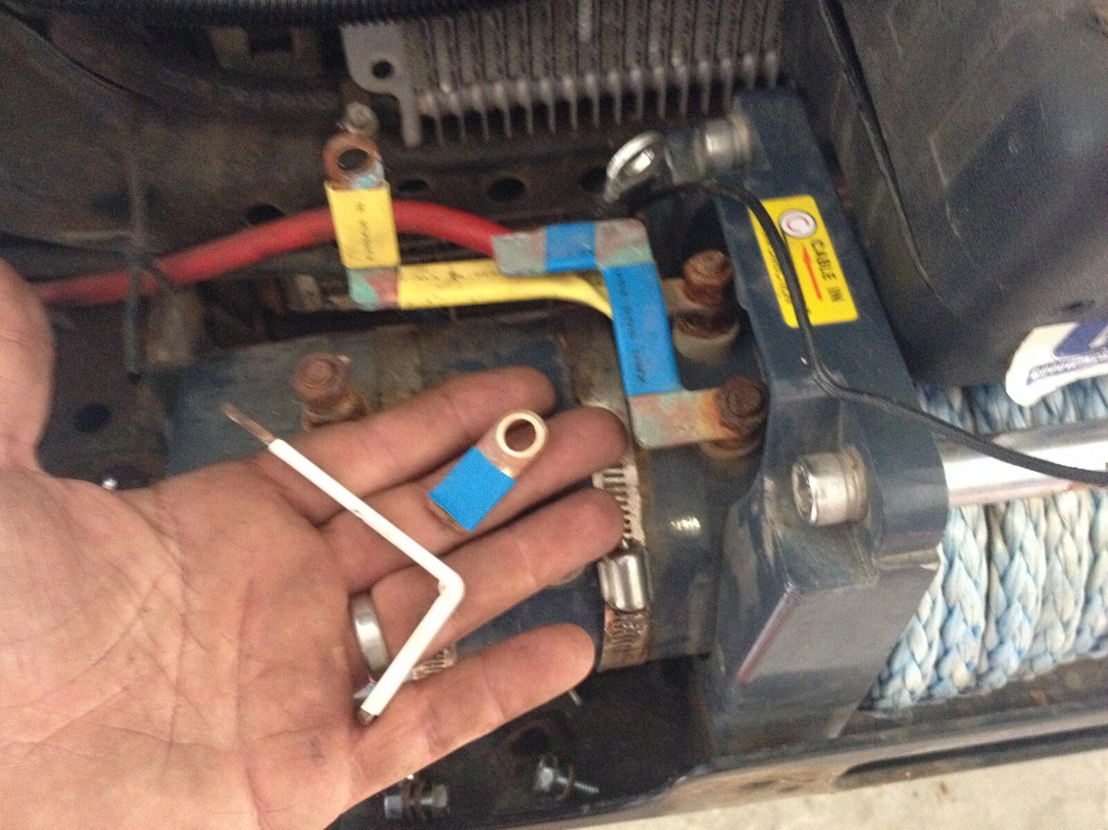

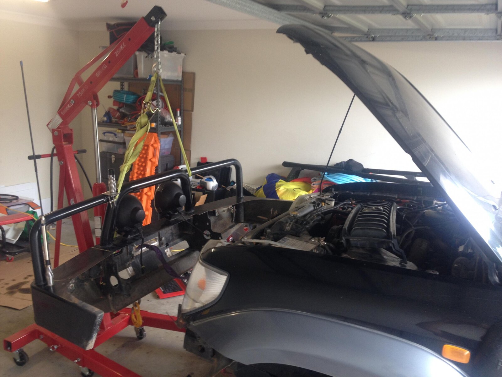

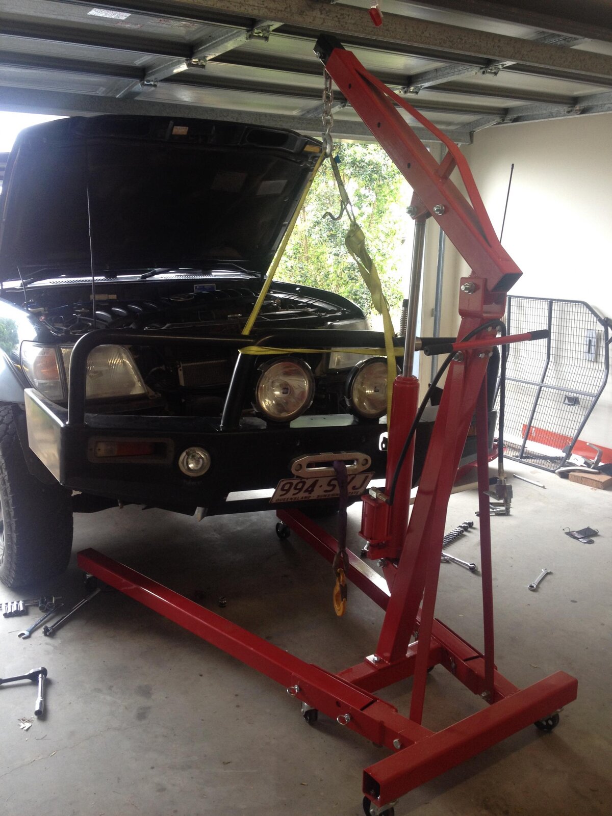

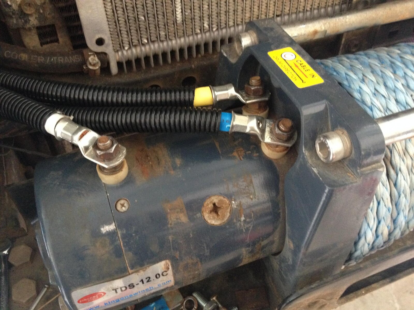

So to solve both problems (access to the solenoid and broken copper bars) I decided to move the solenoid box into the right wing of the bar and replace the copper bars with 40mm cable.
Everything seems to be working fine again. I'm a little disappointed that those parts broke so soon (the winch is only 9 months old), but I guess they weren't designed with corrugations in mind. My advice if you have one of these and are going to do lots of corrugations... change the copper rods before you need them.
How on earth did the copper break?
Ideally you should use heat shrink to cover the joint between your 40mm cable and terminals, and some terminal covers.
