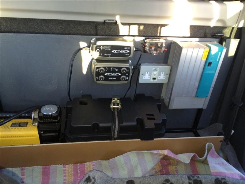

Got my frame i made for rear cab back from powdercoaters
so i fitted board to it, and bolted on my air-compressor to the base
and started fitting electronics = inverter, Ctek mains charger, Ctek DC-DC charger, 240v plug socket, a fuse box
and fitted battery box in place

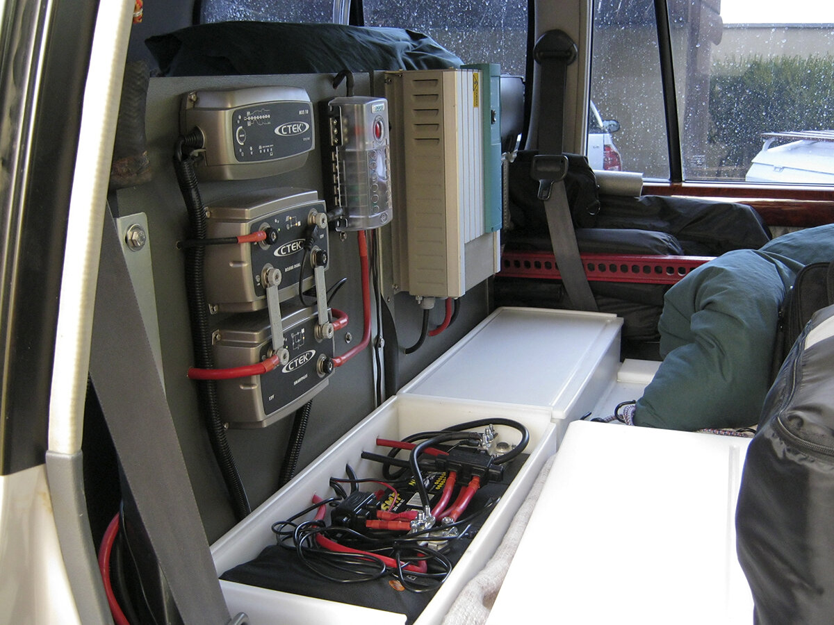

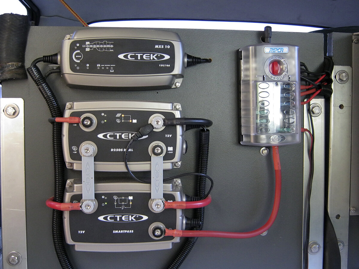

Great minds think alike. My CTek installation looks almost identical to yours.
Keep up the good work.
Brilliant Marius
I hadn't seen your setup either
But i like you idea of drilling holes in the board to hide some wires.
I will do that to some too as it looks neater.
I see you have a ctek smartpass, does that have significant benefit over just the dc-dc charger,
And i assume you have a solar panel ?
Sent from my GT-P1010 using Tapatalk 2
My system works great and yes I have two 130w Victron solar panels on top of the roof top tent. I have only used the CTek D250S with the Smartpass so don't know how the D250S performes on it's own sorry but I love the product.

From what i read the DC-DC chargers are meant to charge the leisure battery more efficiently and fully charge them compared to using a split charge relay
. The hilux alternator isnt that highly rated so i thought i would try one.
I had an amazon voucher as leaving present from previous job and i saw one of the ctek chargers on amazon so bought it.
The upper ctek unit on photos is a mains charger and it has a mode where it provides continous power to leisure battery and i used this in morocco where campsites had electrical hookup.

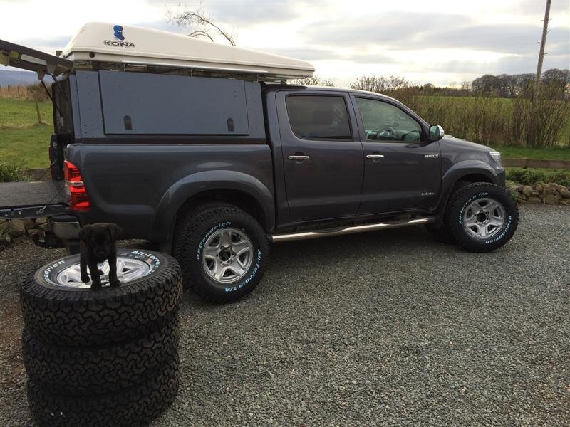

and the tyres are on
vehicle looks much nicer :icon-biggrin:
but standard 17" alloy road wheel/tyres going back on soon until i go on next trip where i need AT tyres
the stance is slightly wider since the colorado alloys have different offset, like the look
will look even better when i get OME lift kit :icon-cool:
