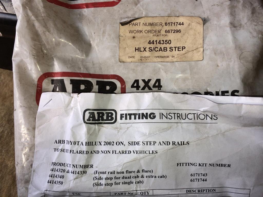

a brand new ARB rear protection bumper/towbar..... for £300
but... got home and found the fitting kit is for 2002-2005 Hilux SIDE STEPS!!!! :icon-evil: :doh: :cry:

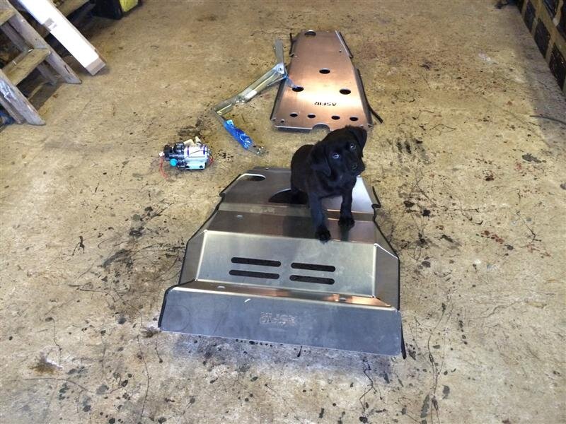

ASFIR stuff to fend off them pesky stones

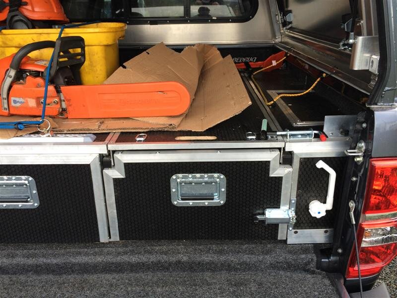

and a shurflo pump and a tap for my onboard water system

Fitted the ASFIR ski plates, took a while to figure out how to fit the brackets for the transmission plate.

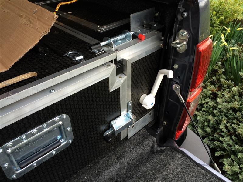

then fitted a tap to storage system and a shurflo water pump in the cubby behind it

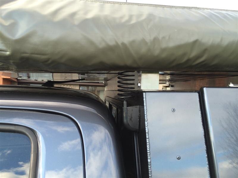

made a pass-through pipe between pickup cab and pickup tub, using grommets and a 20mm plastic pipe, to feed CB antenna cable, power for canopy accessories, and electric hookup cable

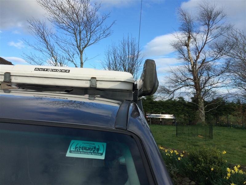

then fitted the CB antennae

Well Frogs Island couldnt find or source an ARB fitting kit for the bumper i got off them at bargain price, but said they would refund me some cash which is good of them.
Ben has been brilliant and helped me out, he got me a cost for the parts from ARB HQ in Melbourne,
but he also suggested we get hold of the fitting instructions and see what the fitting kit actually contains, since i could get some bits in UK - bolts etc
So Ben got hold of a PDF of the fitting kit instructions and sent it to me today - :dance:
and most of the kit is bolts, nuts and washers - no fancy brackets, and the instructions listed the spec and number of bolts etc, so i have ordered these in UK
the lifting eyes, used as recovery loops also easy to buy in UK
the only other thing was the swan-neck towbar hitch for the receiver hitch, but i can also get in UK or USA. and i fancy a drop-place one anyway
so all sorted - thanks so much Ben for the help :dance::icon-cool::happy-bouncyshadow::happy-bouncyshadow::banana-rainbow:

don't forget the rear tub flexes separate to the cab, so you don't want anything connecting the two, on the roof or the body unless it has enough flex, so for protecting cables etc running between the two flexi conduit or rubber hose might be best.
