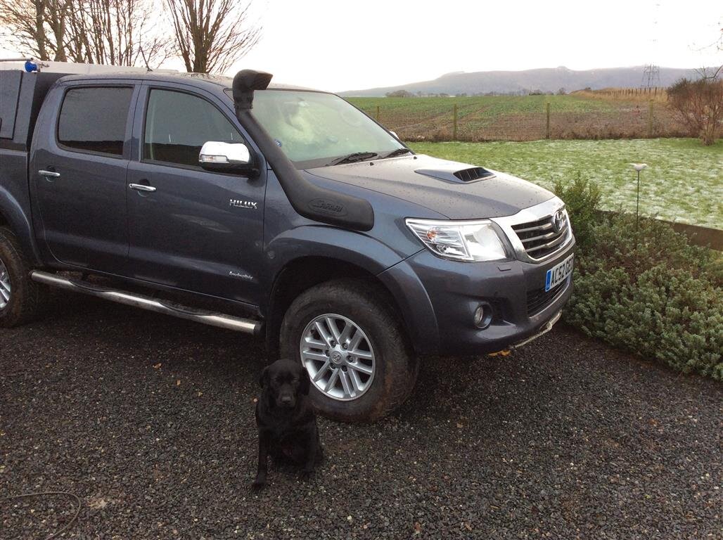

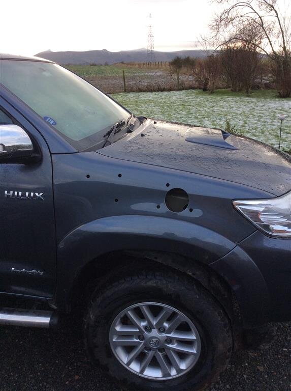

Got to work fitting the snorkel over the last couple days
using holesaw even more scary than when I fitted snorkel to Wugg, as Hilux is only 1 year old...
