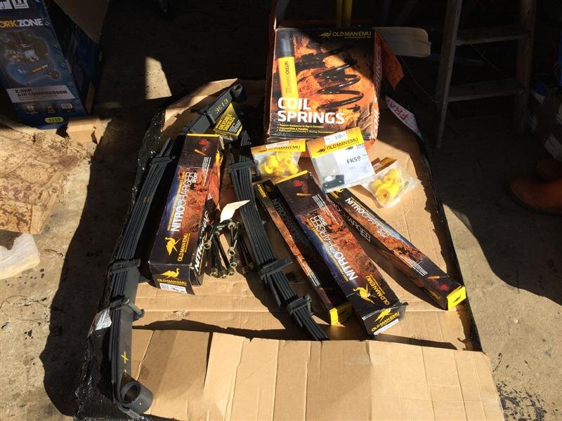

pallet load of new toys delivered today...
.... wonder what I will be doing this weekend
:whistle:

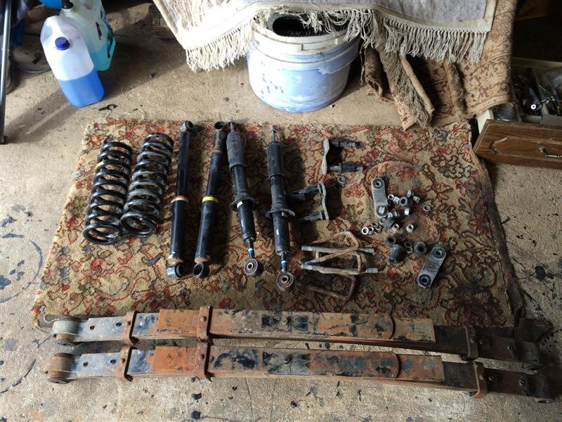

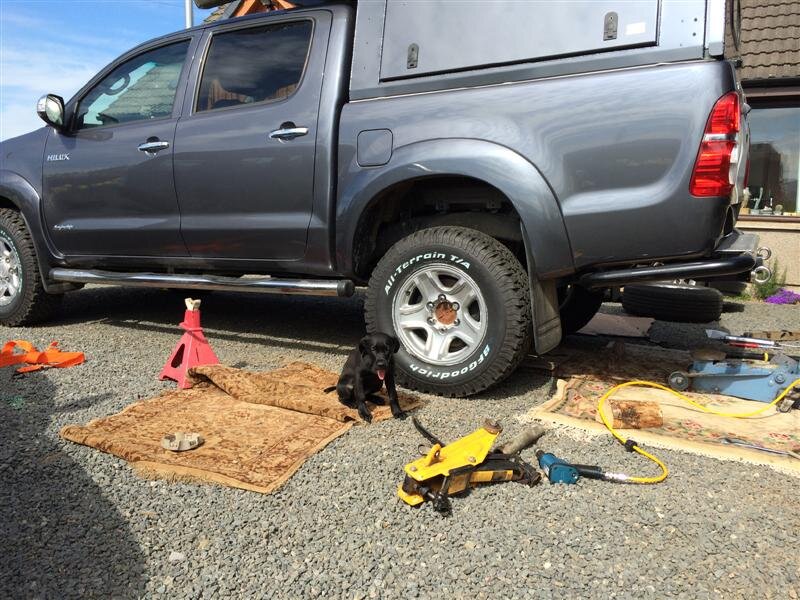

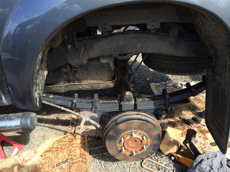

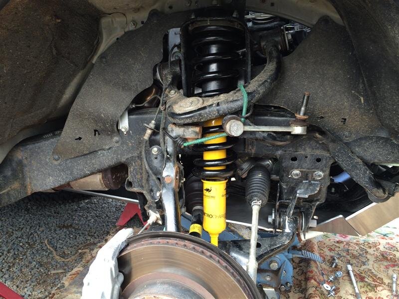

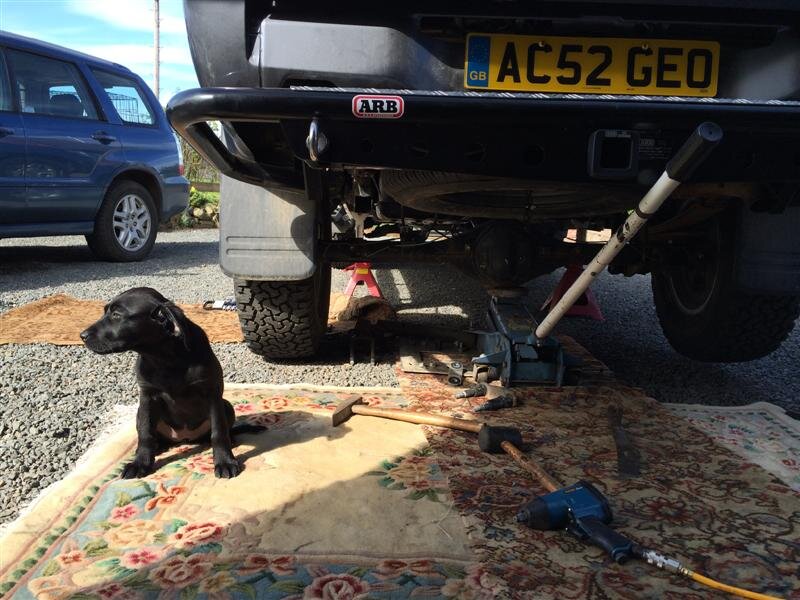

Nice weather for a suspension upgrade
pretty straightforward, with all nuts and bolts nice and easy to remove
vehicle has much better stance now
driver side sitting a couple cm higher at back..
couldn't see any "A" & "B" labelling on the leaf springs... as i have seen on some OME coils in past.
will probably fit some trim packers on passenger side rather than swapping the leafs around
fuel tank is on passenger side...

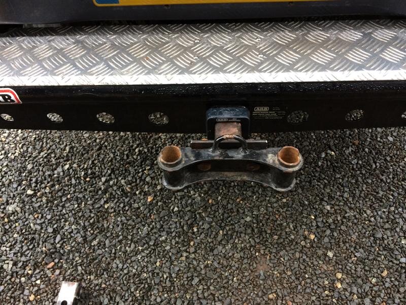

Today I made an adaptor to allow me to mount bike carrier on receiver hitch
simple to make - but a length of 50mm box steel and welded a 6mm thick plate on end to form a "T-piece"
then drilled holes for my pendle bike carrier mount and hole for locking pin

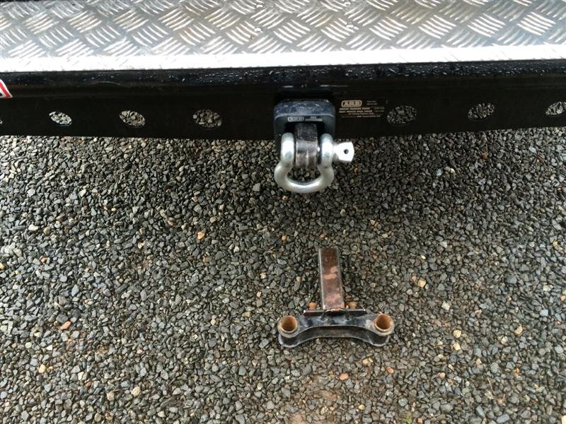

also fitted recovery point into the hitch,

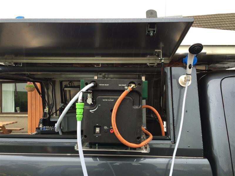

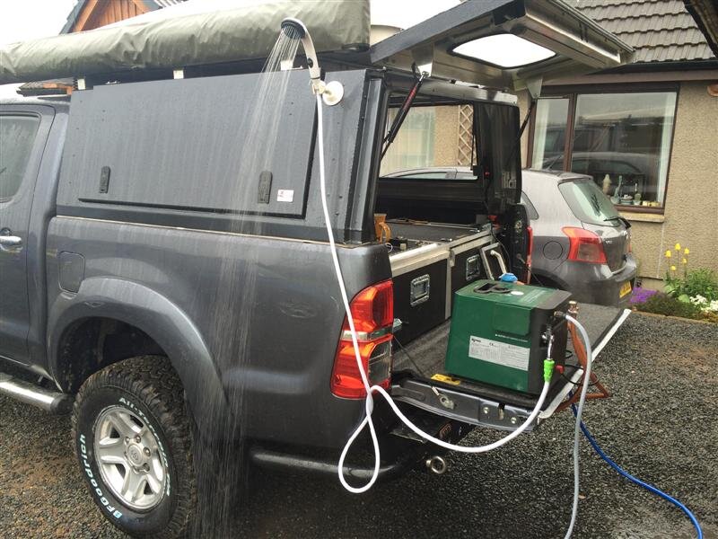

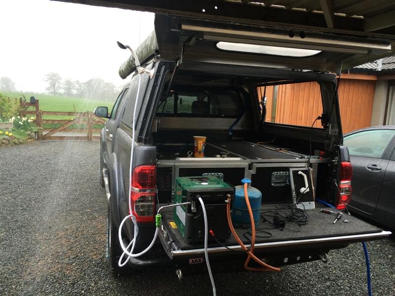

and then tested kampa geyser shower system with my shurflo pump - works fine
just need to get a shut-off valve for the water pipe before installing it all in canopy
Used my shower at the weekend. Just filled a bucket from the burn and stuck the pick up in. Bloomin lovely. Had a right good fettle. Plenty hot enough. I hope that my new heat exchanger system is as good.

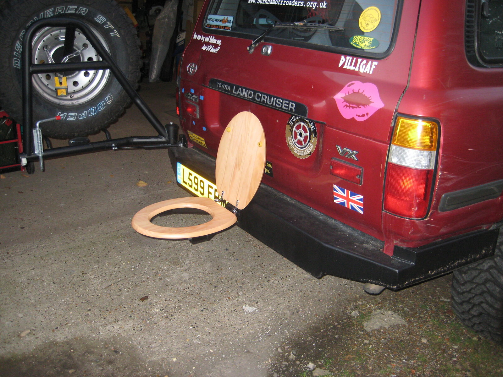

Ahh the old 'bumper dumper'
Poo with a view.

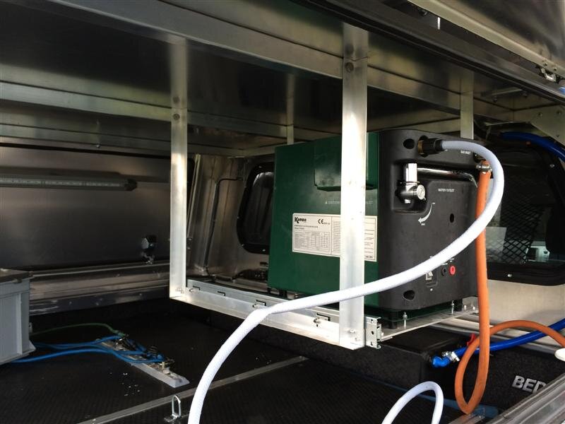

Made a frame and runners for my hot water system unit, this is now plumbed into the pump system via a T-piece splitter so my tap and water heater/shower run off same pump

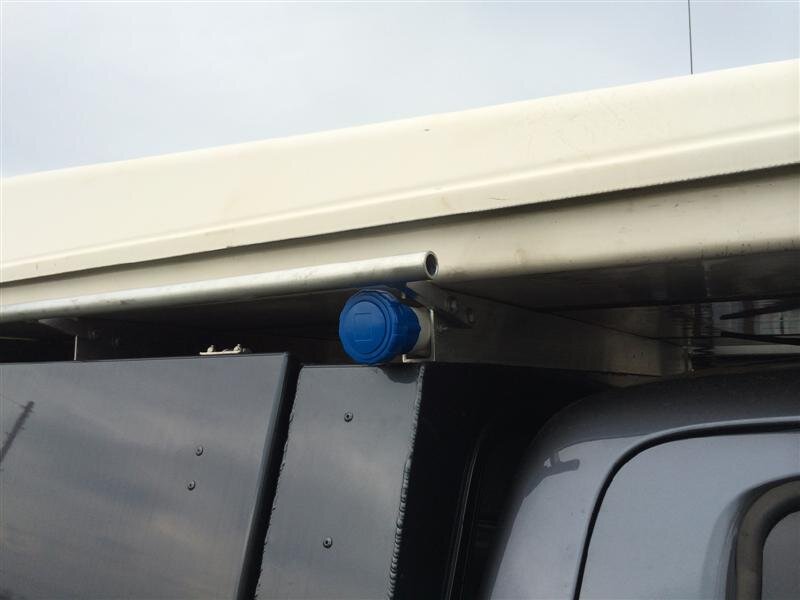

Added a socket for electrical hookup to feed into my 3-way distribution board in back cab and run my CTEK charger

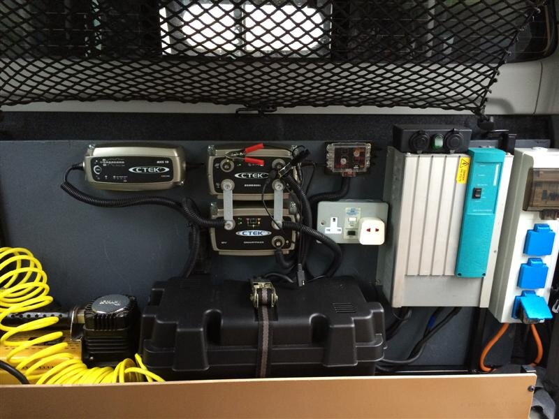

Added a smartpass to the charging system
drove 80 miles at the weekend in the Hilux and the voltage on leisure battery is higher than it has ever been before 2 days later about 12.9 volts. With the previous relay system it was usually about 12.5v,

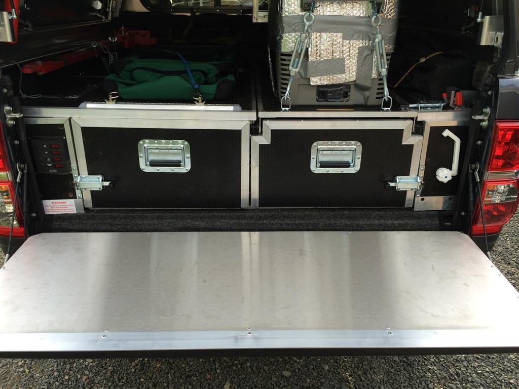

made a tray with quickfist clamps, this is to transport our mountain bikes. remove wheels and saddles, flip bikes upside down, and the handlebars go into quickfist clamps and a strap holds the other end the the bike. fits 2 mountain bikes, facing different ways side-by-side

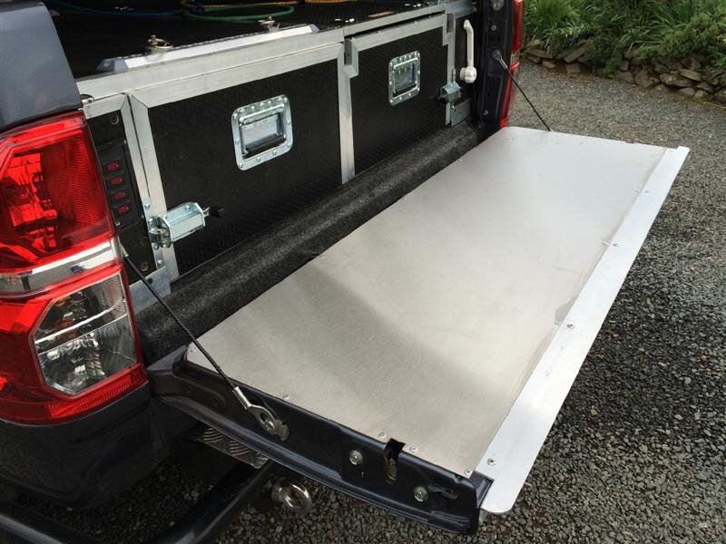

and got myself a sheet of stainless steel and fitted to the tailgate, after cutting off this part of the bedrug.

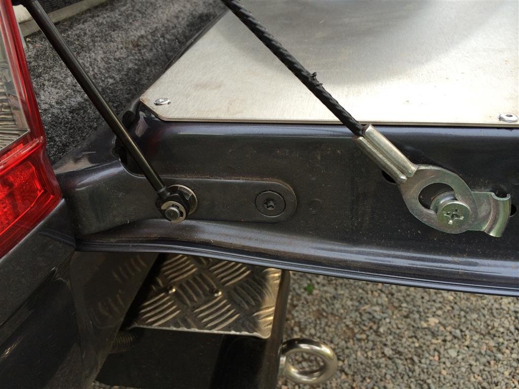

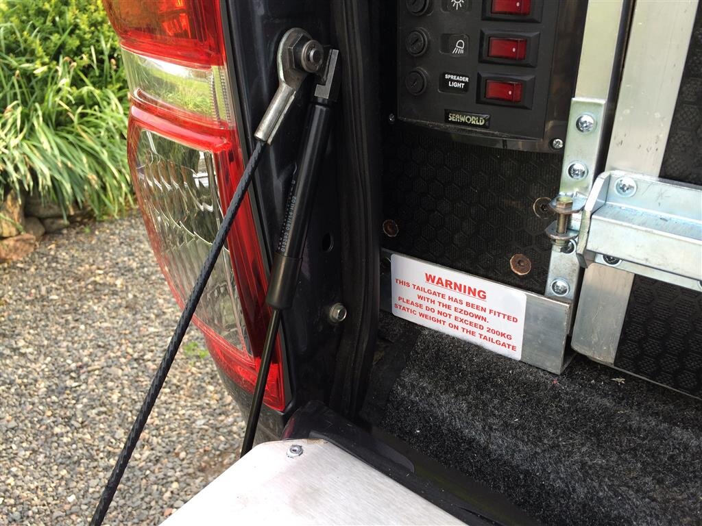

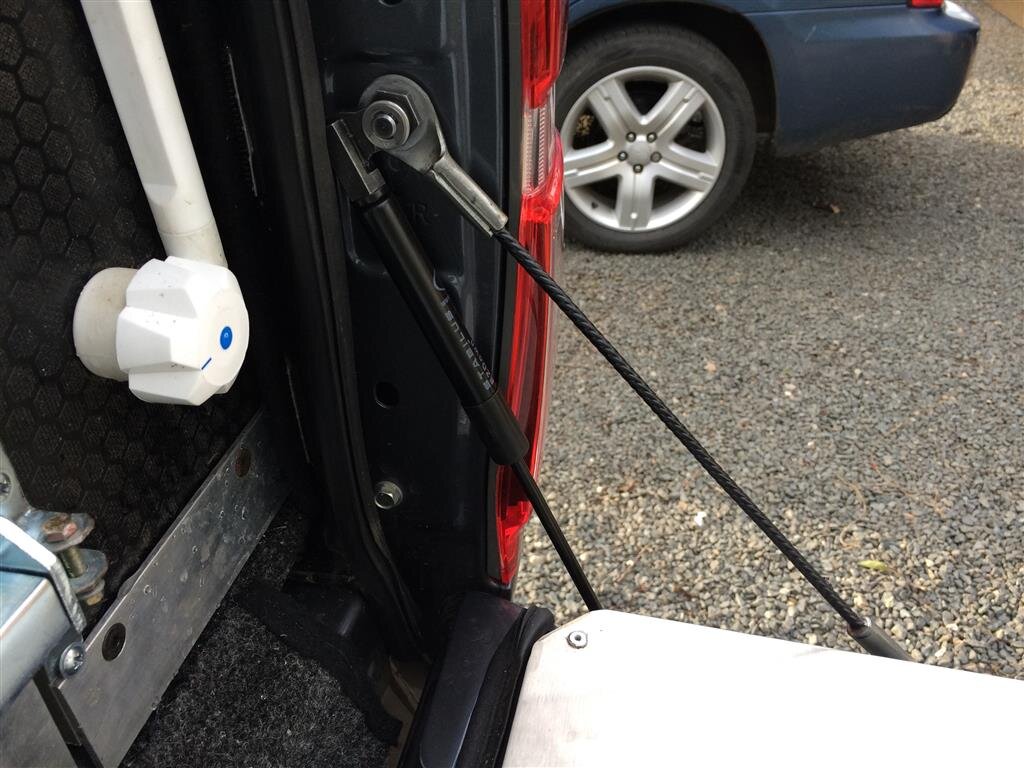

Fitted a pair of EZDown dampers to the tailgate, these really help with lowering it, especially with extra weight ofthe stainless steel deck. you unlatch the tailgate and let go of it and it lowers on the dampers
close-up of a damper, the retaining strap remains in place too

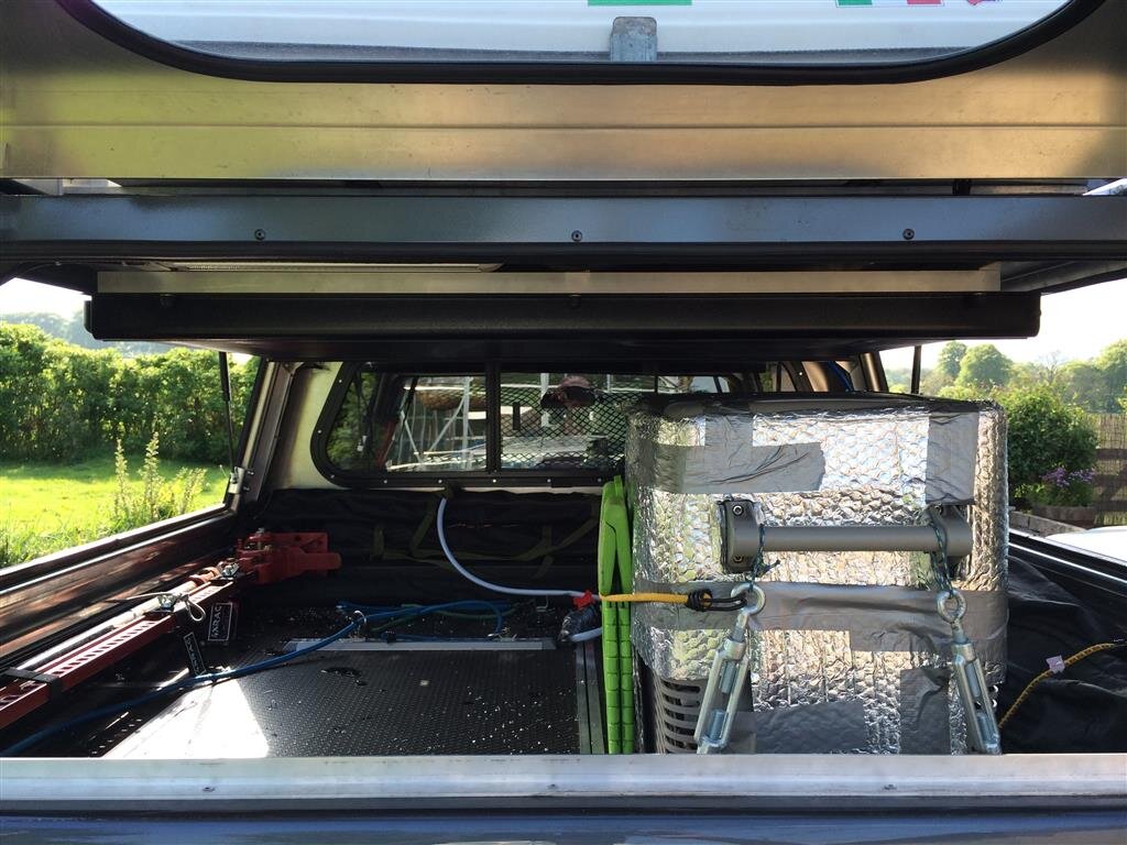

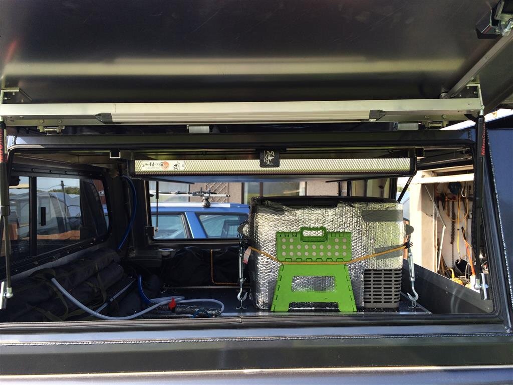

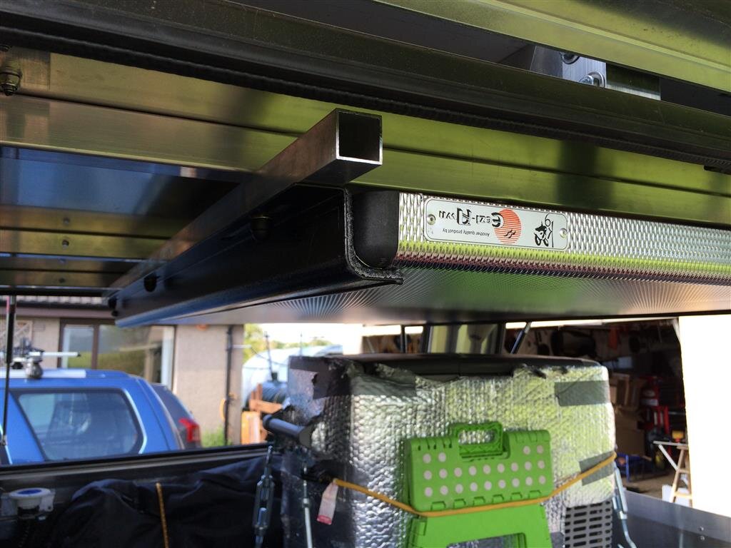

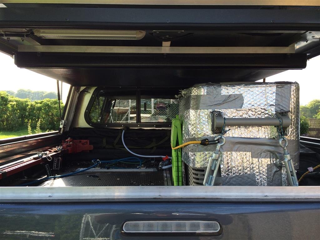

I also got an Eezi awn K9 table, this takes up most of space in roof of canopy, so i scrapped my hotwater unit runner system. the kampa geyser will have to be lifted out when needed now
table sits on eezi awn roofrack holders
close up of the mount for the table, it slides out of one of side hatches on the canopy
