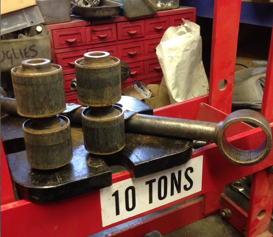

Also got the upper control arms done at last. I was feeling some shunt when changing gear and looking at the bushes and arms they did look stuffed. I took my spare set, cleaned them up with angle grinder and wire knotty brush and applied several coats of that silver cold galv stuff after pushing the old bushes out. Jeez that made me jump and bent the press slightly too at 10 tonnes.

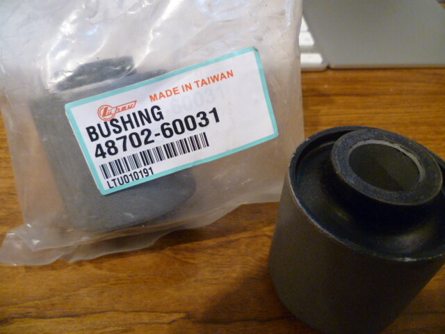

I looked at options for bushes. Milner, Pro thingy, OEM and Pedders don't do a natural rubber one yet.. Well from Toyota these bushes are £50 each. From our very friendly and useful internal source they were significant cheaper but I'd have to wait a bit. After a search I came across these. Looking a little dubious, I did contact the seller who replied very quickly each time I asked a question. So I bought them. This is a set up rear upper AND lower control arm bushes. as a set. They don't just do the uppers on their own.
http://www.ebay.co.uk/itm/230885729955?_trksid=p2055119.m1438.l2649&ssPageName=STRK:MEBIDX:IT
They are NOT in Fife, they are in Taiwan. So what was the result? Firstly they came in 4 days. Yes, 4. Four, Quattro. Now that's fast. No import duty or anything. Well packaged and they measured up perfectly. They also fitted a treat, need only moderate pressure on the press to push them in.
As I mentioned on the maintenance today thread, they have transformed the feel of the truck when changing gear. Gone is the sort of thud when I let up the clutch and now I just have a normal gentle take up as I pull away. How long will they last? Well I dont know but I wiggled them in the vice with a large bar and they responded well. No cracks, tears or anything, just good bonding on the steel inner and out with the sort of resistance you'd expect. As long as they outlast a set of Miner ones, I'll be happy! A tenner each, that'll do for me.
