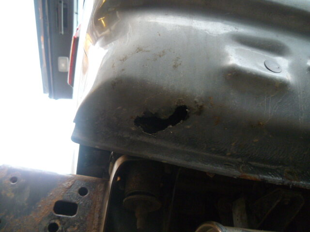

OK OK, I know that you have all been gagging for news, unable to sleep, suffering hair loss, no appetite, reduced libido, but I can only work on the Ghost at weekends you see. But I have to start with some grave news. A sombre moment if you will. Here
Whilst working around the back end I noticed a couple of bubbles which I poked with the end of my spanner. Like picking a scab, a few minutes later I had a hole. Right through. I have cut a small section out and it's all good metal at the outer skin. I got showered in massive pieces of rust in the process which I think are part of the inner wing. It's old stuff I think and dry. So a clean out and some rust killer in there and we should be good to go. Dead easy section to repair so we'll be fine.

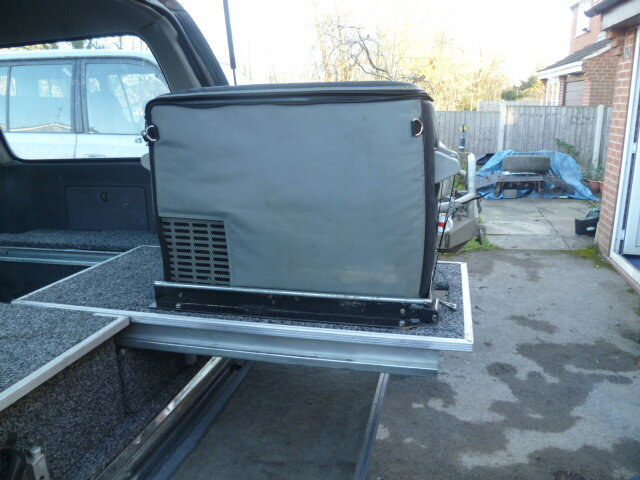

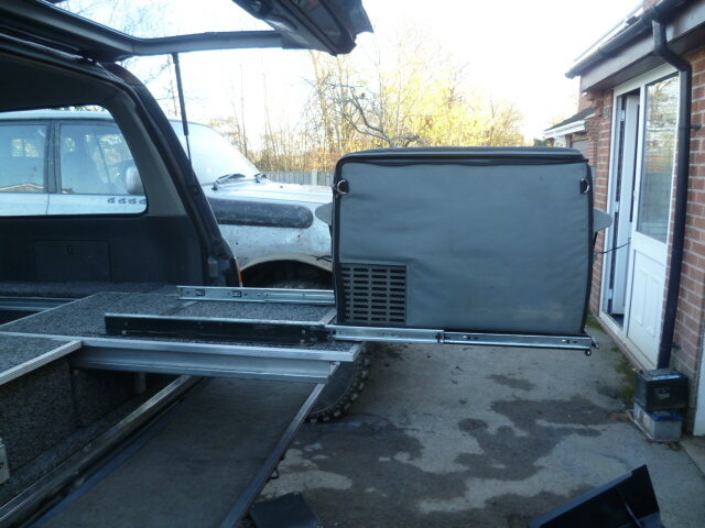

OK moving on. A really busy day that didn't take me very much further forward really but an important day nonetheless. I finished fitting the drawers - actually 'tuned' them up a bit and they are really good now. Got a new plastic inside panel courtesy of Karl. Got the fridge in and my slider.
Oooh, that's what I call an extension.

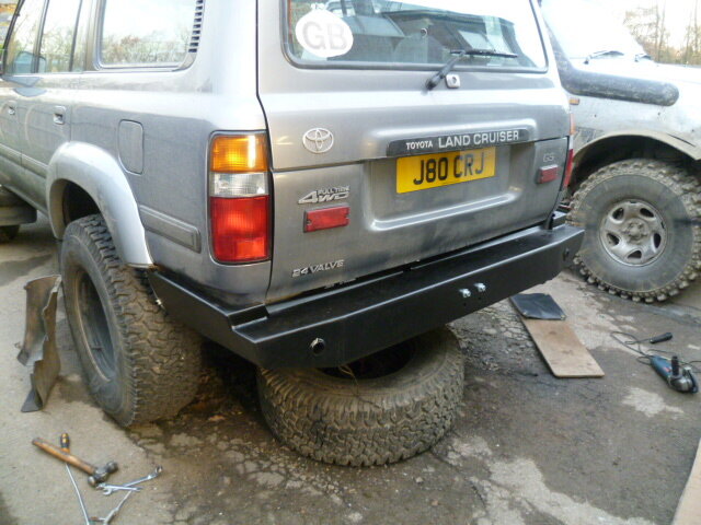

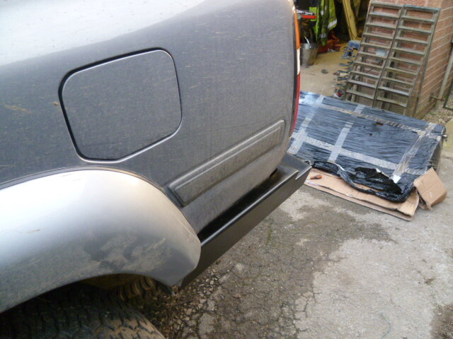

Now the bumper. Very pleased with that but I had to do quite a bit of work to the chassis before I could fit it. Almost all of the captive nuts were toast when I came to remove the tow bar. The bumper uses the same mounting points and of course once the bumper is on, you can't get into the chassis rail so everything has to be inside already. This involved making plates with captive nuts on and control rods to be able to push the plates deep into the chassis. They all went perfectly. That's my story and I am sticking to it.
Here's some sexy shots.
It's a nice thing but there is a good morning's worth of 'shugling' to get it square. Not sure where it's out but some big spanners and 12 mm bolts will settle that down for sure. I will be adding the wheel carrier, 2" receiver, tow electrics and not much else other than the mud flaps back on. Yes I know it doesn't look much for a day's toil, but trust me I have earned this glass of sherry.
